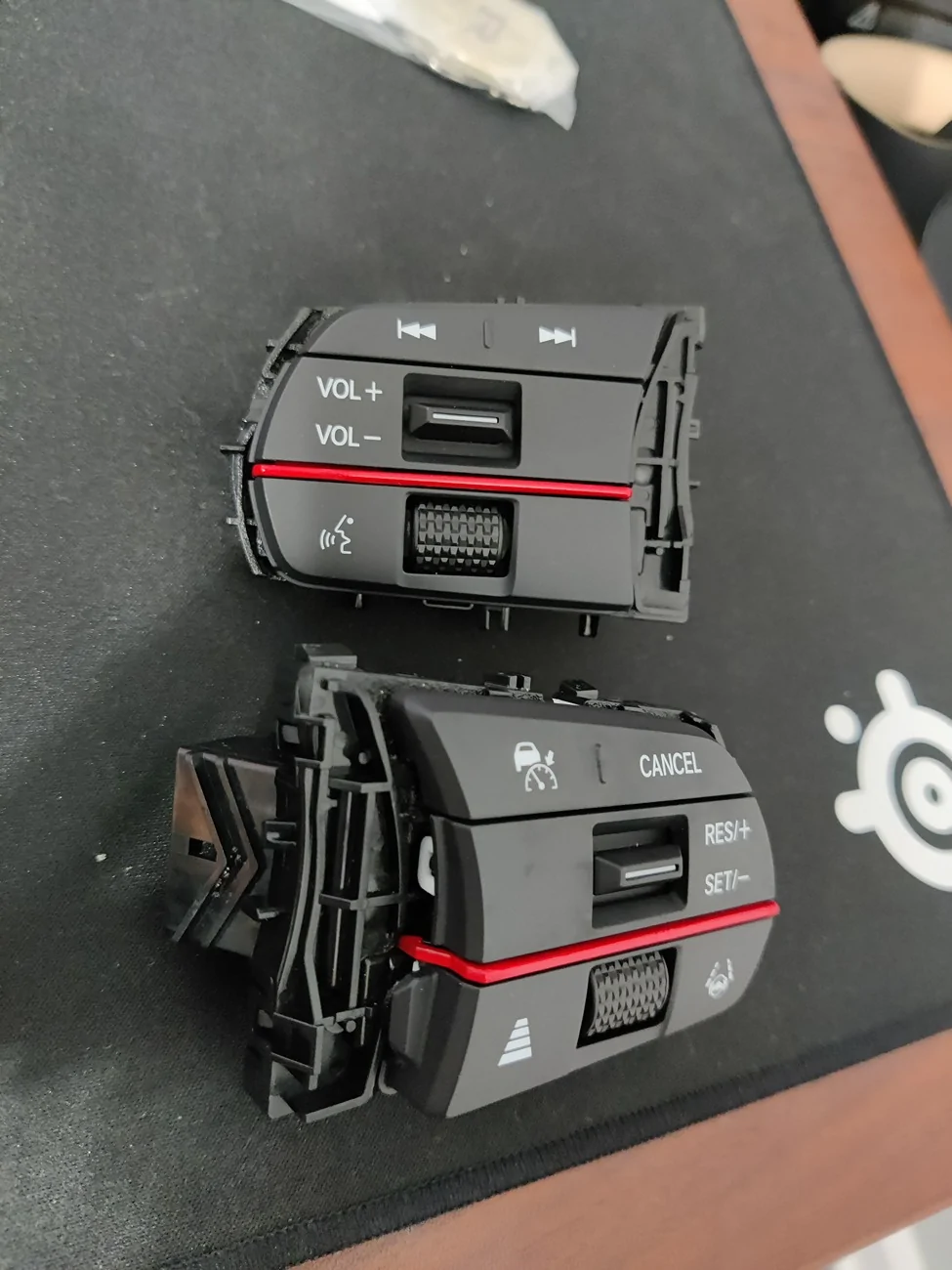

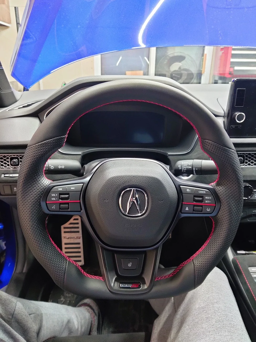

My quest to remove as much chrome as I can from the interior continues. Painted the chrome pieces in the steering wheel controls. Super easy to do and I recommend it to anyone who doesn't mind a little bit of detail work.

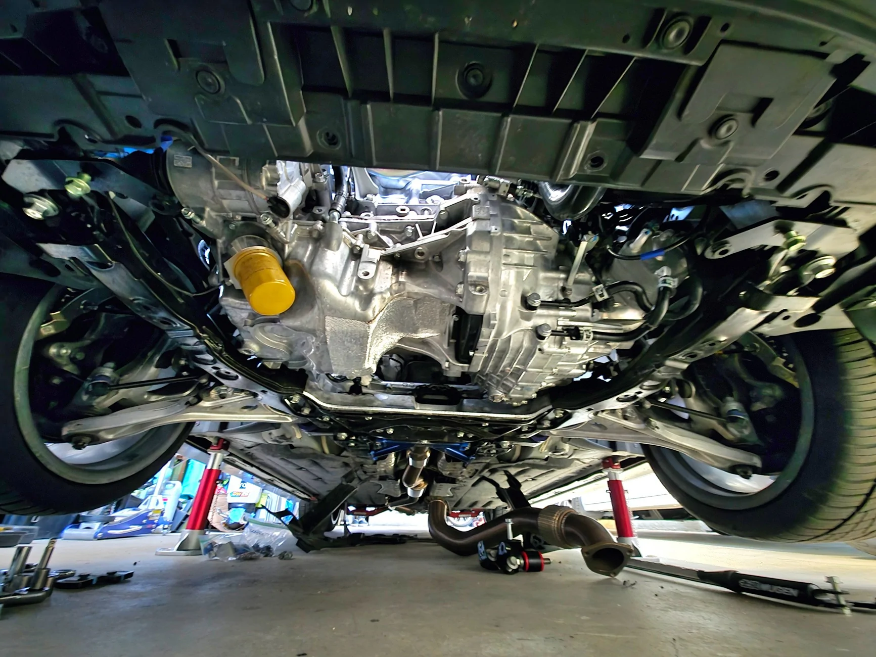

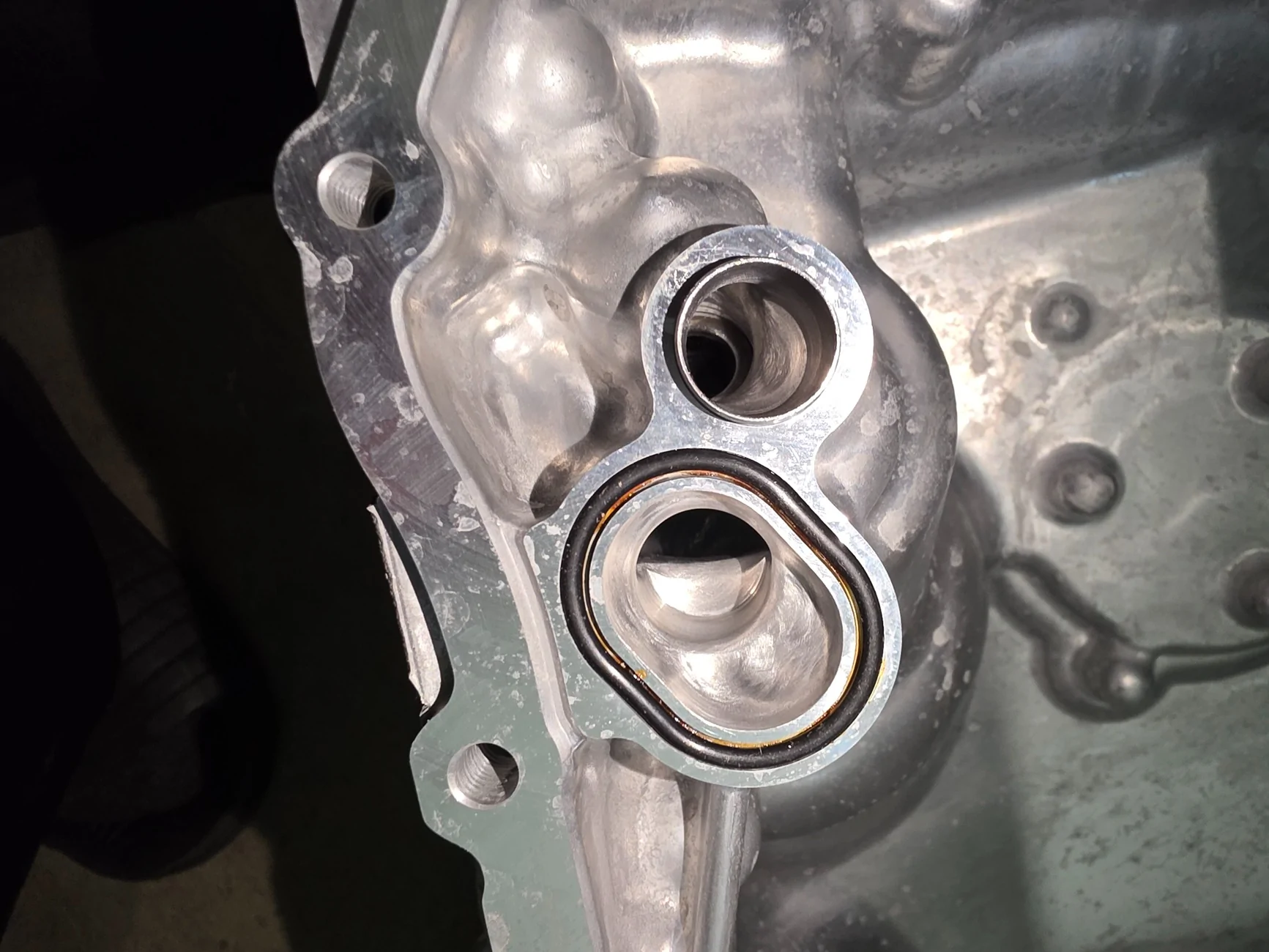

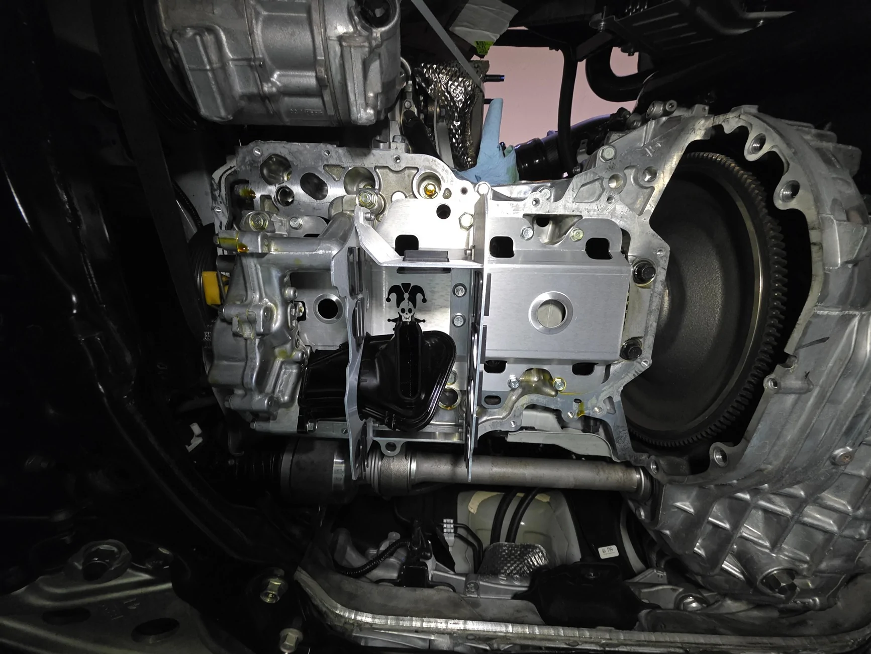

Installed the Wunderladen oil pan baffle this past week and a ported oil pan. Quite a few steps involved just to remove the pan, much like when working on anything else with this engine. Great peace of mind oiling mods for my 2026 track ambitions.

Looks great! What paint did you use for this? Assuming you just taped off the buttons and painted carefully?

Mechanical failure avoidance is understandable, but has anyone truly locked up an engine on the track due to oil starvation on these cars? Have you noticed a drop in oil pressure on track?

I doubt anyone will ever lock up this engine from not having a baffle, but the high G turn oil pressure drops on track are likely contributing to accelerated wear under high engine load over time, either way there's no negative from adding the baffle. Yes, I am seeing oil pressure drops on track, moreso when I switched to Toyo RRs on track.

Baffled pan is definitely cheap insurance

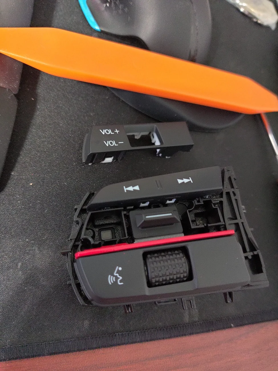

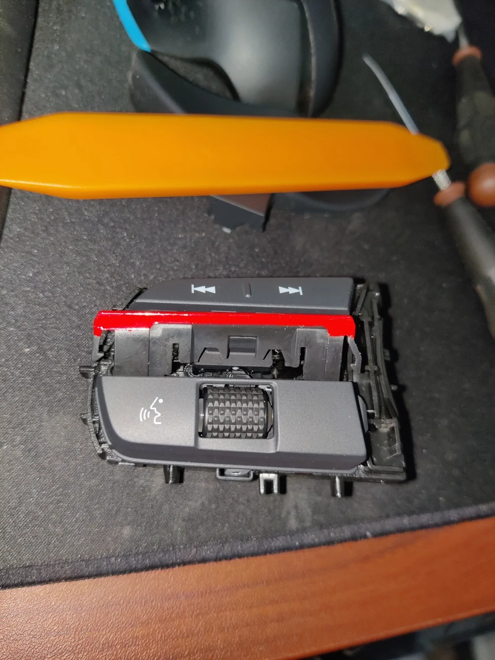

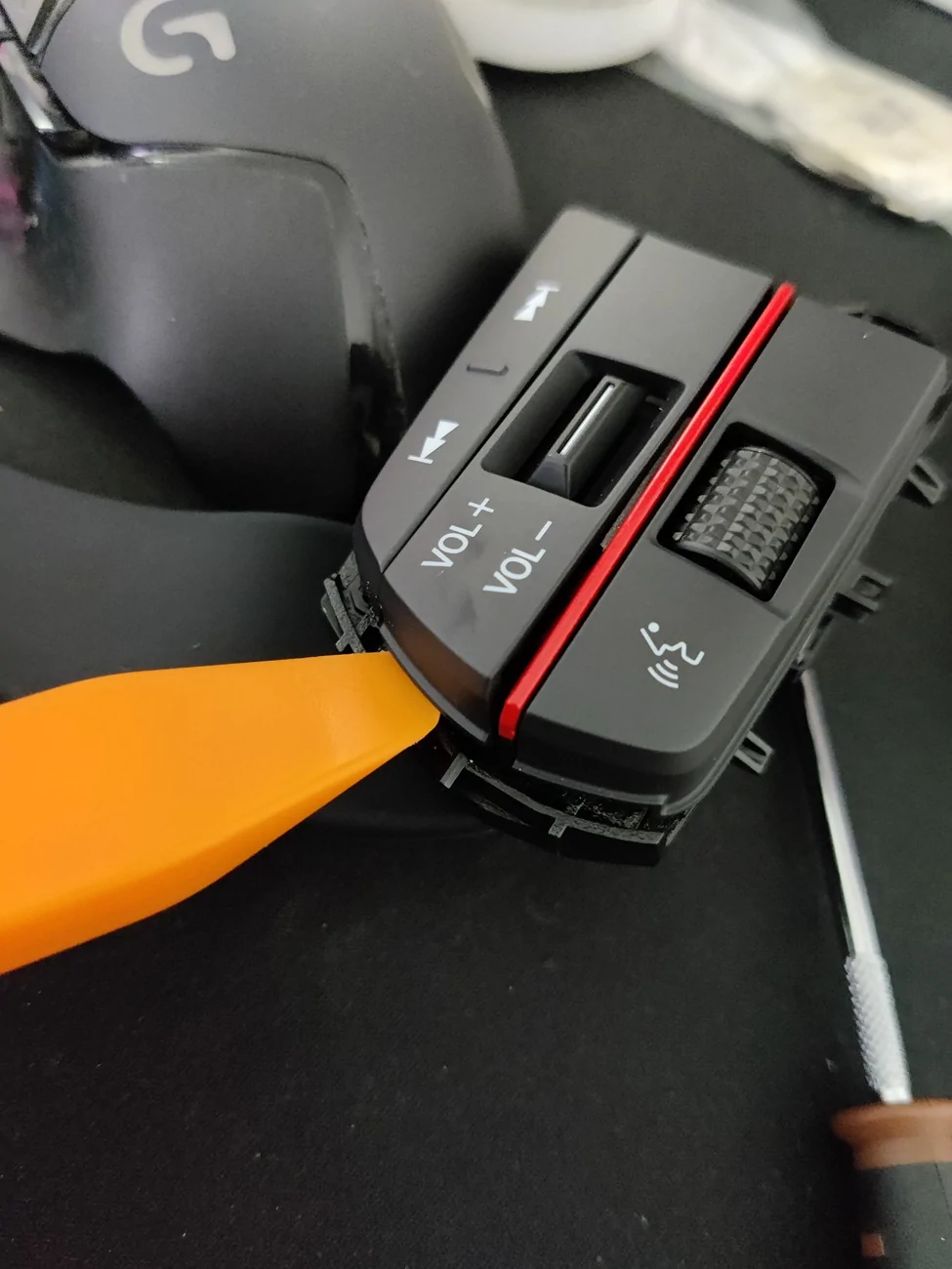

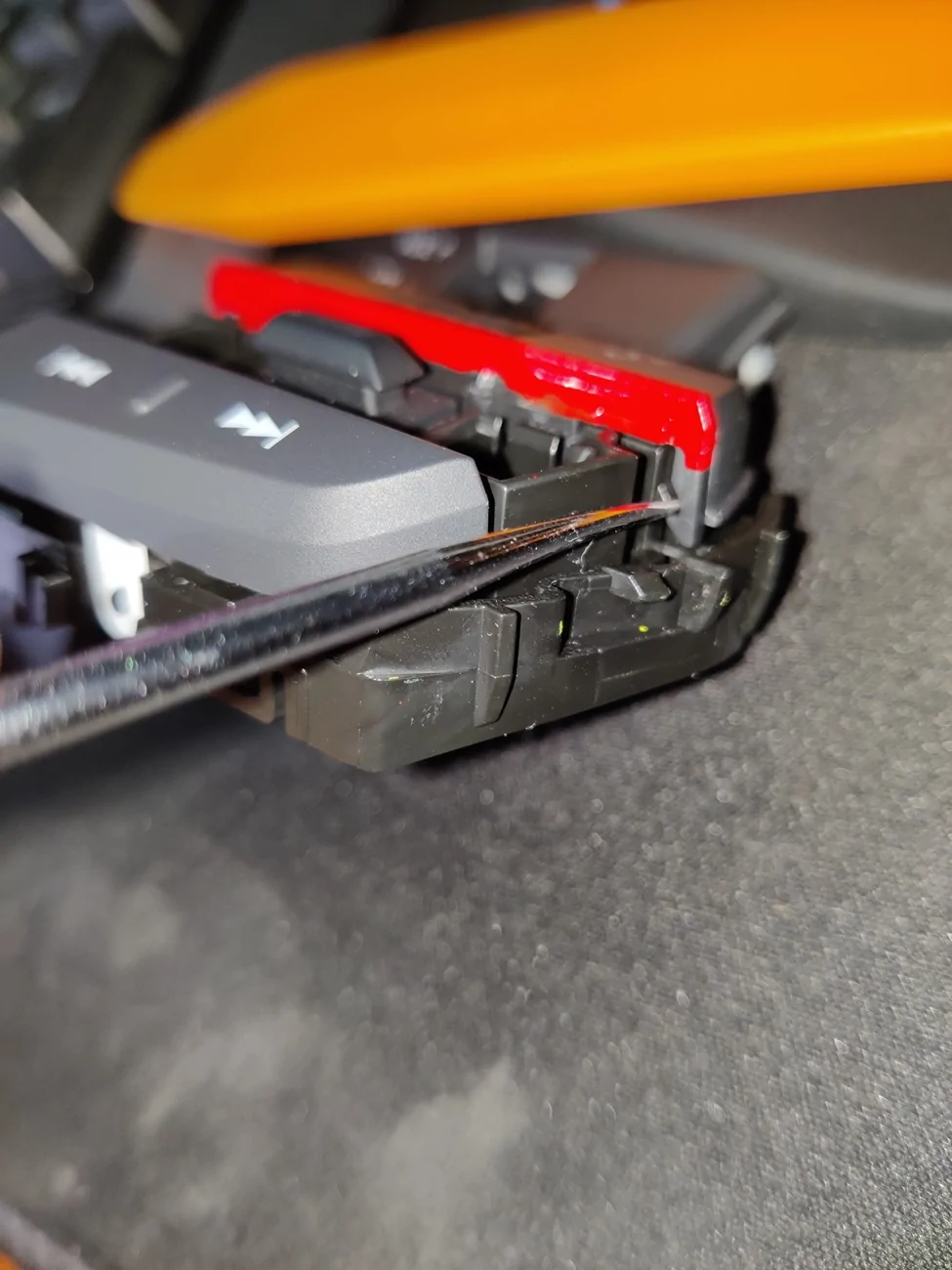

Thanks!
I used a Testors enamel paint marker in gloss red. I took apart the switch which is really easy to do.
Once you get the switch apart, pop the middle cover of with a flat edged pry tool and a pick tool. That exposes the chrome piece which you then unhook it from the sides to release it, using the pick tool. Paint the top and sides then reinstall.

Dude that is insane! Gjob!

Thank you, it was a surprisingly easy job, I recommend everyone jump on board!
The HVAC pieces were a little more involved. I don't even want to talk about the vent surrounds...
