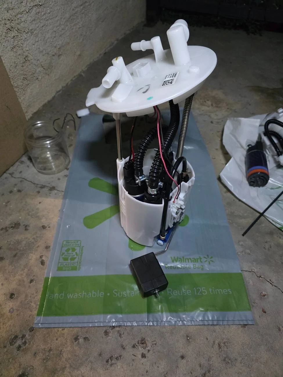

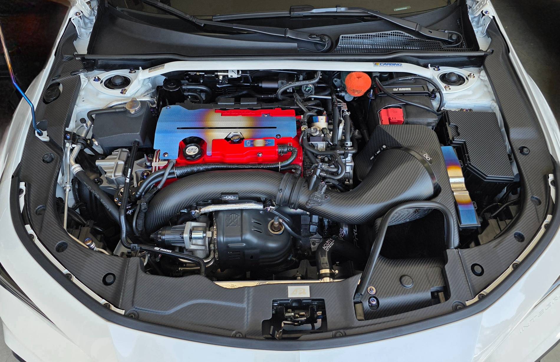

Update to #263:
Vehicle: 2024 Integra Type S
Total tuned time: 13 months
Tuned miles driven: 7,000
Tuning device(s) used: Hondata Flashpro
Tunes used: Phearable DE5 Stage 2, JesterTuned Custom Tune
Fuel used: E60 mix exclusively
Additional related mods: PRL Intercooler and Charge Pipes, Wunderladen RMM, Hardrace Side Engine Mounts, Mishimoto Expansion Tank, Acuity Reverse Flow Hoses, and Wunderladen PCV Oil Catch Can, & Radium CCV Oil Catch Can. JSR race ported Intake Manifold, SoCal Porting ported Throttle Body and Turbo Outlet Pipe. Full-Race HPFP, Hondata CANFlex, Radium 6 micron in-line Fuel Filter and pressure gauge, PTFE AN6 fuel lines, and Hondata 1530cc Injectors. Kuro+ Turbo, PTP Hybrid Turbo Blanket, TSP Downpipe, WOT Cooling Panel, and CSF Radiator. Recently swapped out: Deatchswerks DW430 LPFP with FK8TD LPFP High Flow Basket assembly, Infinity Design Intake and Turbo Inlet Pipe.
Problems/issues: None mechanically whatsoever, just a few interior rattles/buzzes like everyone else has noted on this forum.
Driving style: Mostly conservatively but let her rip from time to time. Tracked recently at Street of Willow/Willowsprings, going to Buttonwillow next month and got several more track days scheduled for the fall. Making use of this platform and mods at the track like they should.
Tuning experience notes: perfect conservative custom tune by JesterTuned. Making right at 500whp on a dynojet with plenty of head room. Been running strictly E60 100% of the time. Swapped LPFP and basket components with the FK8TD basket assembly to avoid any issues with the OE filter degradation from the constant ethanol use.
