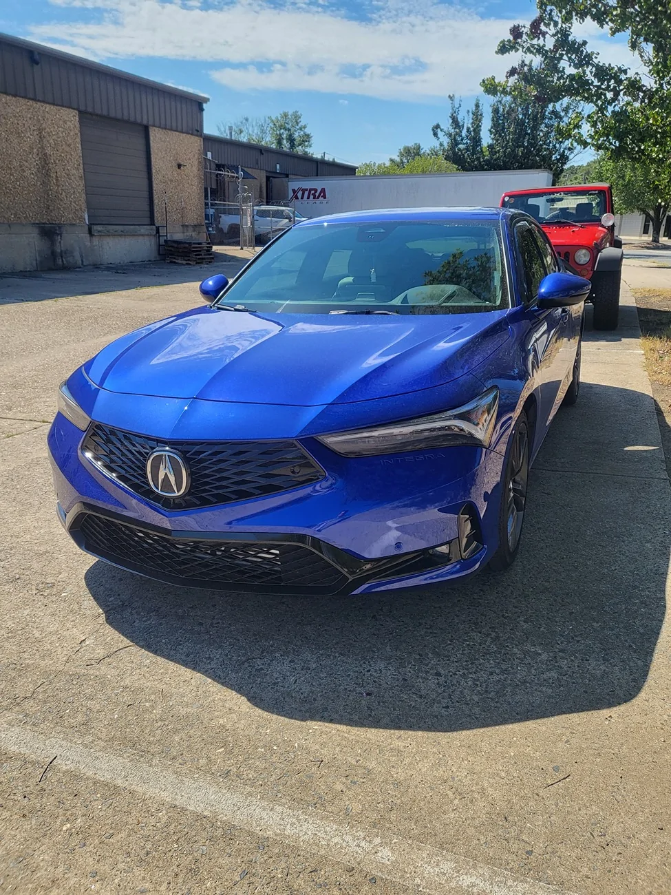

Vehicle: 2025 Acura Integra A-Spec w/technology (CVT)
Total tuned time: 1 days
Tuned miles driven: 10 miles
Tuning device(s) used: KTuner V2
Tunes used: Phearable Stage 1.5 R
Fuel used: 93 octane
Additional related mods:
PRL: High Volume Intake w/ CAI, Titanium Turbo Inlet, Intercooler, Charge Pipes, Front Pipe, RMM, N1 Exhaust
RV6: GESi G-Sport Catted Downpipe
Acuity: Reverse Flow Radiator Hoses
Mishimoto: Oil Catch
Handling: PRL Front & Rear Throwback Struts, RV6 Rear Sway
Problems/issues: So far so good
Driving style: Mostly to and from work which is only 7 miles each way... spirited when possible, but patient. Lots of curvy two lane highways around here which are incredibly fun.
Tuning experience notes:
It was raining today so I have no real feedback so far. I was pretty nervous as it erased the ecu then flashed the new one... but it didn't even have a CEL once done. I was bummed that my ECU # only supports 1 map (so I've only got map 3), but so far that seems alright. The engine felt smoother in the rainy 30-45mph traffic.
Note:
Boy was I cackling when I pumped the gas after it was done and it revved to 4200 rpm 😂
I'll put on some miles & try to have some fun with it over the next few weeks and report back. Hope to get the brake upgrades installed by then too.

fire build! im curious to see how the CVT will hold up.
