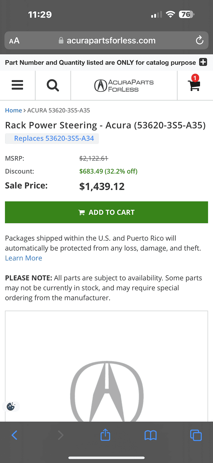

Since I’ve been dealing with this for over 1k miles, I’m looking to tackle this issue once and for all.
I called 3 of my nearby dealers. Two said same part numbers are being used. One said new part number is out.
I did some of my own research. When you google 53620-3S5-A34 (which is what TrackRider54 got installed), a new part number pops up… 53620-3S5-A35. It also states that it replaced the A34 part. Is this what we’ve all been waiting for?

Made a call to the parts dept, and they say that the one ending in A24 is actually for the manual transmission Integra…which is what I have. There’s no new part number associated with those.

That is correct. Mine is a CVT.

Thanks Chad. I just confirmed that to also be the case. A24 is for manuals and A34 is for CVT.
When I now googled 53620-3S5-A24, it shows that A25 has replaced it. I called another dealer, and they confirmed the A25 is the new part number for the 6MTs.
Gonna go out to my dealer to get approved for one so that I can get in line for a replacement.

I struggle to make sense of the part numbers. My ‘23 6MT (December ‘23 build date) with sticky steering is fitted with an original rack that’s labeled 53600-3S5-A35-M1. (Emphasis added.)
