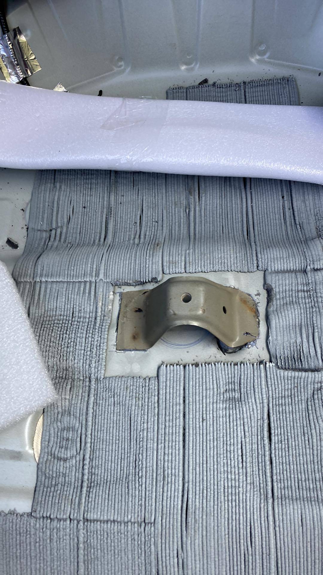

Added a picture of what I will use to secure the spare in the trunk. Will weld the bracket to the trunk pan and be done with it.
Replying to myself just to update...
Was going to weld the thingy in the picture above in the trunk, but thought about what would happen if the trunk gets hot by the welding process... paint would lift. Not that much of a problem in the trunk as it is not exposed to the elements, and would be easy to just prime white (my ITS is white). But it's another story for under the car. So decided not to do it that way.
Instead, I went to a body shop to ask some suggestions. They say they have super strong glue that is used nowadays on the frame of most cars. So I'm going back next Friday to have it glued in the trunk. Must sand to bare metal before doing so, but It'll be easy to just prime it white afterwards.
Will post pics when done.

Yeah, I removed everything... Will look like this:
