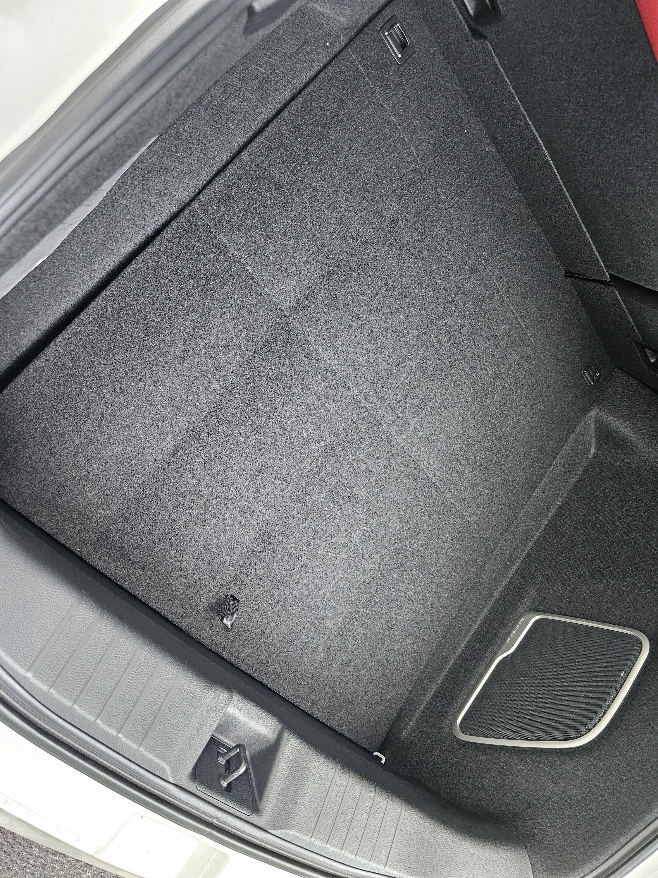

I have a type s and just checked. There is no threaded receiver and the area is raised to not even fit a spare. Spare tire kit is going back. You would lose storage space and the floor would be uneven.
Can you tell me if there is enough place to put a spare in the trunk where the spare should be? I know it will make the trunk tray sits higher, but in term of circumference, is there enough room? (circumference of the spare would be the same of a regular wheel)
Because if it is just the threaded receiver, it would be fairly easy to make one and weld it in the bottom of the trunk...
There is no way I'm driving the ITS without a spare, especially with the thin tires; you can easily thrash a wheel/tire in a pot hole (and we have tons of them here). Probably not easy to find a new tire + wheel away from an Acura dealer...

Not really. The wheel well is raised with thicker sound dampening/rigidity material and is only like 4” deep. If you stuck a spare there your floor would not be even at all. You would be better off sticking the spare on top of the mat and that would cut down on your other storage space. They truly designed this car to not accommodate a spare. I think you would be better off keeping a tire inflator there to at least get enough air to get to a discount tire. Obviously if you had a bad blowout you would need a tow instead.

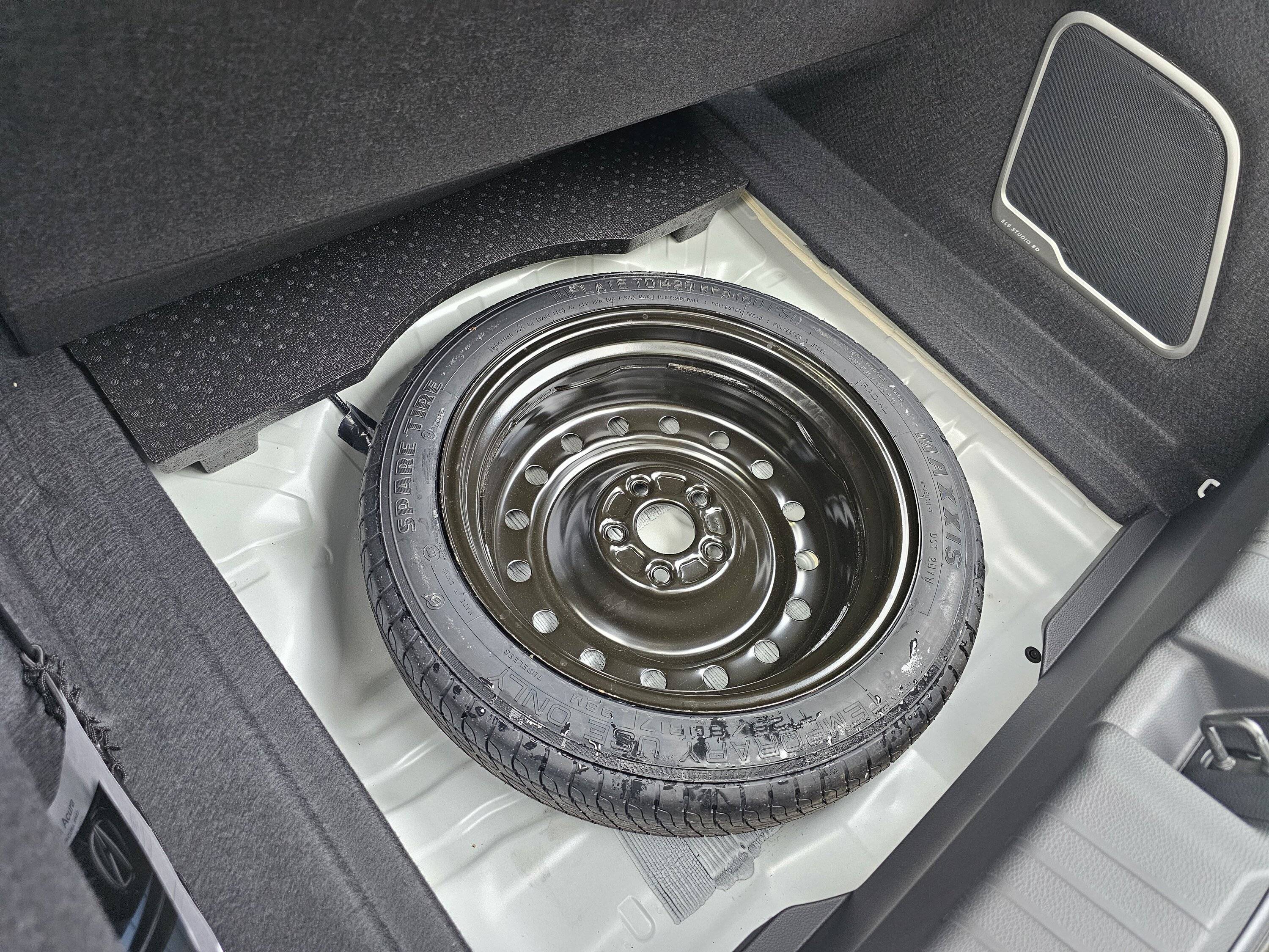

Man it sure fills the trunk up but I should be able to get groceries around it.

So it has both bolt circles, that makes sense.

So I just did a test for giggles and I don't think we have as bad with the ITS as the Type R folks. I put a spare tire from my 22 Civic SI on the well and it almost clears. Now I just need to find a spare with the right bolt pattern.

A tire that clears the calipers (at least the rears) will probably be thicker. I will be able to test next week as I'll get my car. I already bought a used RL spare tire so I'll try.

Very interested in your progress. Can you advise what tire size came in the kit, ie 185 x19. Also do you know the rim width included in kit. I'm thinking that maybe getting the rim and possibly installing a narrower tire width to allow it to better fit into well. I'm planning to get some firm foam sheets and cut to adjust height to create a taller but flat floor.
I don't use the truck much, so the loss of an inch or 2 in height is no big deal.
Thks.

I really don't think the well diameter will be the bottlenecking issue. Height is the real problem.

I know the dia is ok, but if I can get a smaller tread width, when it is flat in well it wouldn't be as tall.
Could you check tire width from kit?
