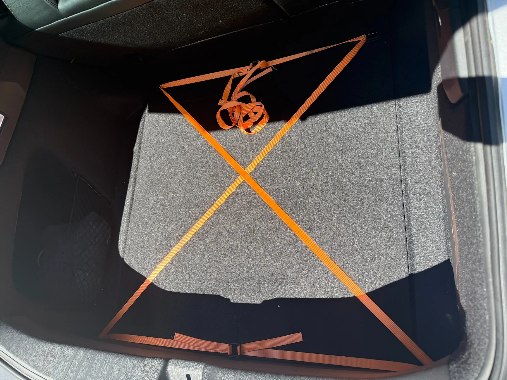

IIRC, it worked ok, but wasn't a perfect fit under the rear floor.
636
399
The FL5 kit won't either...
