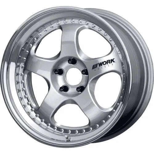

Same here, saving up for set of Works. 19x10 +50-54.

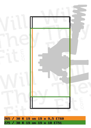

19x10 +51:
19x10 +53:
"Compared to your existing wheel, this new wheel will have an inner rim which is 2.6mm further away from the suspension strut. The outer rim will poke out 15.4mm more than before."
