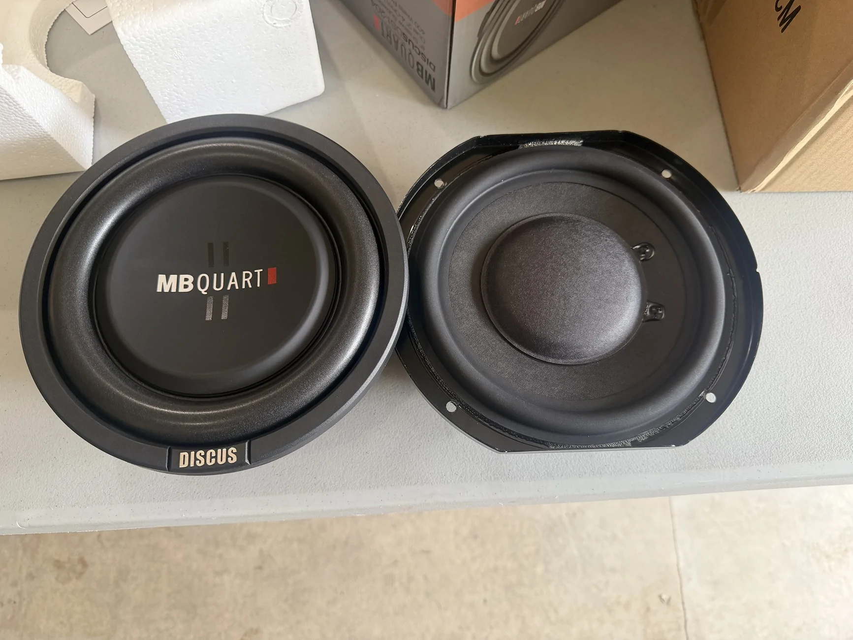

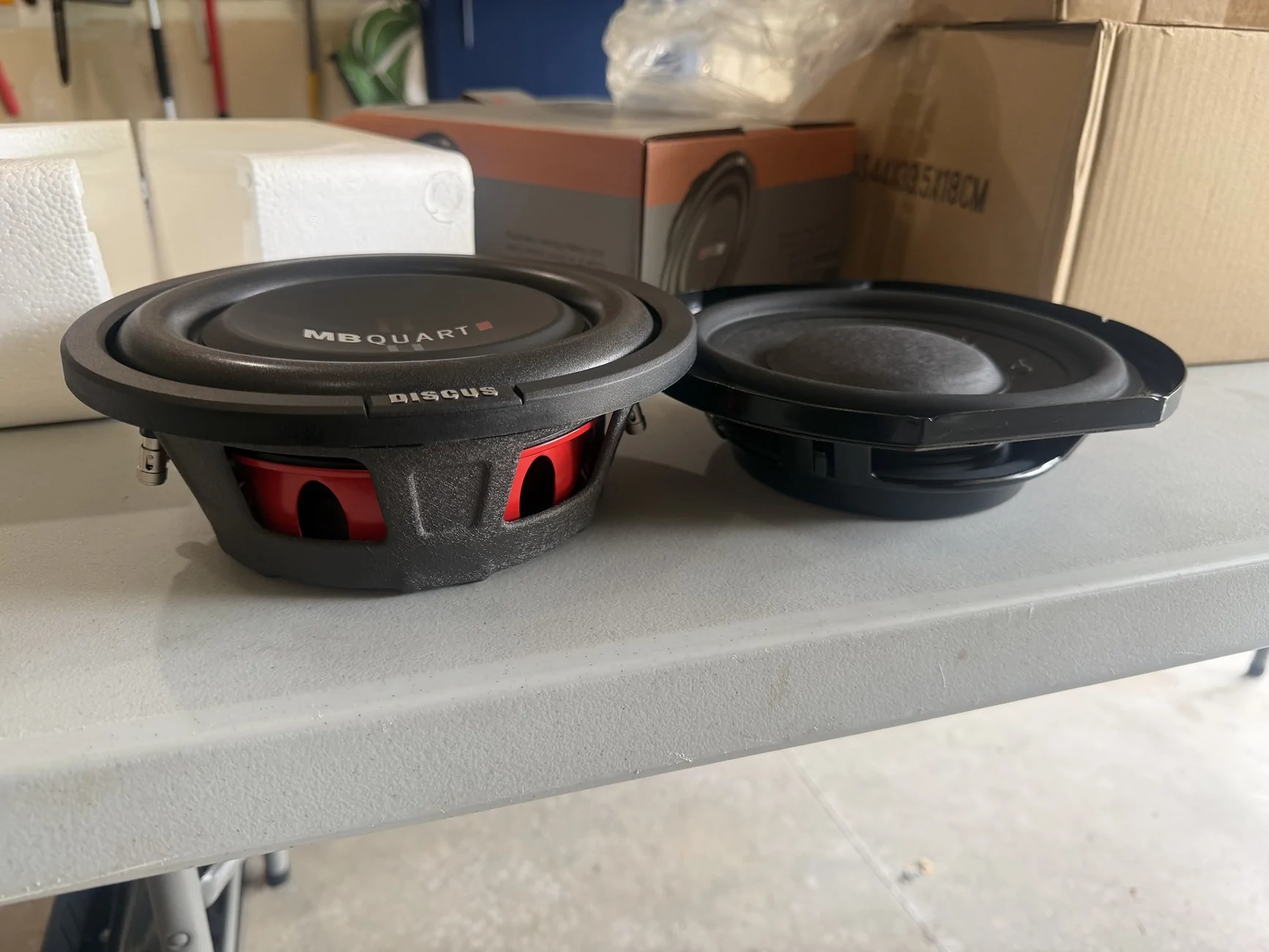

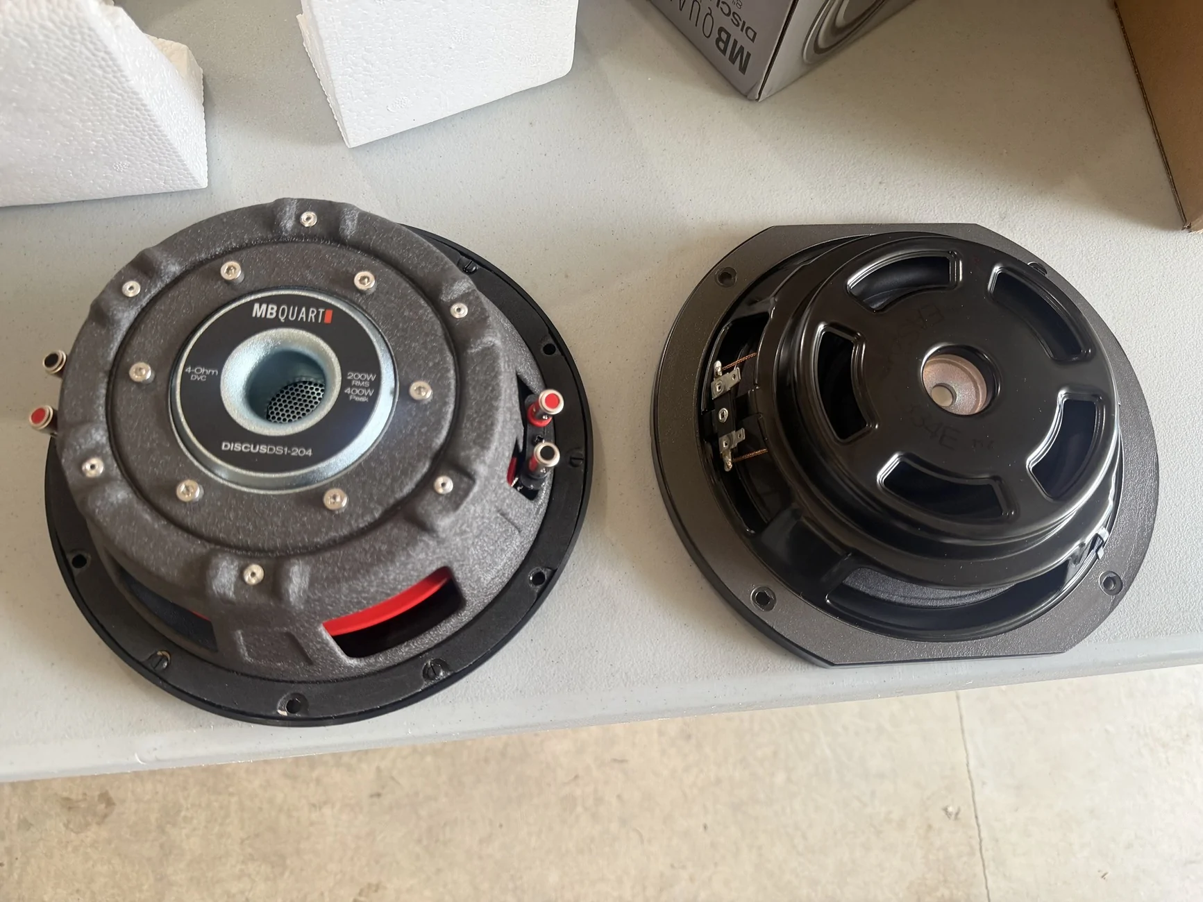

New vs Old.

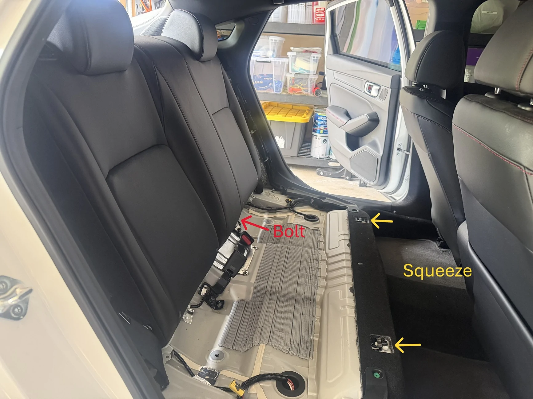

  5. Remove the rear seat bottoms. There's a single 10mm bolt in the middle of the driver side of the rear seat, fold the seatback down and use your 10mm wrench to get it out. Then there are two squeeze tabs in the front of the rear seat that you can reach with just your fingers and some swearing. Squeeze the tabs and lift up the seat cushion up.

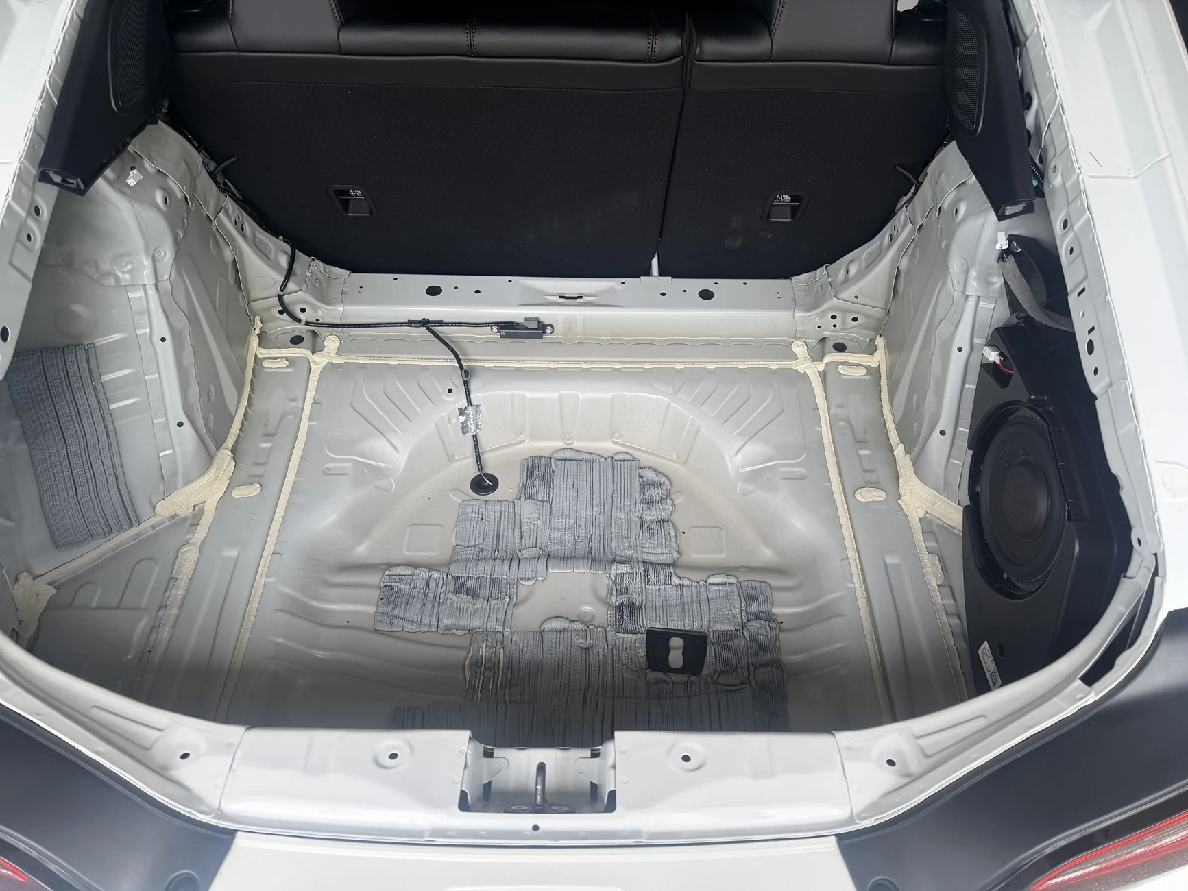

    Acura Integra How to: MB Quart subwoofer upgrade + rear sound deadening (nice, yet inexpensive) IMG_2655
  6. Remove the rear side-current airbags, these are located on the C-pillar next to the seatbacks. There are two 10mm bolts holding each airbacg on, one at the base, and the other under a little square cover panel halfway up the interior side of the airbags. Remove the bolts then undo the yellow wire connecter bottom by sliding the black plastic square on the connector away with your thumb. The connector pulls out the same direction the black plastic piece on it slides.
  7. Now you are clear to remove the big side trim pieces of the hatch area. There are approximately 4 clips along the top (pry the panels away from the wall, towards the center of the vehicle). There's also a little white wire clip on each side for the LED lights, just push down on the clip in the rear and pull out. You do not need to remove the upper-most trim pieces that have the little tweeters in them.

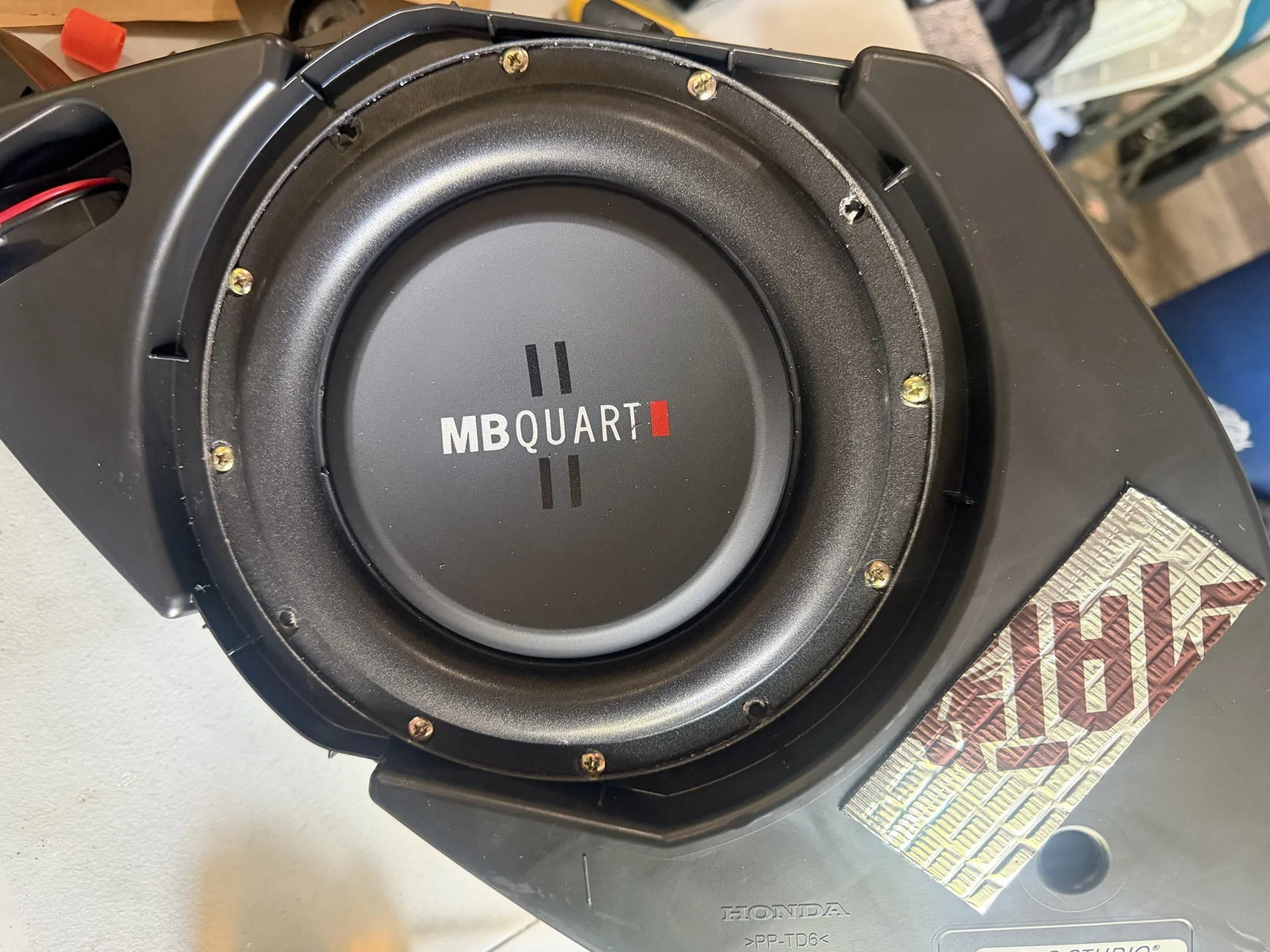

  8. For the sub enclosure there are two 10mm nuts, two 10mm bolts, and one wire harness. Remove all of that and take the sub enclosure out of the car for surgery.
Wiring the sub:
  1. Unscrew the four Torx screws holding in the OEM sub. We can't reuse these screws or holes, they're too far apart for the new sub, so we will drill 8 new holes.
  2. Unplug the OEM sub and throw it out a window.
  3. Pop the plastic surround covering off the face of the new sub (it's a PITA, used a metal pry tool) and toss it out with the old sub.
  4. Line up the new sub so that the MB Quart words are clocked the same way as the other text on the sub enclosure. Line up ONE of the old Torx scew holes with one of the speaker's holes and then drill 8 small pilot holes where the 4 original screw holes aren't located. See the picture below, the old Torx scew holes are the ones with the plastic circle around them, the other ones are new and are the ones we are going to use.
    Acura Integra How to: MB Quart subwoofer upgrade + rear sound deadening (nice, yet inexpensive) IMG_2668

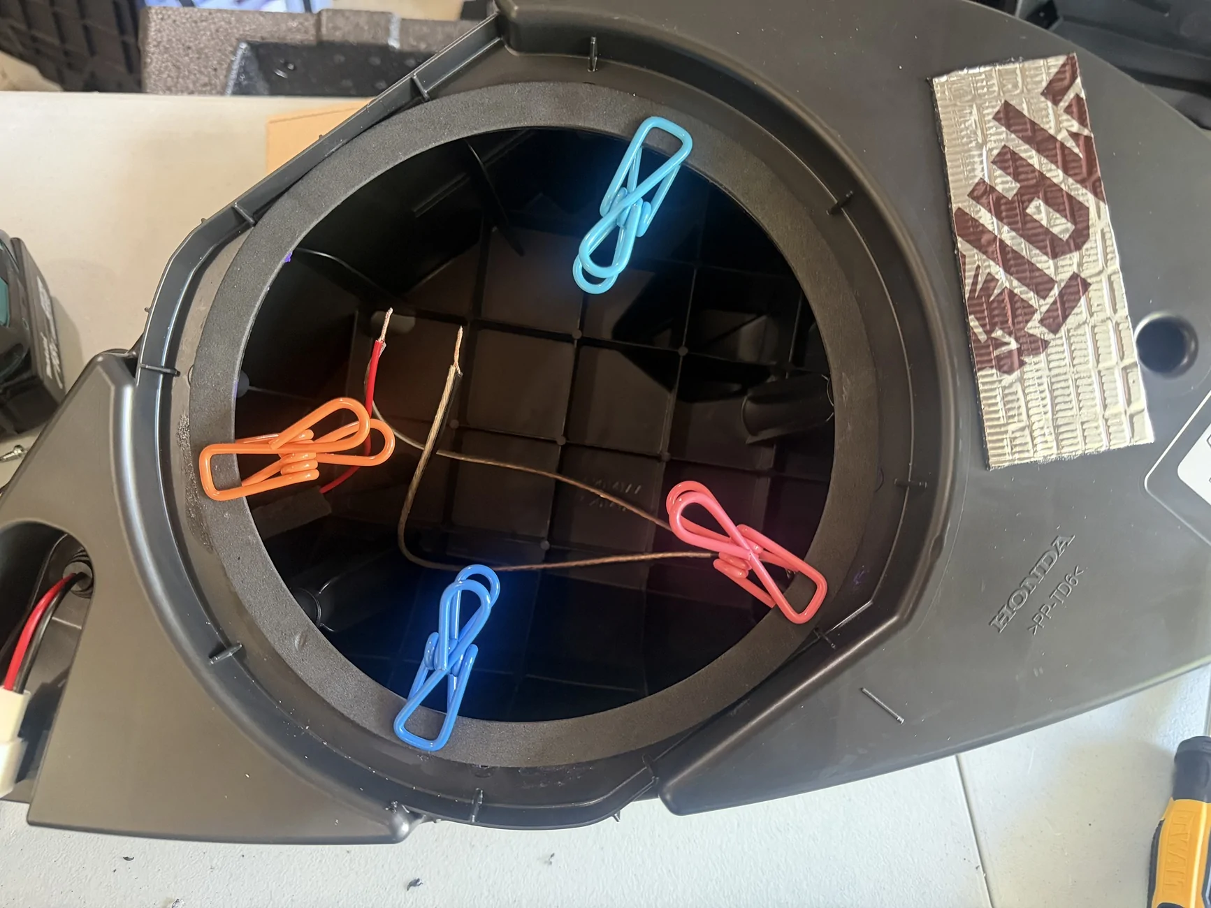

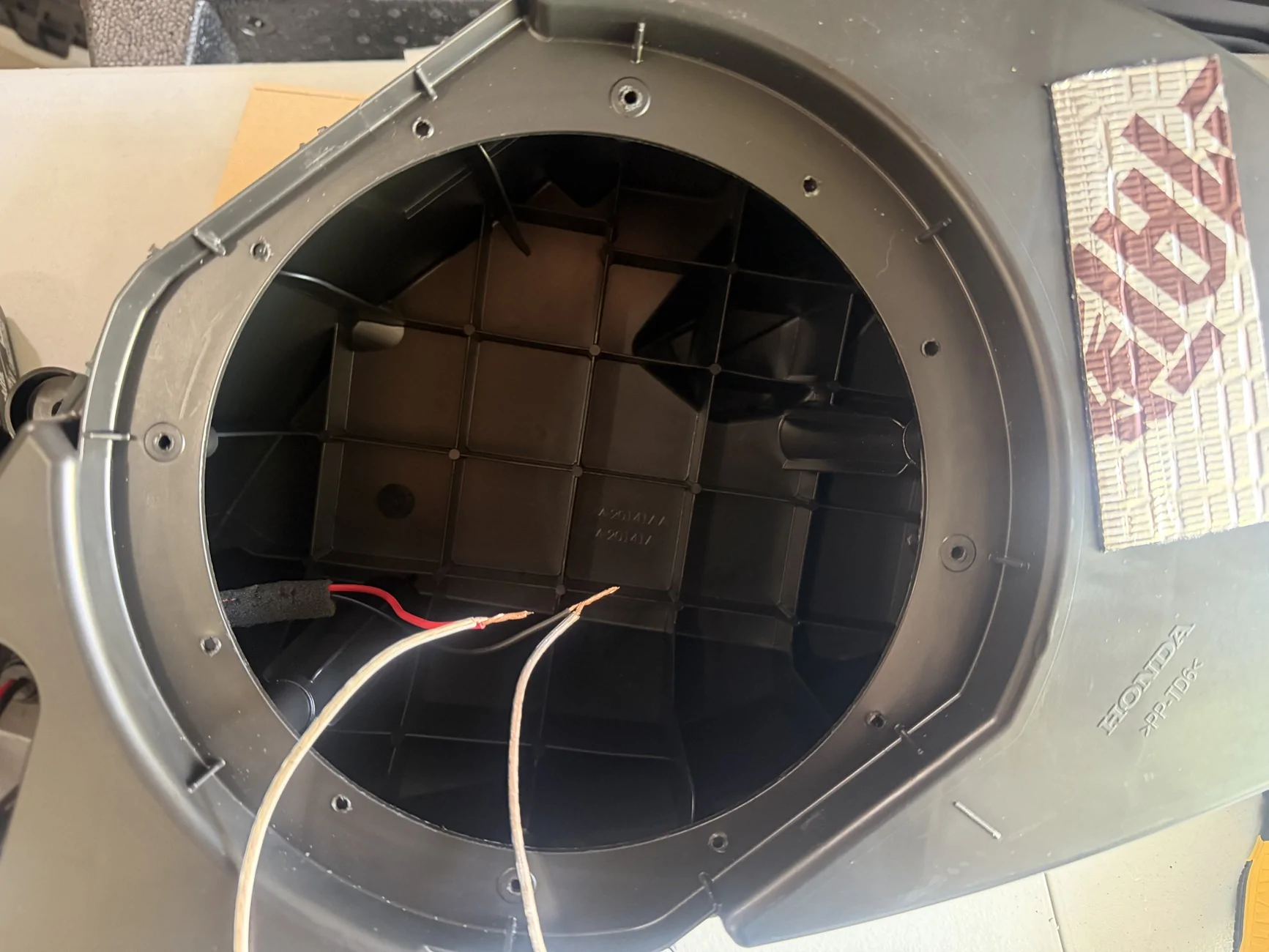

  5. Use some glue to stick the new foam speaker surround on over the new hole you drilled. You can clamp it down and wait a few minutes for it to dry, I'm just doing this to positively locate the surround while we put the new subwoofer in.
    Acura Integra How to: MB Quart subwoofer upgrade + rear sound deadening (nice, yet inexpensive) IMG_2670
  6. Poke some holes in the new foam speaker surround so you can line up the new speaker surround holes.

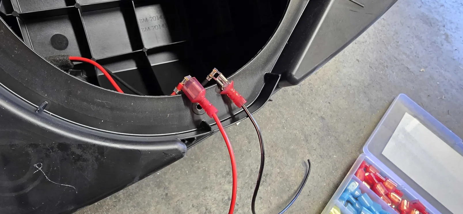

  7. Cut a ~12" length of 18awg speaker wire and strip 3/4" of the insulation off all four ends. Rip the two wires apart so that they are fully separated.
  8. Cut the OEM wire connect ends off the OEM speaker wire and then strip off 3/4" of the insulation off them too.
  9. Twist the end of the new wire to the OEM wire. Do this to both the positive and negative wires. Then twist the loose ends of the extra wires so they're easier to connect to the new sub. (I've already done this step in the images above).
  10. Use the pogo connects to clamp the red and black wires to one side of the sub, and then extend the extra lengths of wire to the other side of the sub. This takes the two 4ohm voice coils down to a 2ohm load (the ELS amp spec). Use the following diagram for guidance.
    Acura Integra How to: MB Quart subwoofer upgrade + rear sound deadening (nice, yet inexpensive) sub wiring
  11. Place the now wired new sub into the enclosure and screw in the 8 holes that are NOT the 4 OEM mounting holes:

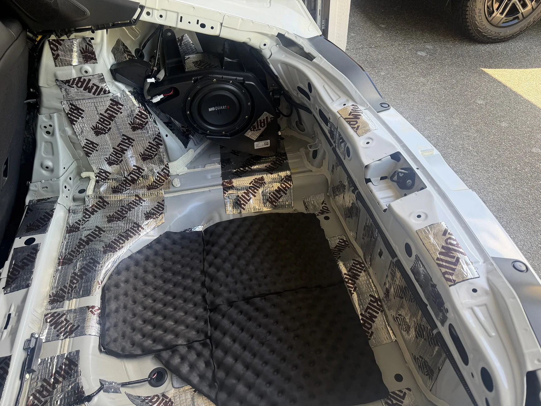

  12. I added a couple of small swatches of Kilmat to the enclosure, but I probably should not have bothered. The enclosure is part of the subwoofer system, and it works a little bit like a passive radiator. Making the enclosure "quieter" works against what you're trying to accomplish.
  13. The sub is done; you can now go test it by plugging it back into the car and playing some music. If you're doing the sound deadening, then take the sub back out and start working on the deadening.

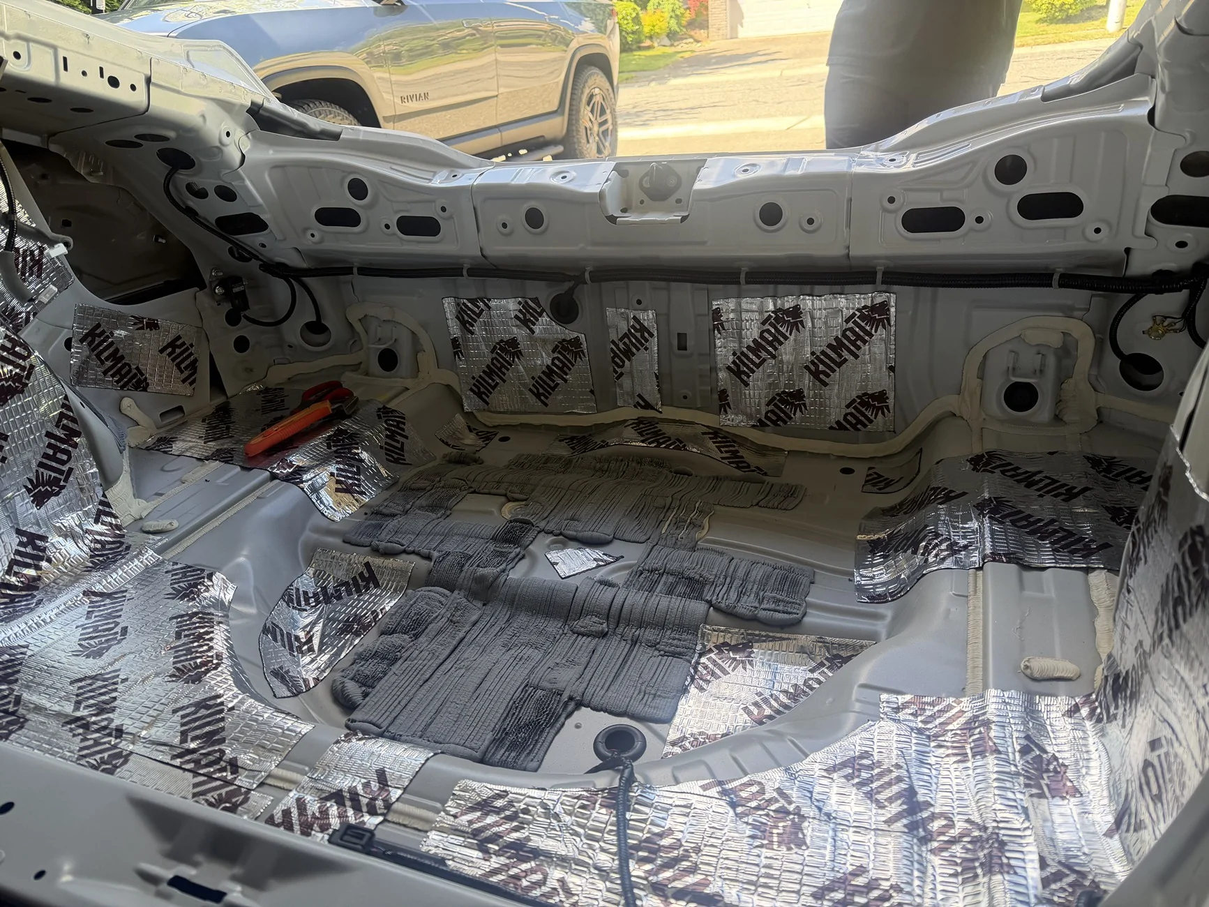

Here's the thing. These Kilmat alubutyl sheets aren't insulation, they're panel dampeners. They add spongy mass to an otherwise rigid plane of metal or plastic, which dampens how much NVH they transfer into the passenger cabin. You only need to get about 60% of a panel covered for this stuff to do its job, any more than that and you're just adding weight for diminishing returns. Long story short: you don't need to blanket every square inch of your panels.
You know where to put the sound deadener by knocking on a metal or plastic panel with your knuckle. If it's high pitched and loud then roll on a swatch of deadener and knock on it again. If the result is a much quieter and lower-frequency sound, then you've accomplished your goal. Honestly, I probably added a bit too much, but I'm happy with the results and it wasn't too much extra weight.
I did Killmat on the metal surfaces that sounded loudest with the knock test, and I did 3 pieces of the thick TroyStudio foam in the spare-tire well because it sounds like a tropical steel drum when you knock on it. I did the thin Aggsound insulation on the back of the plastic interior panels and the carpeted floorboard. I also added the TroySound under the rear seat, but it made putting the rear seat back in a pain in the ass, and the rear seat is mostly foam anyway. If I did it over again the rear seat would just be some Kilmat with a thin layer of Aggsound on top of it. Here's some pics (BTW, the factory gray foam sound deadening sucks ass and should be covered over with the good stuff):

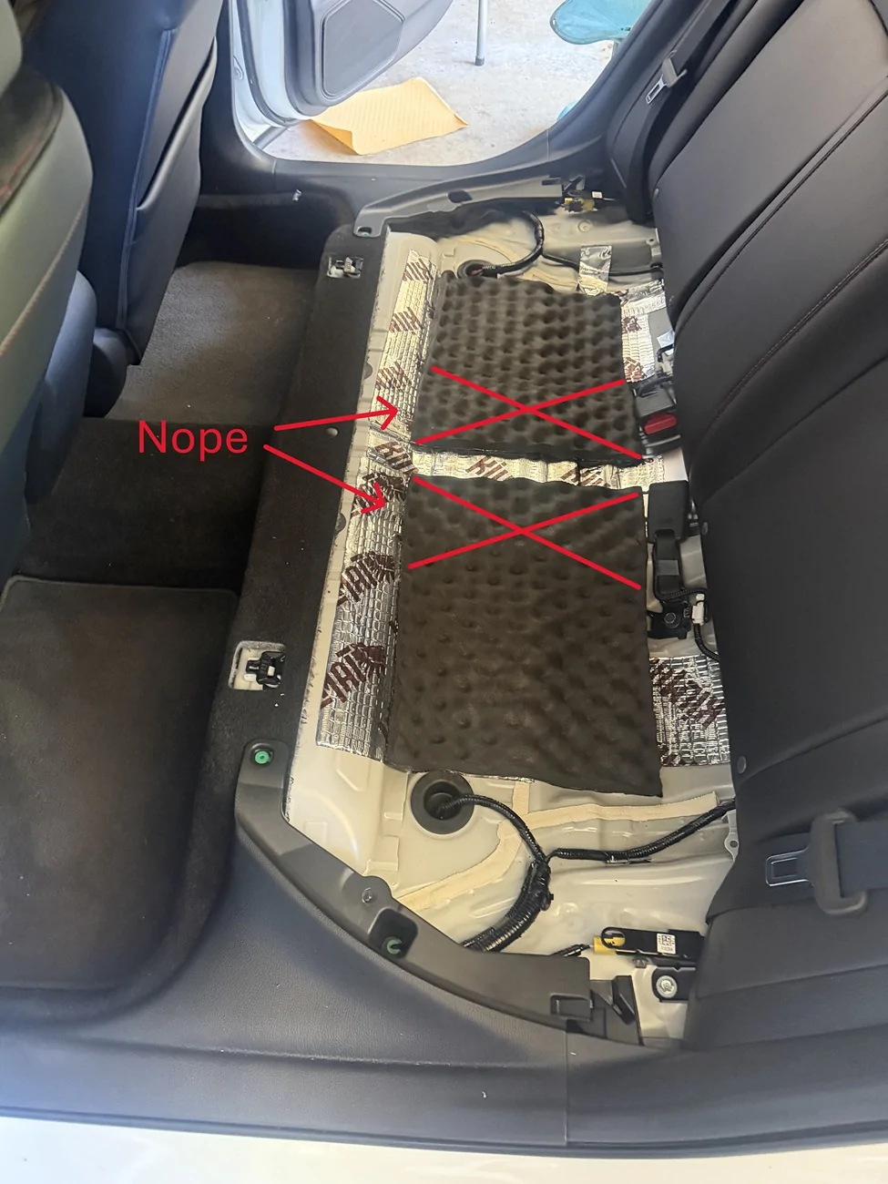

Here's the back seat, and I marked where you SHOULDN'T put foam down because of clearance issue. I cut them out where I marked in the picture, just don't do the TroyStudio stuff there, do Kilmat and Aggsoun

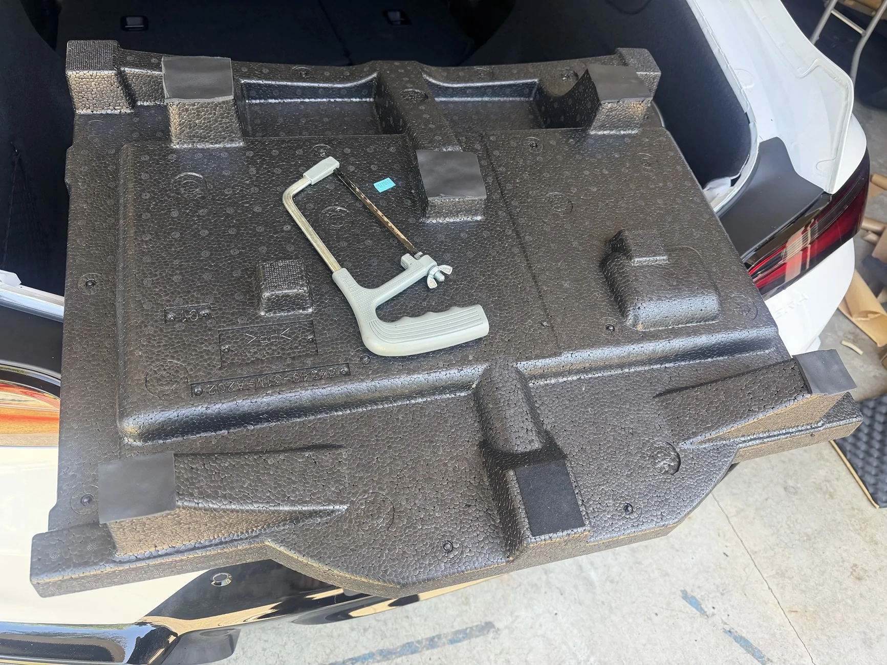

The last bit before putting everything back together it to alter the black styrofoam piece that goes into the spare tire well. I added about a 1/2" of foam padding in a few places, which made the styrofoam piece ride high and get wobbly. I used a little hacksaw (a bread knife would also work) to take some material off of the parts that were riding too high. I then stuck some Aggsound on the sawed-off parts to make them look nicer. This is just a trial-and-error process until the sytrofoam fits nice and snug again. EDIT: Do this step after you get the side panels back on so you know how high the styrofoam should be.

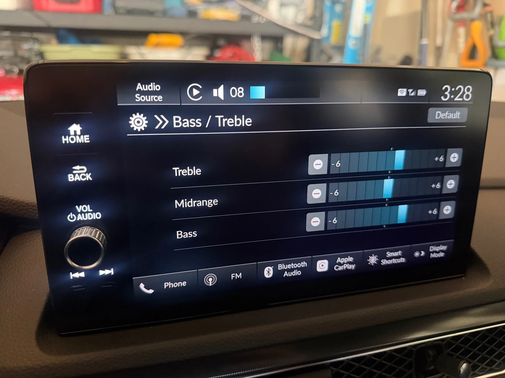

For sound settings I have DTS Neural Surround turned on, with Trebble and Mid-Bass flat, and Bass at +2 gain (to send a bit more power to the beefier subwoofer). This seems like a pleasant balance but YMMV.

how does the bass feel when the volume is around 10 and below? I know with the stock subs, you won't feel the bass until its like 15+
Hey sorry for the delay I was feelin’ sick yesterday. I’m sitting in my car right now with the music on 8 and the bass still sounds crisp and full.
I’ve got my treble and mid at the same range. But I have the bass cranked all the way up
I think that would be bassy as hell with this new setup. But EQ settings are totally subjective anyway, whatever sounds best to you is what you should go with.
