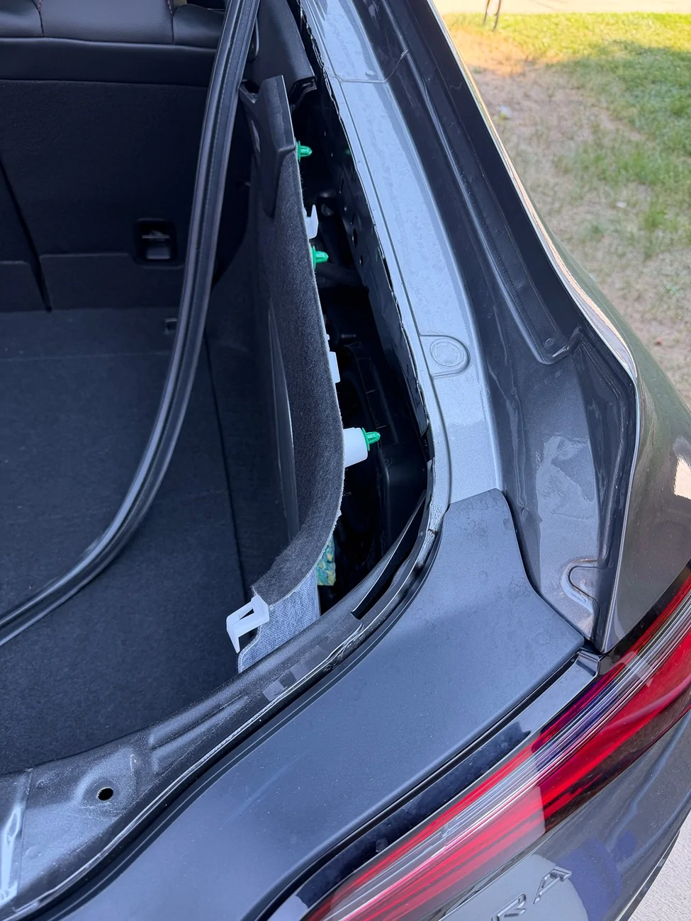

Ok. Homie with the wrangler installed. Took this mf like 10 minutes to rip shit apart and remove the whole sub box. 2 minutes to remove the sub. 1 minute of presenting the new sub and wiring it up as per the instructions here. Like 2 minutes to fill the bitch with a lot of that poly fill shit. Mf took more than I expected surprisingly. Maybe 10 minutes to put the whole enclosure back and tighten the nuts. About 20 minutes to put the pieces in the trunk back together cuz that back piece was being a little dick pulling mother fucker
right away. Left my eq alone. Got highs at like 60%. Mids at like 50% and bass at 100%
this mf thumps harder. About 10% harder. Not bad for 60$ and like an hour of work. Should’ve came like this from the factory.
