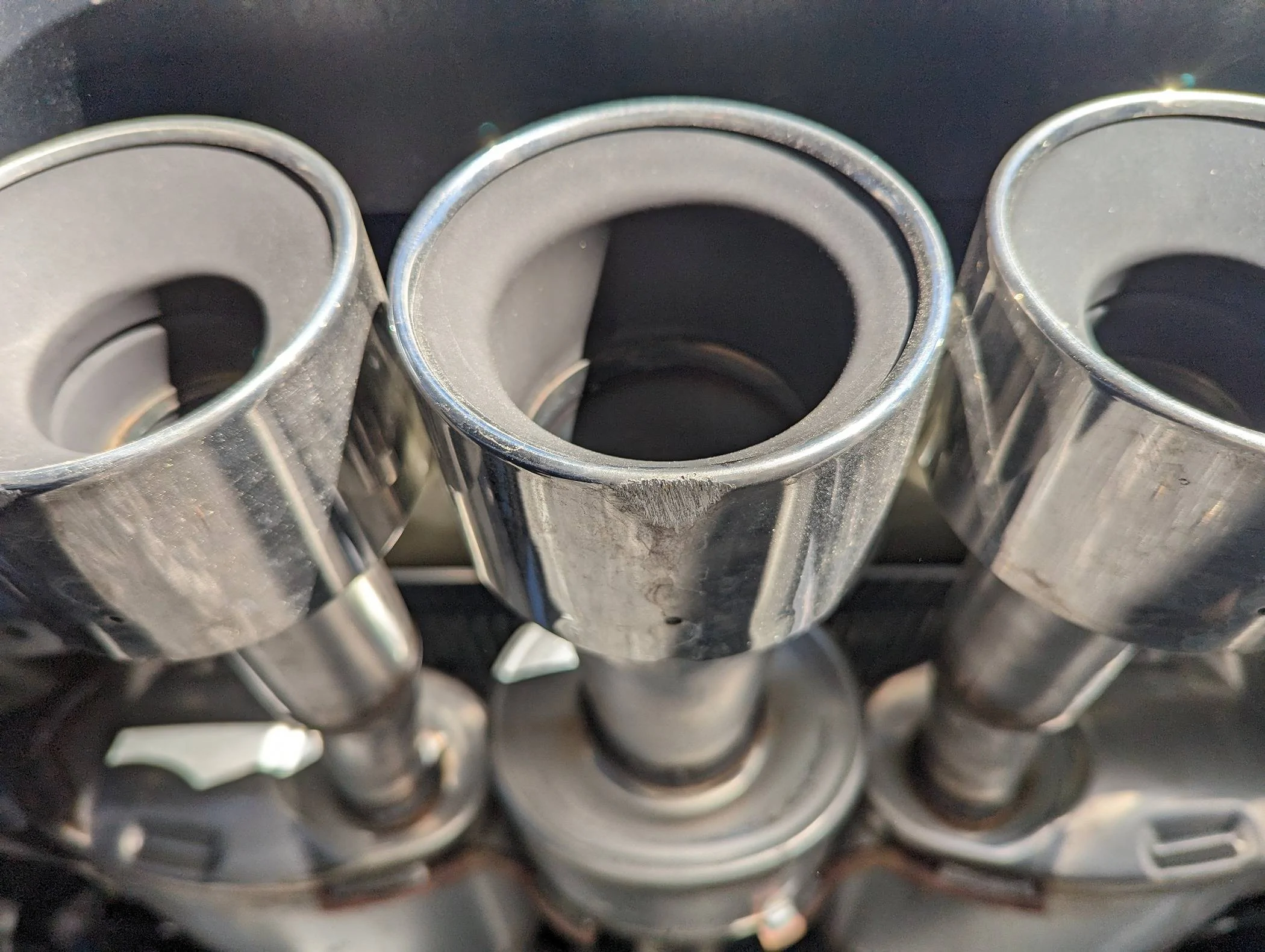

I don't have a steep driveway, but I find that many/most driveways in this area (Bay Area, CA) have rolled curbs and many cars scrape. And this car is especially low! As careful as I try to take an angled approach, the plastic air dam/skirt underneath the front of my car has been scraping and whittling away. But I've noticed a few times that something in the rear catches and scrapes too. I took a look and finally figured out what was scraping -- the exhaust tips!
Wondering if anyone else has encountered this problem too? I wonder if there are replacement or aftermarket tips available. A bit annoying how gingerly I have to drive this car pulling into and out of driveways (and I have stalled a few times in the process too while trying to modulate the throttle and clutch especially in reverse gear as I back into my driveway, again due to the angle).
Also, as I took this picture quickly this morning, and only the center tip is mostly visible, but all three tips have been scraped/scratched to some degree.

Dreamshop only seems to list the whole exhaust and not just tips...
And a sleeved option that goes over existing tips would only make the problem worse...

Ouch. Knock on wood but haven't scraped the exhaust but I've certainly scraped that 90 degree panel underneath.
You are still scraping the exhaust even taking it at an angle?

i made a post a few weeks ago about that feature under the front lip catching in driveways, but i've never had the exhaust tips catch thankfully. i don't have a rolled curb, but the angle of my driveway entrance with the steep banking of the road crown form a pretty sharp 'V' which was a problem for me
if you've got a rolled curb, you might want to look at getting a bridjit. they're kinda expensive but obviously worth the money if you want to avoid this type of damage to your car. even though i don't have a rolled curb, i actually bought one of these a few years ago when i had my Si coupe and it was JUST enough to keep from scraping, but with the Type S being so much longer it didn't help no matter what and i eventually just paid an asphalt company to come dig up the end of my driveway to re-grade and re-pave it, which isn't cheap- but neither is replacing your exhaust system since you can't replace just those tips lol

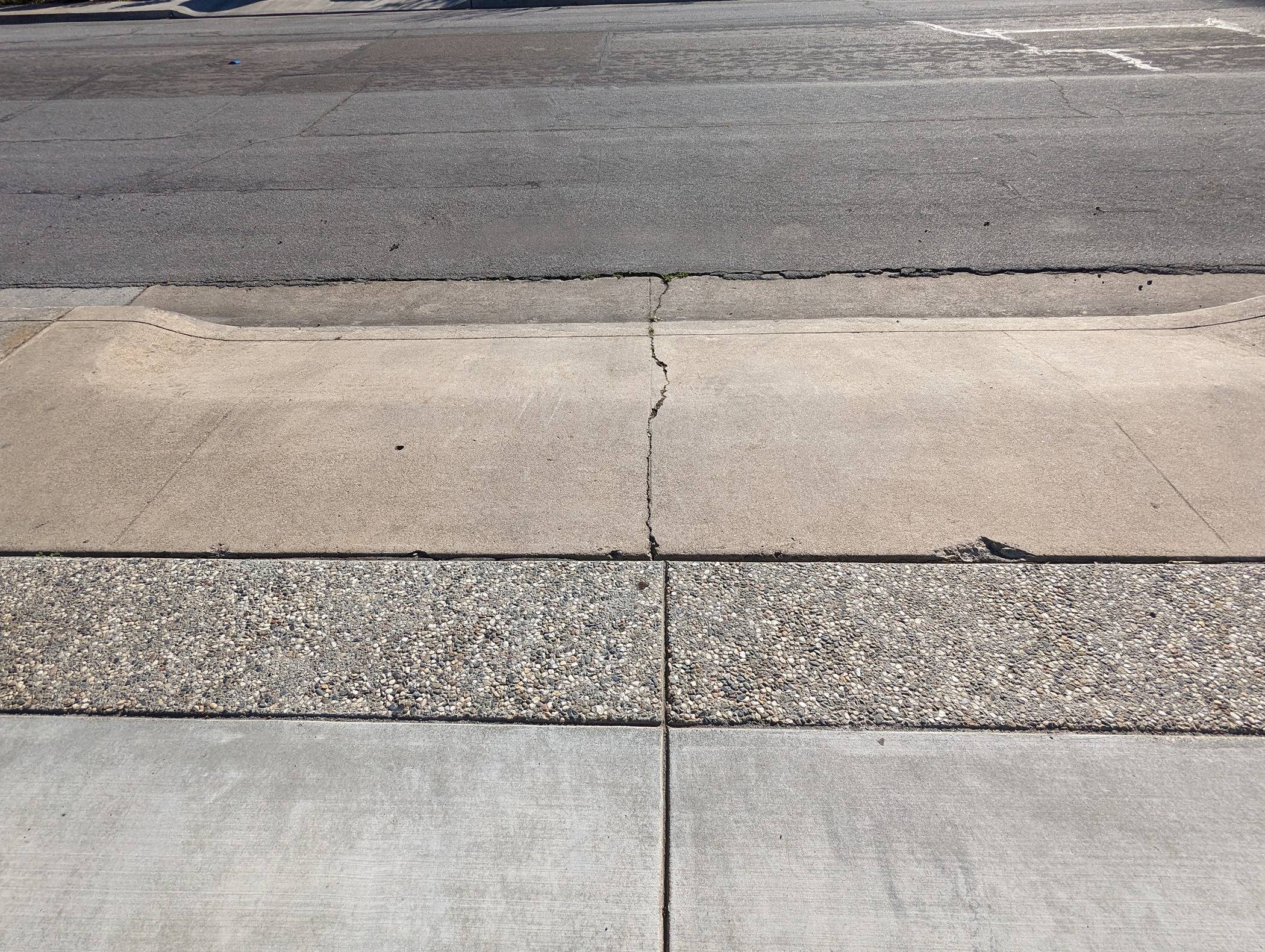

Here is a picture of the driveway/curb
Actually, now that I remember, for our old Mini Countryman (R60 generation that was sold after we got the KIA), after installing a hitch , the hitch receiver underside would be very close to scraping too especially when loaded with our bike. So I added a small M7 lift kit to raise the suspension a bit

This looks a lot like mine except the street level has a slight worse incline. I definitely think a 2' wide steel plate bridging that part where it connects at the drainage should get you free and clear but so far I'm able to manage without scraping that bottom 90 degree underpanel. I have to get it at a pretty big angle though and back in slowly so the suspension doesn't rebound.
