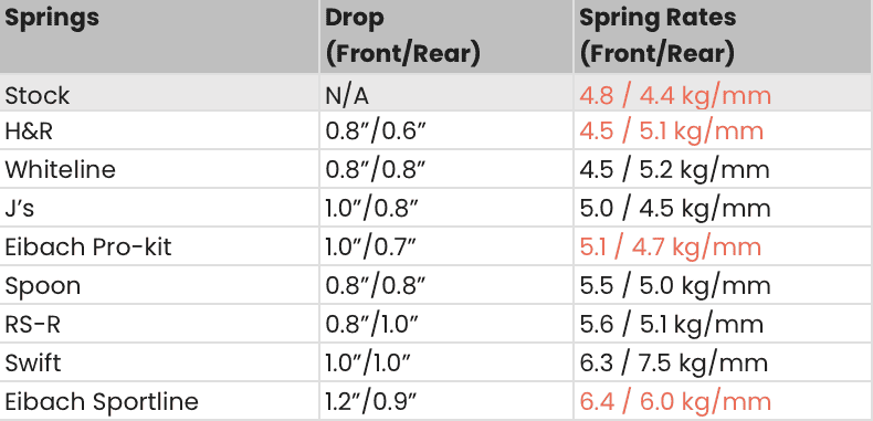

It seems like the springs rates available for lowering springs are all over the place. Some increase the rear more than the front but some don't. I'm leaning towards the Eibach pro-kit at this point.

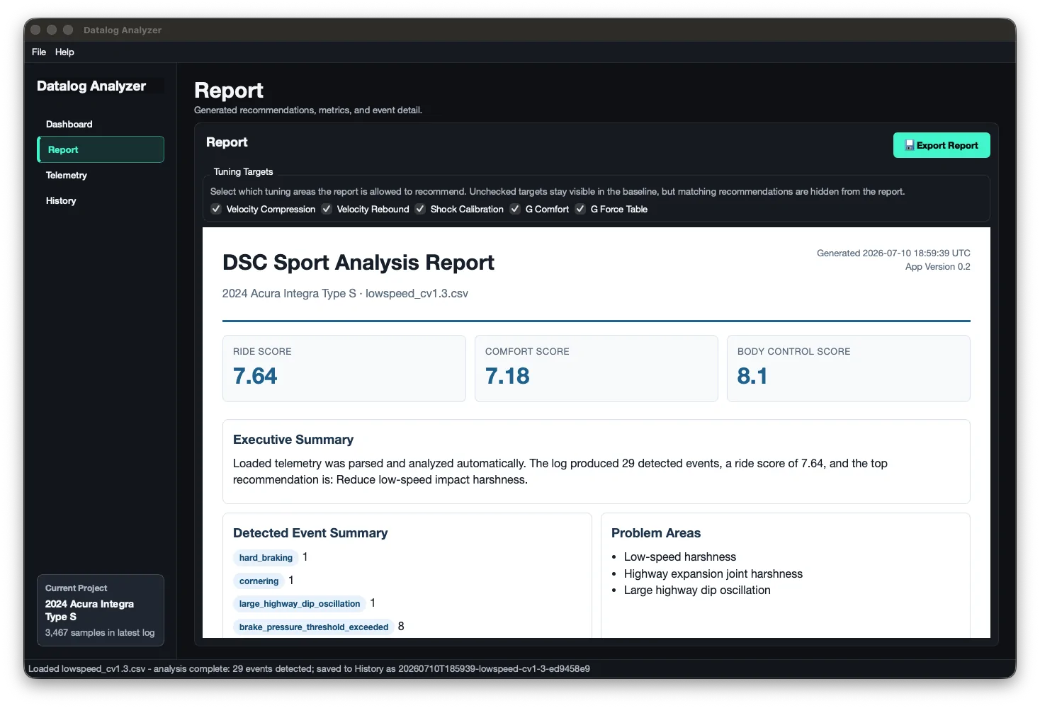

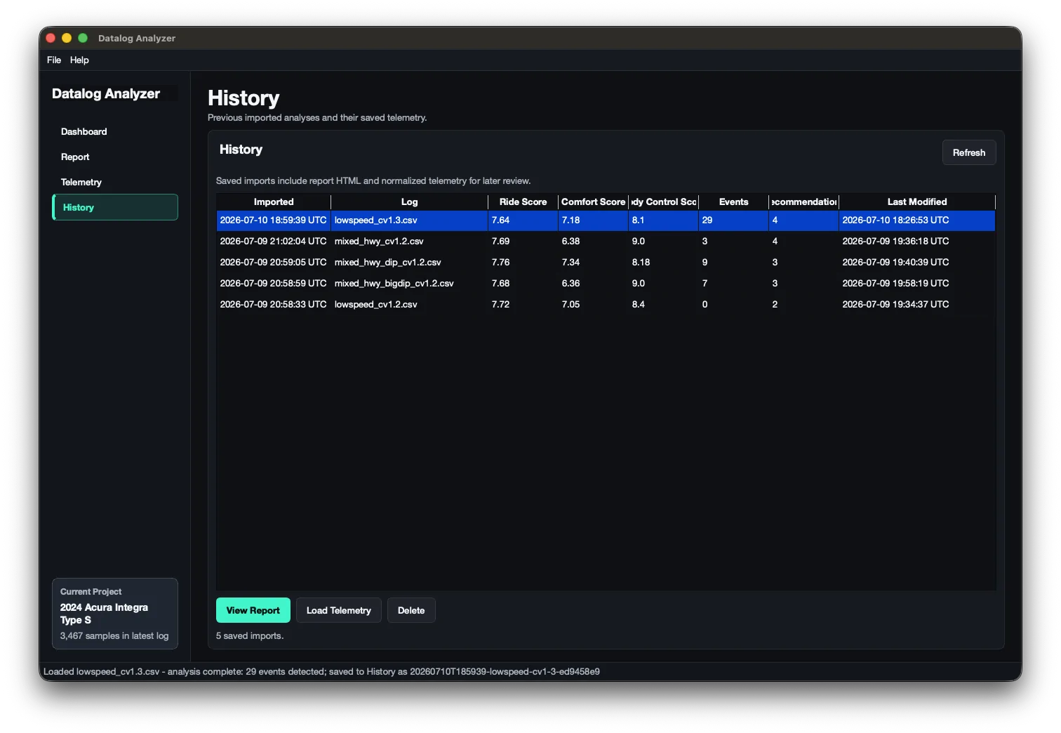

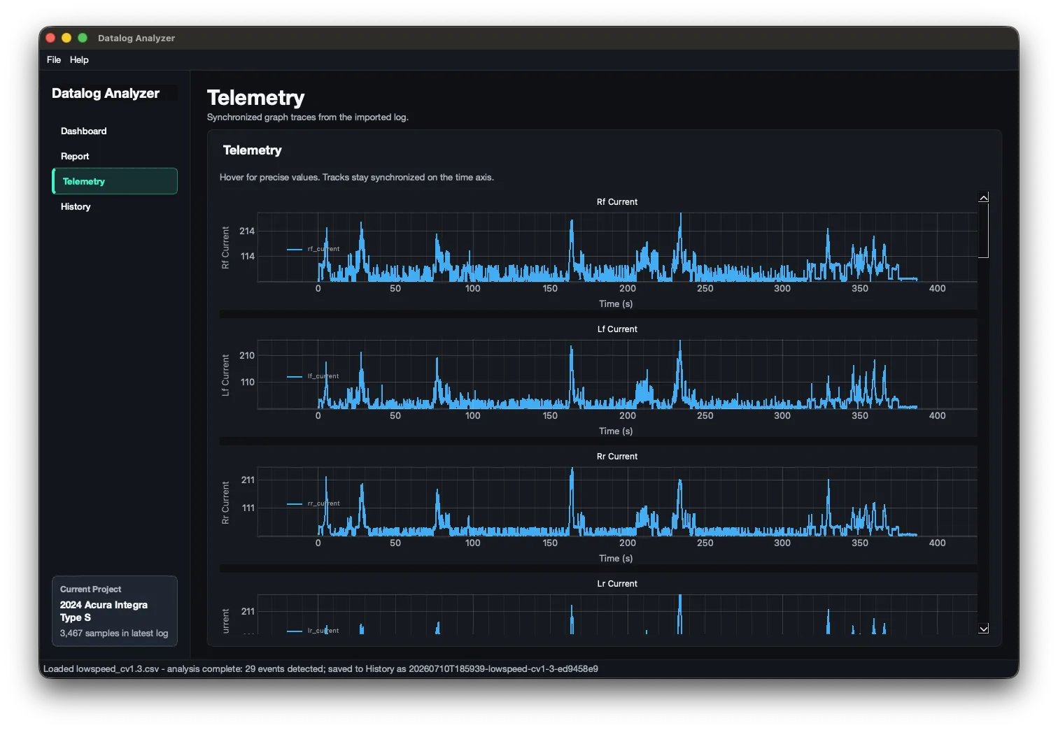

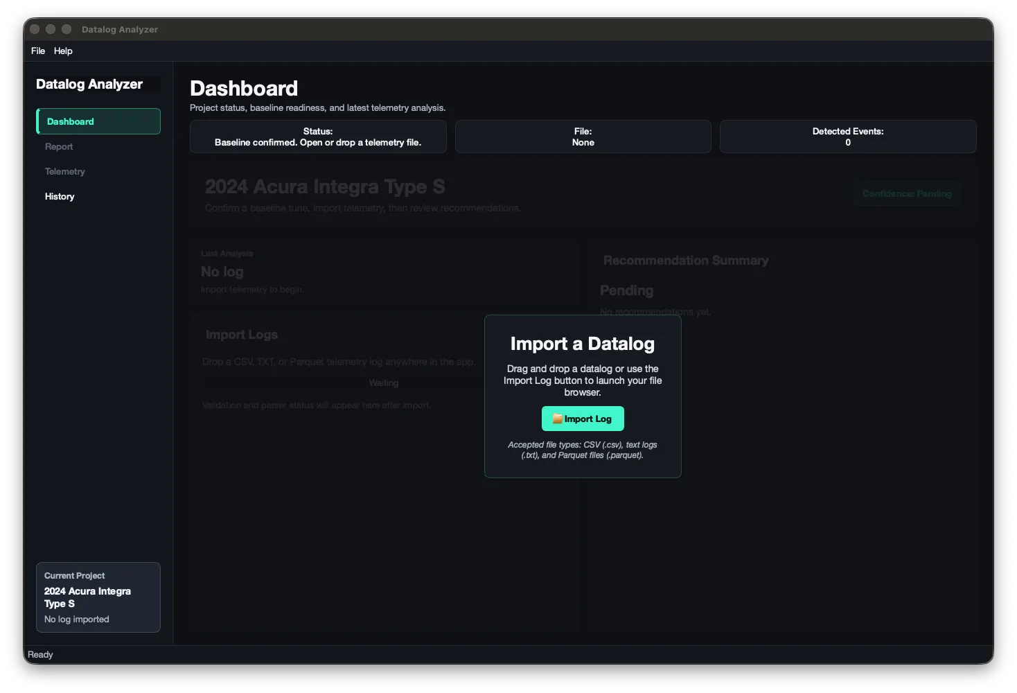

Alright people, BIG updates! I've been patient and let the last revision settle in for a few months. The comfort settings were plush but so much so that I lost steering feel and introduced unsafe levels of rebound. At highway speeds, the car was too floaty for my liking which sent me back to the drawing board.
One challenge I've had with the software is the ability to properly interpret the datalogs without using the DSC software. For those of you that know, you must have the computer connected to the module to read the datalogs. This doesn't work well for me so instead I setup to create application to do the interpretation.
What I'm calling Data Analyzer is still a work in progress, but here are a few snapshots of what to expect:
Acura Integra DSC Sport Suspension Module for our cars! Screenshot 2026-07-10 at 2.59.30 PM
Acura Integra DSC Sport Suspension Module for our cars! Screenshot 2026-07-10 at 2.59.46 PM
Acura Integra DSC Sport Suspension Module for our cars! Screenshot 2026-07-10 at 2.59.52 PM
Acura Integra DSC Sport Suspension Module for our cars! Screenshot 2026-07-10 at 3.00.01 PM
I plan to eventually package this and offer for others to test at some point in the future.
