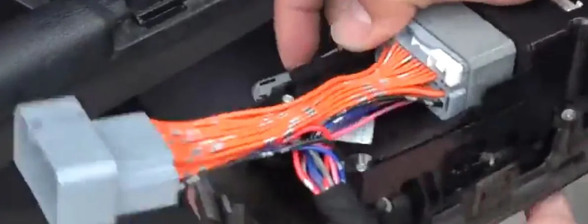

@Integra23 I recently put an order based on the list your provided on the first post. I assume the canbus should come with the wire harness correct? The link just showed a picture of the canbus unit and the instructions look like there is a harness that attaches to it.
3,443
2,932
The roll-up canvas module plugs into the driver side window switch module. It allows you to roll-up your windows with the key fob. By default you can only roll them down.
mugendc4
Dec 18, 2023
100
40
Socal
DE5
So it doesn't require a harness like what the video showed? There is a slot where it snaps in?
Acura Integra Auto Folding Mirrors installed Captur
3,443
2,932
Your correct. That harness is used for the auto-up module. It snaps in but still needs to connect through the harness.

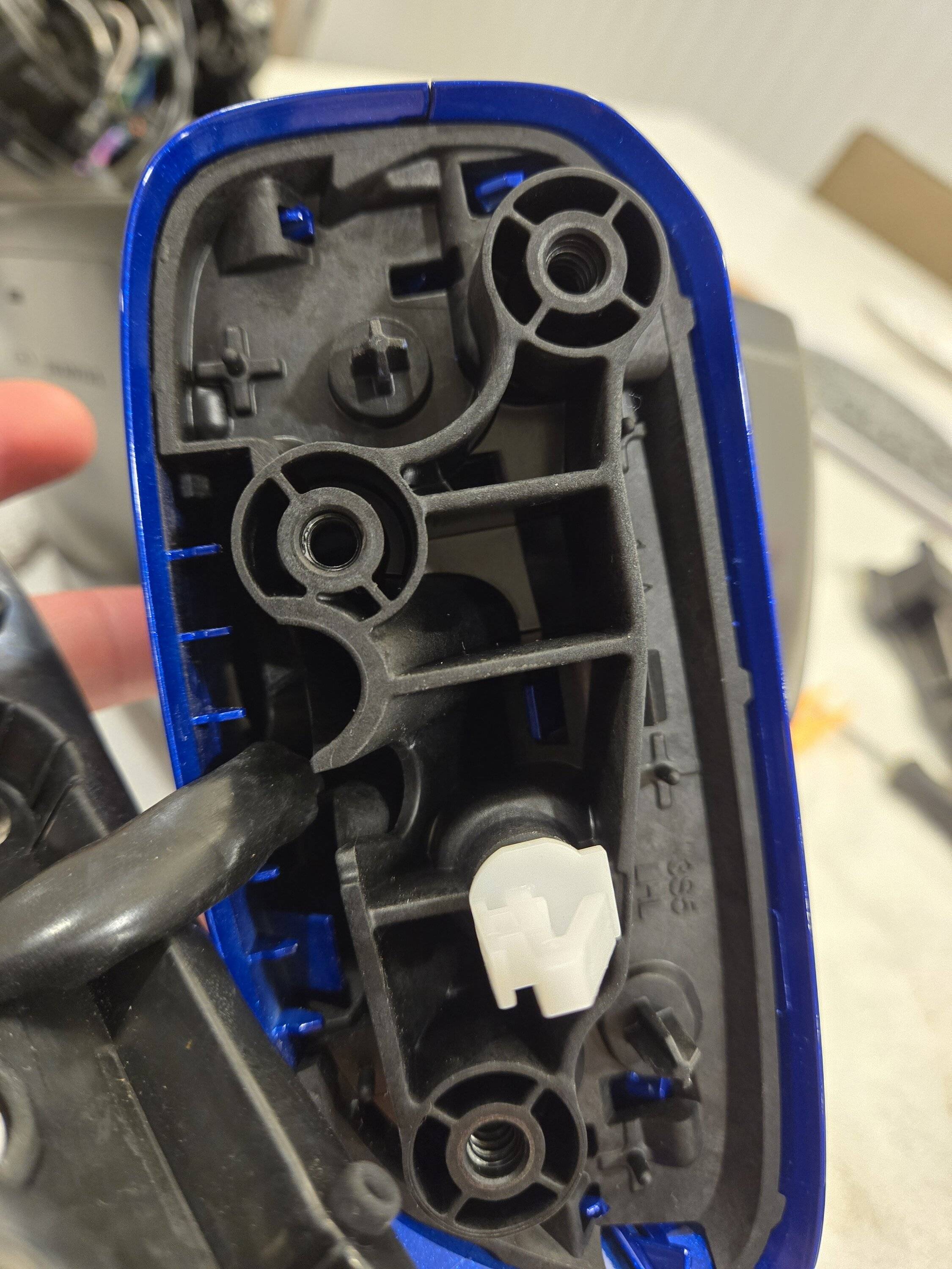

This kit comes prebuilt and ready to install minus mirror covers.
This is originally for a civic and our Integra mirror base that secured to the car is a bit different, it also is painted to match the car vs civic black plastic.
I at first was hoping to switch over the mounts plastic trim but it wasn't possible.
To switch the mount and rubber seal you have to depin the connector. Luckily the MIK kit comes with a pin extraction tool( a sewing needle would also work).
Once pins are remove you can swap the gasket material and plastic painted trim between your factory mirror and this folding setup. Take photos of the connector prior to removing pins so you can reinstall.
I finally got my Kit and was hoping you can clarify this part a bit. I haven't taken apart my mirrors yet but looking at the mirror from mikstore (Civic), it looks like the plastic base comes in two pieces held by clip. Did you have to depin the connector to remove it? The integra painted base looks like it comes in two pieces as well.
3,443
2,932
That lower painted piece is a cover and it can be removed. I did switch the bases out which required depining the connector. I can't remember if that's needed because of the painted cover won't attach to the new base or if the new base is different and won't attach to the car.

@Integra23
How did you remove the base to swap? I can't seem to remove the base's trim..
Did you have to take apart the whole mirror?
