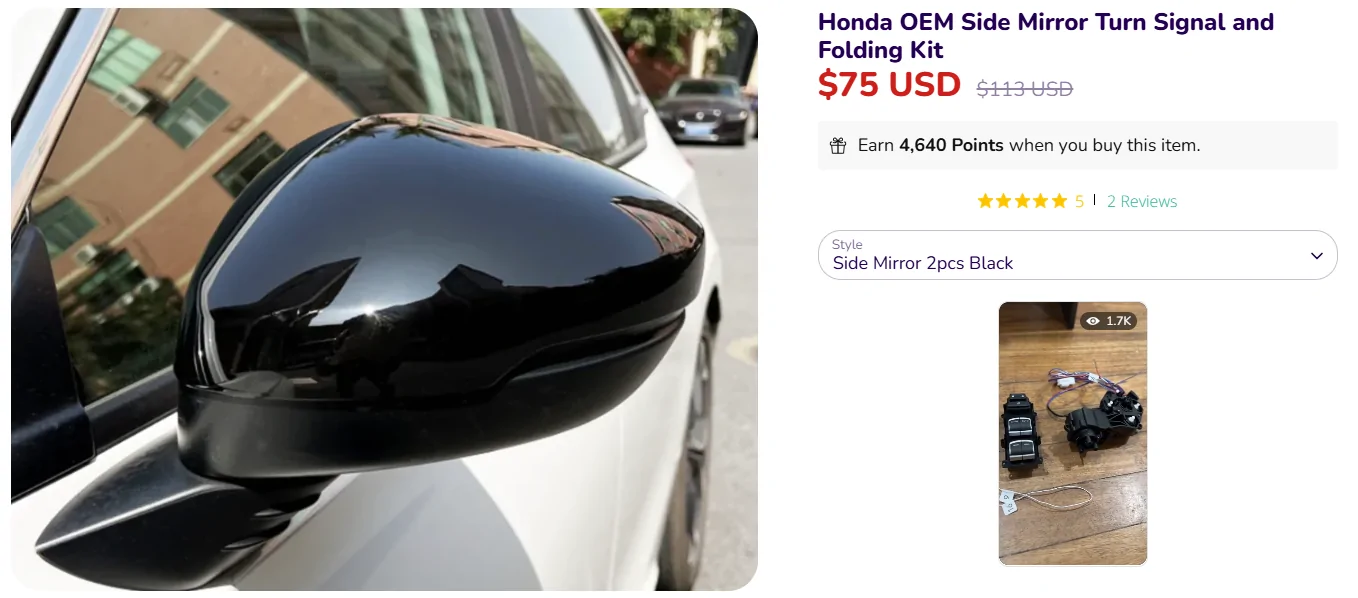

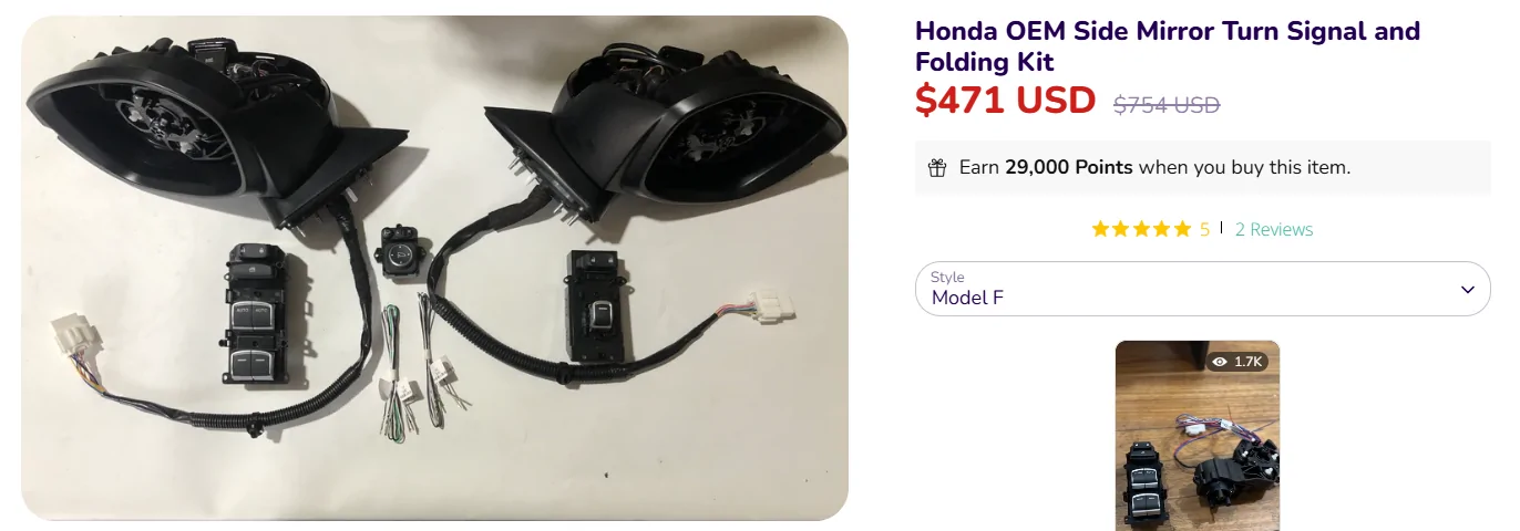

My Acura Integra 2023 A-Spec Tech was involved in a minor accident, and the right rearview mirror is totally crashed. As I need to replace it I have an idea to get an autofolded one. It appears I need from the Mikstore:
Model F
Acura Integra Auto Folding Mirrors installed 1785400339817-ln
+ Side Mirror Covers
Acura Integra Auto Folding Mirrors installed 1785400428414-6h
Can anyone advise if I get the coplete kit to replace my mirrors, buying these two positions? I'm not sure because on the picture of Model F I don't see mirror glasses... As mine is crashed will I need to find a mirror glass as well?
Model F
The Model C kit does come with glass and should work - it will have extra wiring for BSI and turn signals which you wouldn’t need.

Thank you for thd answer, but i'm still not sure if the Model C kit can be installed on Acura door. I mean probably the mirror base will not fit the acura door. I've asked the google AI and it said that i will not be able to install it. Instead I should find acura's sidemirror and rebuild it taking parts from Model F(or C) to add the autofolding feature.

Yes, you’ll have to swap the base of the mirror with yours. There are a few videos on YouTube on how to do it.

I'm going to buy the kit "Model F - Acura Tech Model with Factory Reverse Tilt" + covers + will need to find a right side mirror glass from a-spec tech 😆
