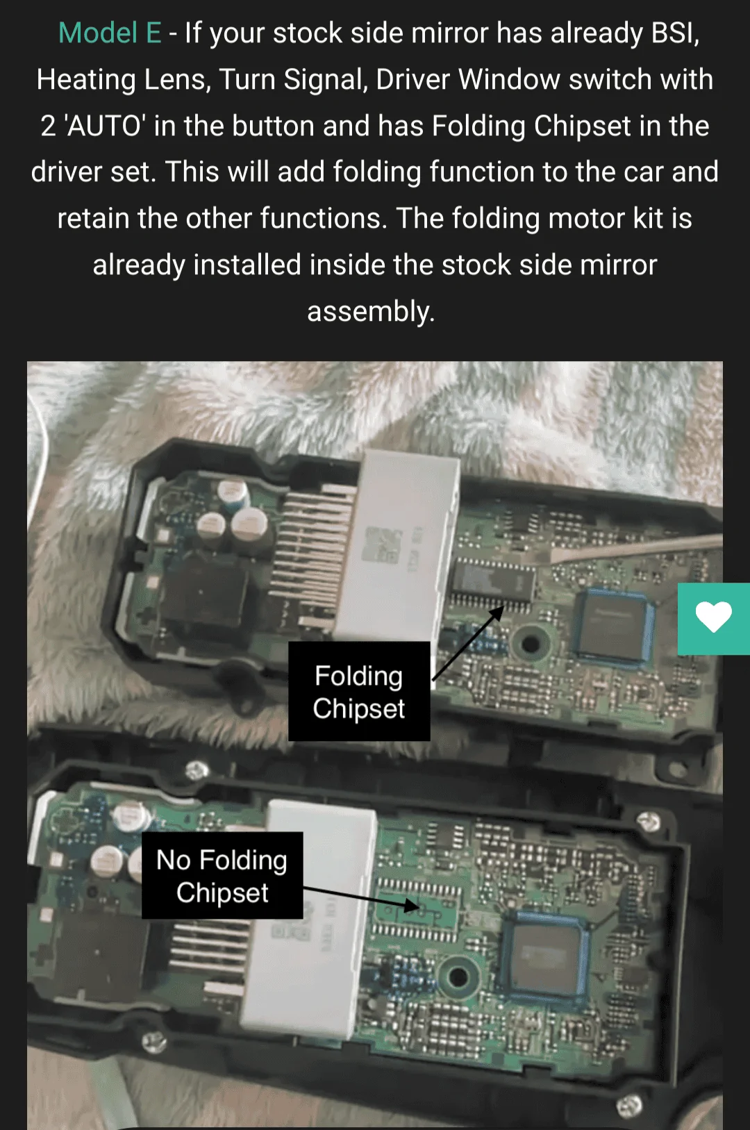

Model E if ours already had the folding Chipsets.. I'm not sure didn't crack mine open. If it does you can save some cash
Acura Integra Auto Folding Mirrors installed Screenshot_20231115-164743
Yeah, easy to check, just one screw and the rest is just clips on the edges. As for the A-Spec Tech, it didn't have the folding chipset.

i guess we do need the more expensive Option C
Well, its worth popping yours open to double check. From my understanding sometimes Honda/Acura will pick parts off the shelf depending on what's available. It's very easy and you never know.
Also, I saw some discussion above about the reverse tilt feature on the tech package. Be advised that the C kit will eliminate that feature. The only way to keep it would be to open up the C kit passenger mirror and do some modding.
