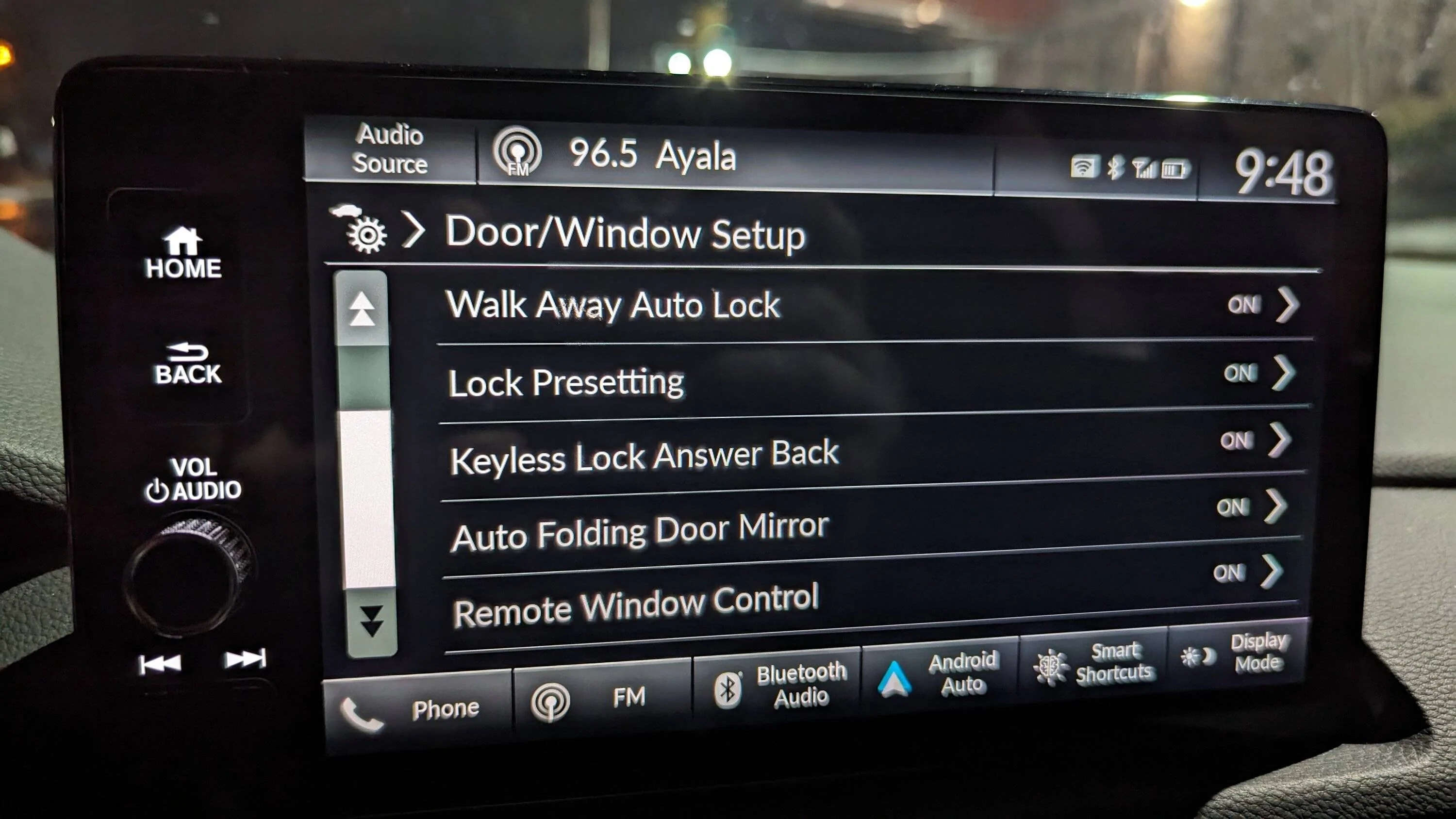

Sooo.. it does add an option to disable the folding mirrors in the door/window setup. This is a plus for those of us in salt territory.

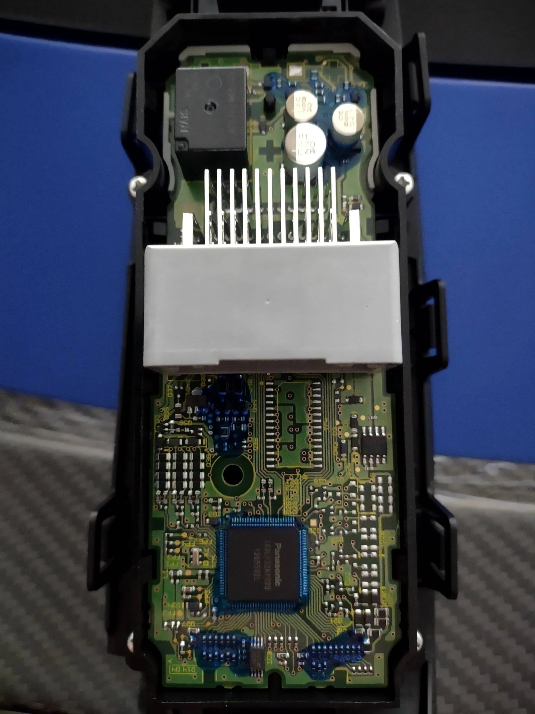

I just checked my Type-S driver's side switch for the chip, unfortunately, it's not there.
I never checked mine but thought it wouldn't have it since the menu option wasn't there prior.

He used what is looks very similar, if not the same as, the Model D kit. I'm thinking you need the driver's side switch assembly w/ the chip for it to show up in the menu like yours. Speaking of which, you don't happen to have the Honda part # for the driver's side switch assembly they included w/ the C kit do you?
I was thinking the Model D kit w/ that switch assembly is really all this is needed for the Type-S, but the combined price might be as much or more than the C kit. Though, there would be a little less work than there would be doing a tear down on the c kit mirrors to maintain the original appearance.
BTW, did your original mirrors have the 14 pin connector?
I don't have the part number.
Yes same connector as OEM mirror it just contains a few more wires.
i can confirm, the A spec tech does not have the needed chip in the driver's switch assembly. (or at least mine doesn't). A fact i was unaware of when I started my little journey. This necessitated sourcing the correct window switch assembly, which in turn pushed up my costs to the point that if i had to do it over, I would just get a C kit from mikstore. I hardly saved any money and spent multiple hours that would have been unnecessary if i had gotten the C kit from the start.
Good to know, that answers one of my questions I posted on your DIY posting, but not the question regarding the different mirror switch. Can you confirm the part # of that switch?
The Mikstore kit I installed on my Type S does not add this option on my menu.
