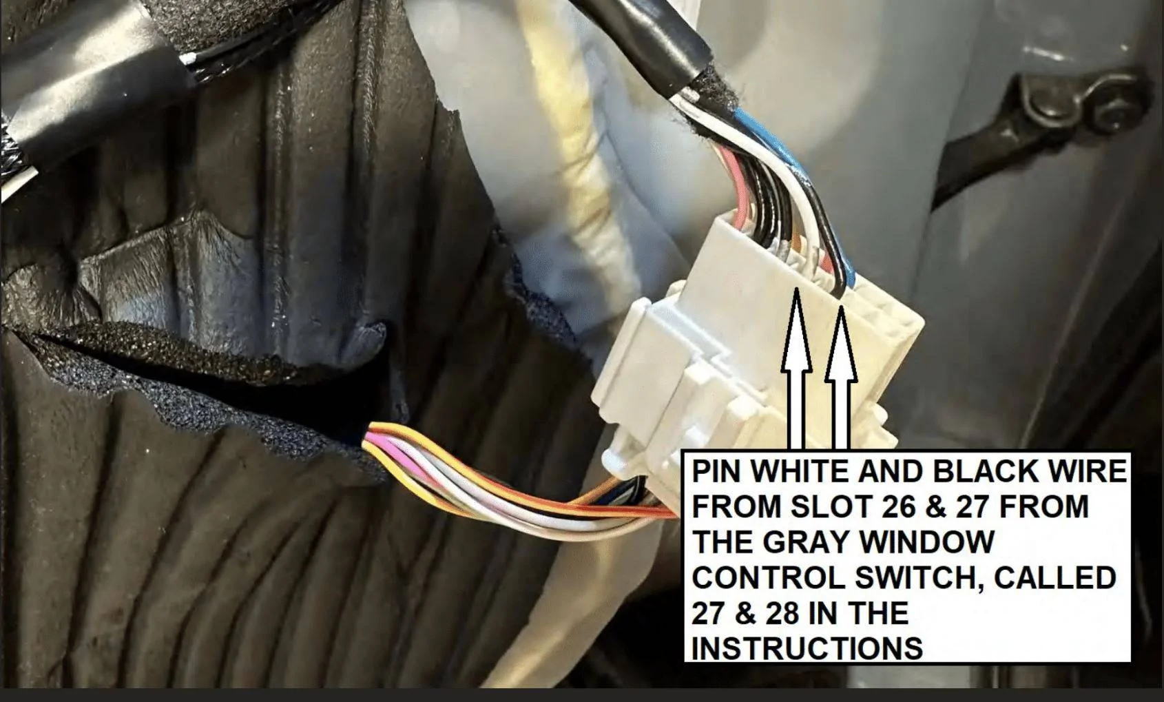

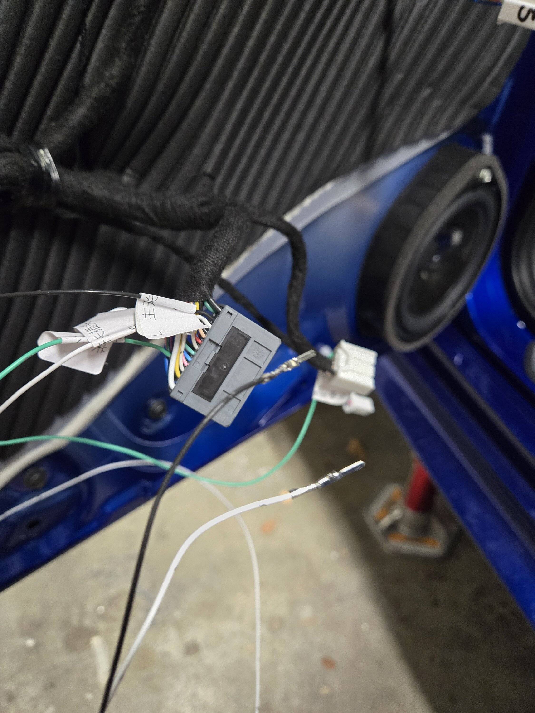

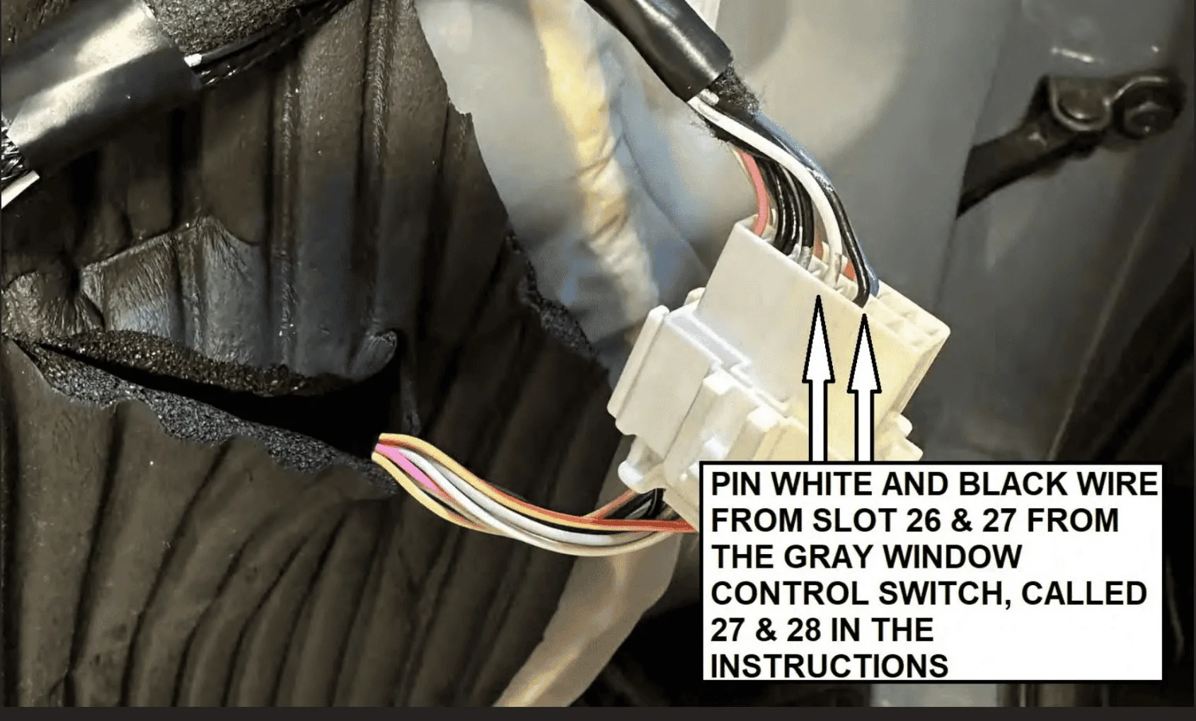

What do I do with the ends of the white and black wires? I pinned the green from white to gray . Then the two wires into the gray and now they're just hanging there.. Instructions don't say.
It's weird how mikstore instructions are but if you look at both the Installation guide and the installation guide - civic si, it should connect to the side mirror connecter harness that is attached to door frame

I actually figured that out just now. Thanks!

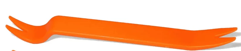

4. Use a pry tool like this one to remove the colored cover on the mirror base:

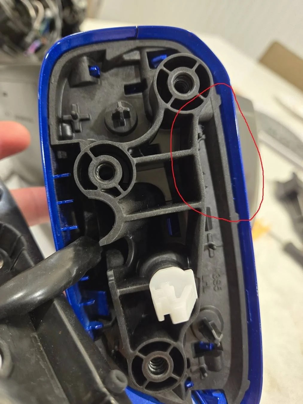

Practice on the Mikstore one first, that one has obvious holes where the trim tool should be used. Same spot can be used on Integra's colored trim

5. Have to remove all the electrical/friction tape, depin (take pics first!), before the last screw is exposed
6. The wiring for Kit F is a bit different, but the white/black wires go to the connector that's already on the door

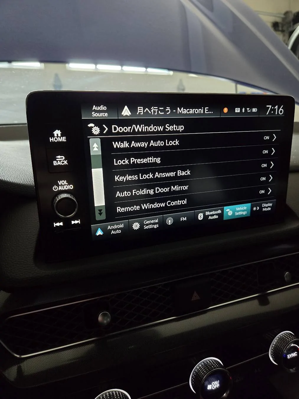

So I'm having this issue after the install where the car honks once when locking and twice when unlocking. Also, the hazards go off for 16 blinks when I open the door.. I'm wondering if this is due to the auto folding or the tilt on reverse.. ugh

Auto folding module. It comes.with instructions for disabling this

Here ya go

Omg thanks lmao. I thought I screwed something up. What's the "off lock" button? I turned the horn off but can't figure out how to turn the hazards off
