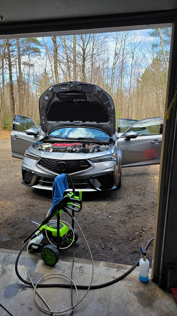

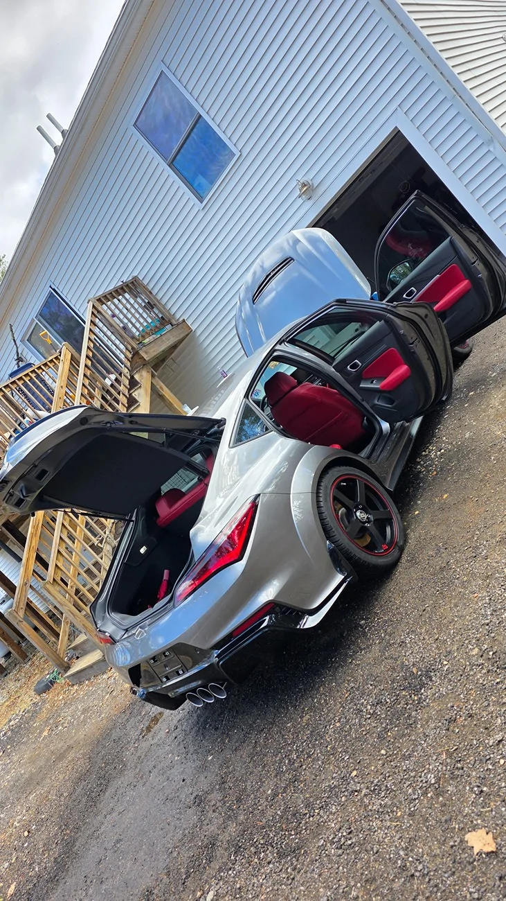

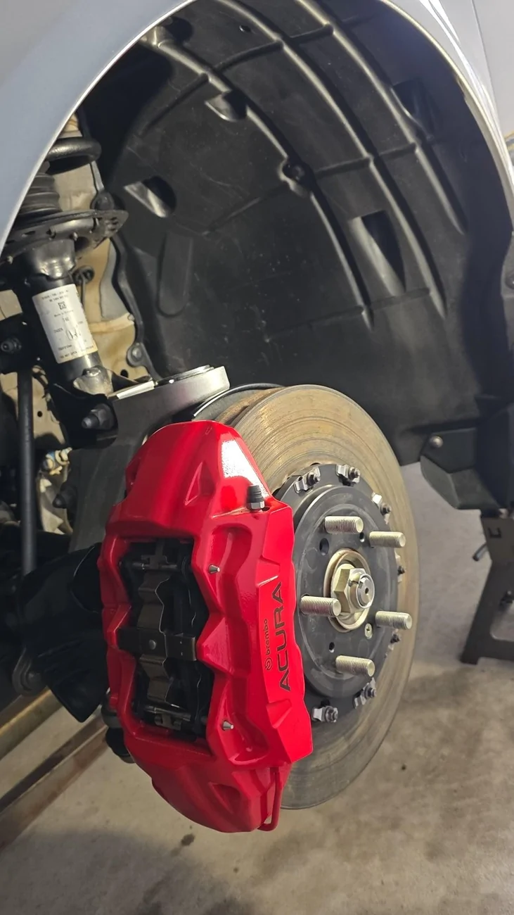

Spring cleaning removing all the winter crud. Another wheels off detail since I was swaping winter wheels and tires back to stock wheels and summer tires.
on a side note, whats this clutch adjustment i keep hearing about to help with the 1-2 shift grind?

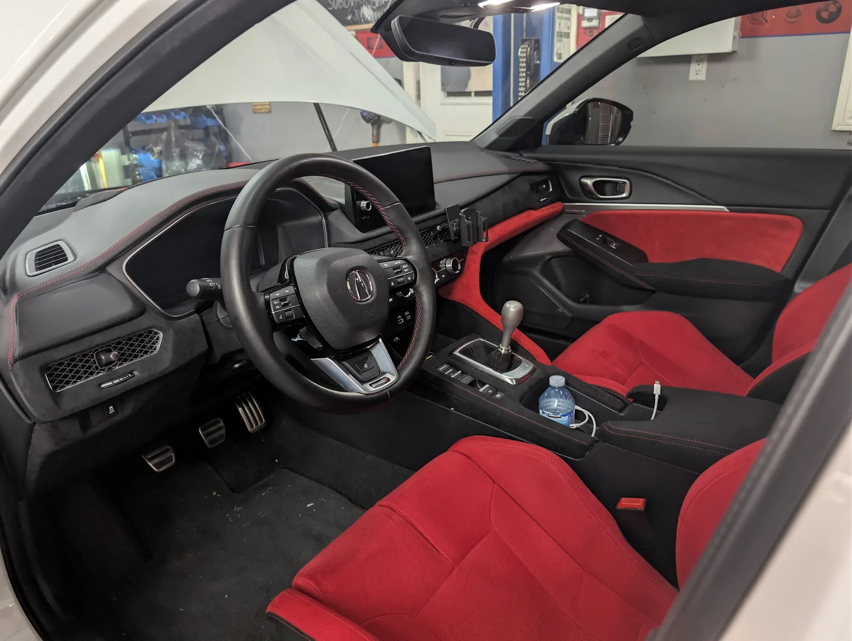

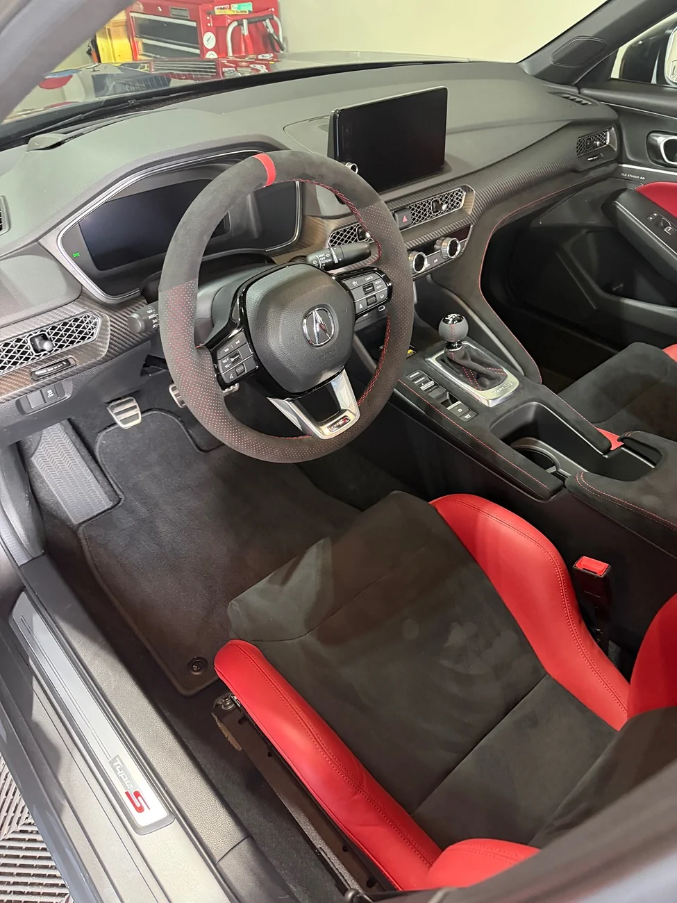

Are those fl5 seats? How easy or hard was it to get those installed?
I had them professionally installed by a Honda tech. Didn't seem too difficult though as the rails can be reused - just need a new DE5 harness per seat. Also need a way to reprogram the SRS/seat position sensor.
Took under 2 hours from start to finish.

Awesome! If you don't mind me asking, how much did it cost you?

I'm in Canada where FL5 numbers are already very limited, let alone the number of people willing to let go of their seats. I paid about $4k CAD for the seats and harnesses. You can probably do better in the US.

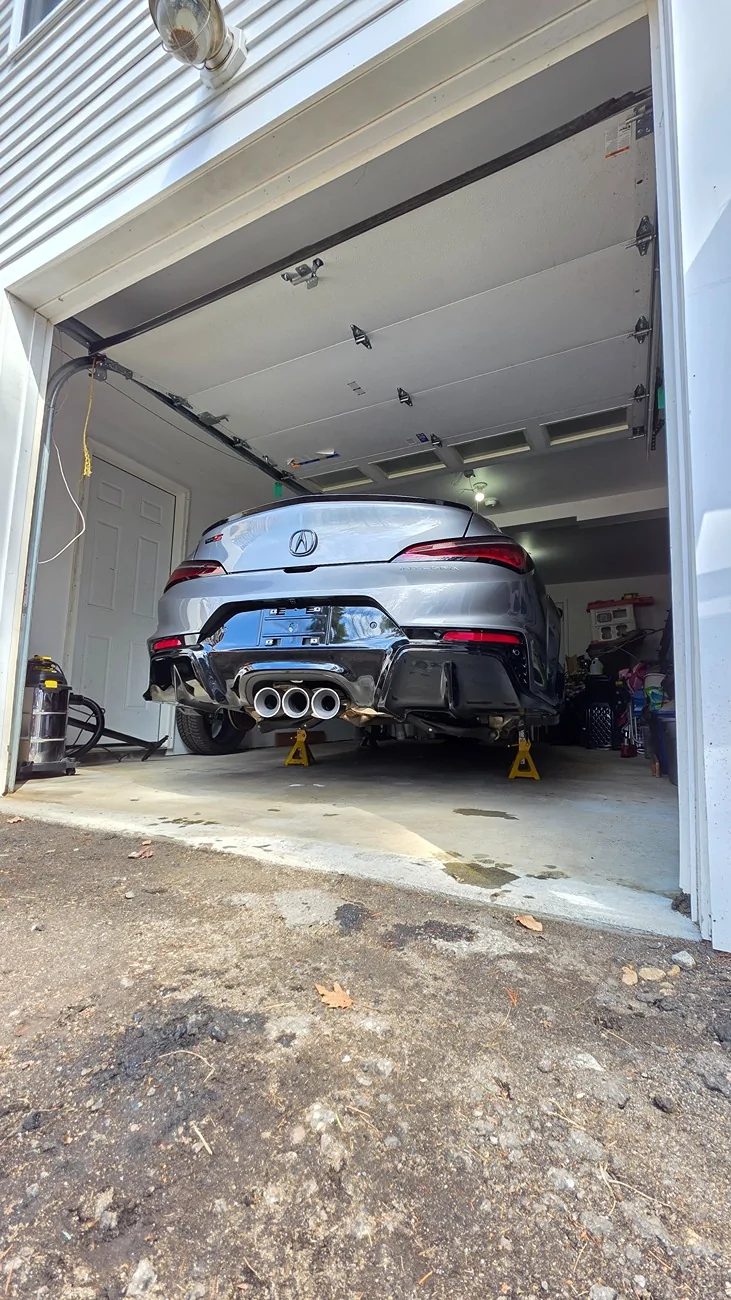

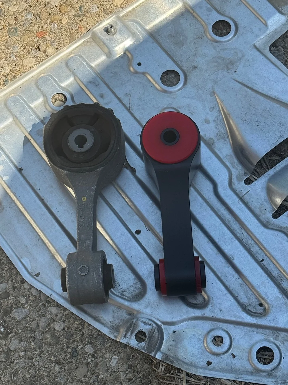

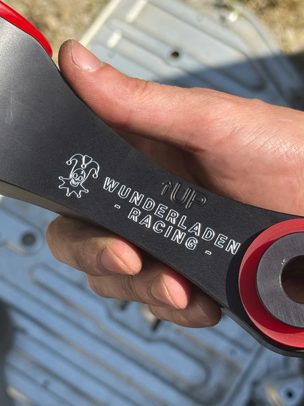

Had some free time and got the RMM knocked out. Getting the car in the air in my backyard took longer than actually swapping the RMM (ramps, jack, jack stands). I can see why folks that have a front pipe have more issues, though.
Did a quick “around the block” shakedown and the difference is noticeable. Very slight increase in NVH, but the 1-2 shift was smoother and the hook up was immediate.

It’s a must do mod for sure 👍🏼
