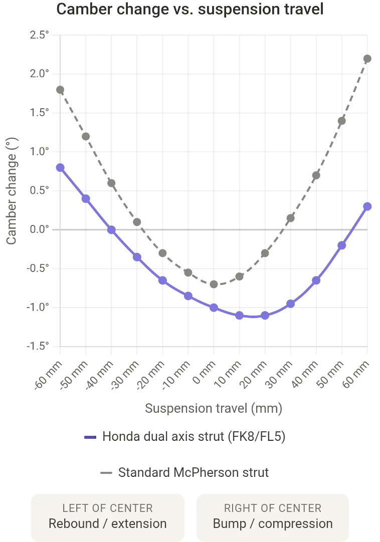

That's correct that the dual axis design does gain some negative camber under compression, to a point. There's a range where it starts to gain positive again. That range is higher up than a traditional mcstrut.
Your camber should be based on the tire your run and your wear. If tire a grips at 1g laterally but tire b grips 20% harder to deliver 1.2g, tire b would need more neg camber since the chassis is being stressed harder and rolling more (if you're using it).
For the oem ps4s that are both a stiff sidewall for street and too soft for track, the factory alignment range is correct.
Also, I had Claude draw a camber curve for each to illustrate. 0mm on x axis is where we start. Going 20mm right (compressing) you can see we gain and then start to lose negative. This is also precisely why lowering the car increases some neg camber, but loading up makes it feel more understeery than stock).

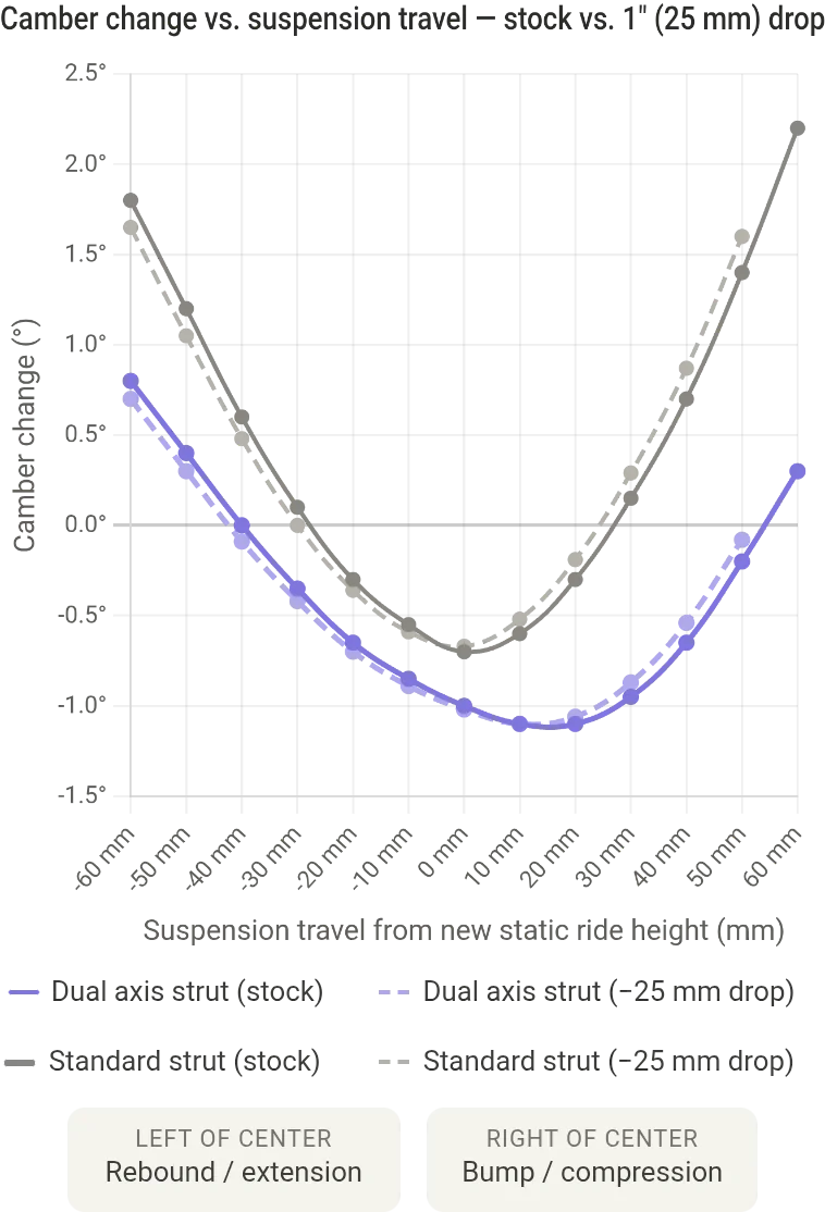

Edit: and yes, this means ANY lowering is a performance detractor without doing other things to correct the negative impact. If you lower 1", you've effectively eliminated the biggest benefit that this design has over standard mcstrut.
This is just fun now... I had it add what happens when you drop an inch 😅
Acura Integra What did you do to your Integra Type S today? 🙋🏻‍♂️ 1775400688791-5k
The Honda version does survive a drop better than a standard mcstrut!! That is quite an admirable feat given then context of how it's packaged.
