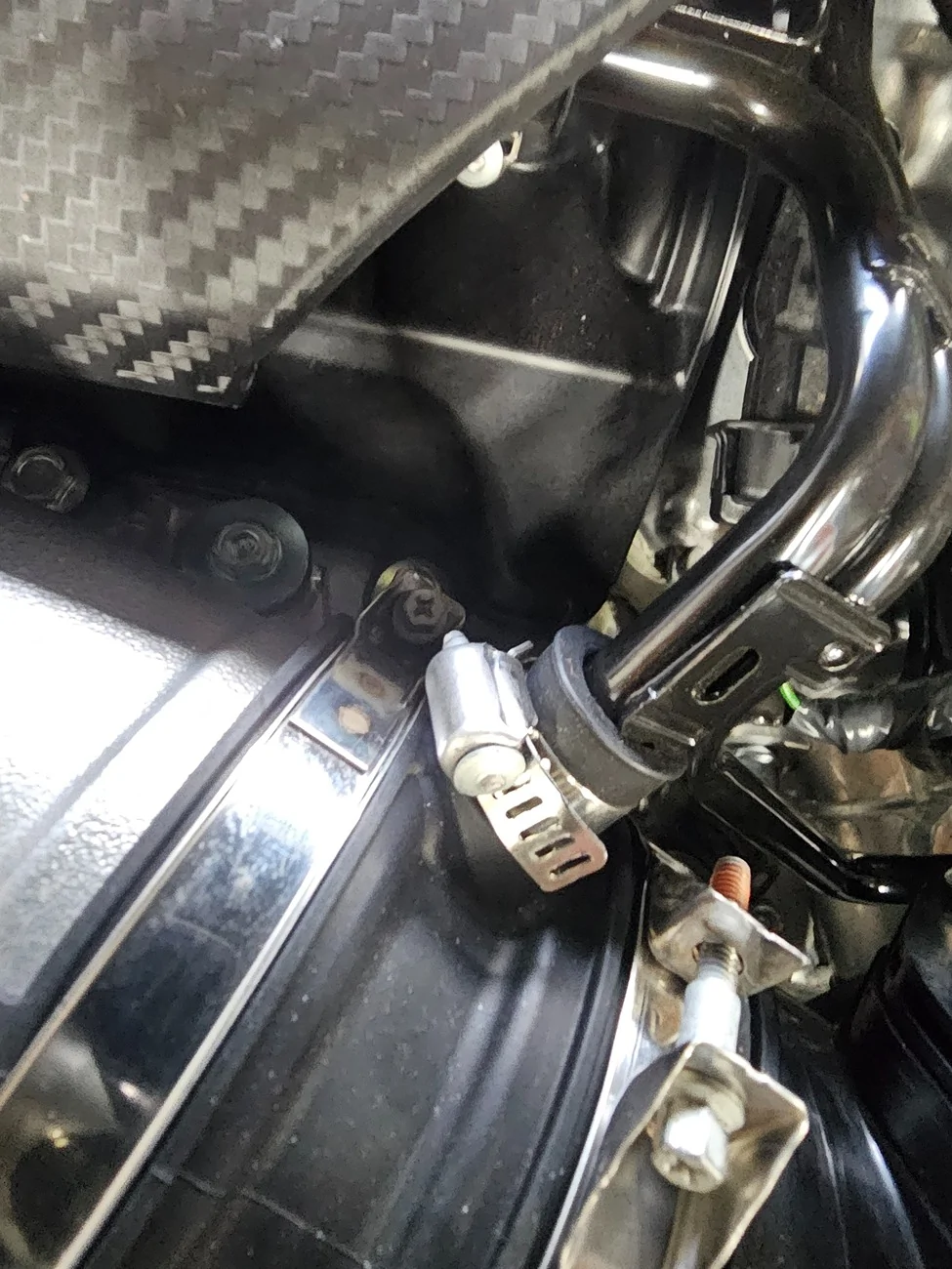

Shoot out to HARDMotion for the delivery of my new PRL intake. Install was a breeze BUT did have an issue with this particular bolt/screw..how do you take it off out?! I ended up wiggling it out but still took forever
For some dumb reason, Honda decided that one needs to be permanently secured. Folks either wiggle it off like you did, or cut the m'fer. Hopefully the PRL kit comes with its own replacement.
I think I just used pliers to grab and turn when I installed my PRL intake...

Yeah same
Pliers kept turning. I did the wiggle technique. At first it didnt seem like it'll come off but eventually it did. I even had a hard turn taking one of the oem couplers off. Those tiny philips screw kept stripping and i didnt have the .5 size socket!
