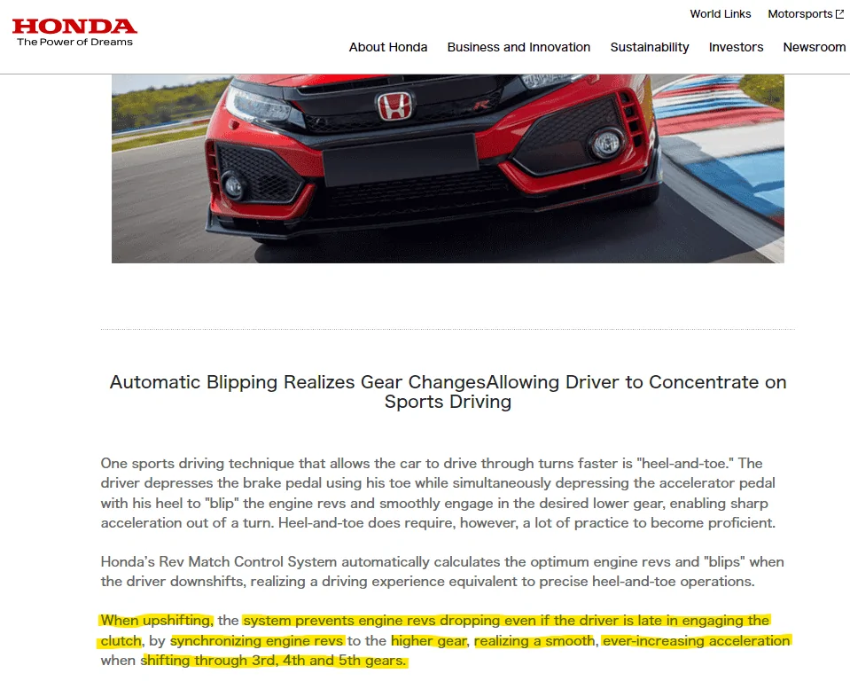

did some digging last month and the Rev Hang is indeed a Honda design feature:
When going WOT for max acceleration older manuals has jerky shifts running up the gears. When smooth shifting is needed the driver has to wait for revs to fall. Honda designed around this with Rev-hang during hard acceleration.
ECU also programmed to close throttle slowly for emissions so it has to be removed with a tune or you’d need to delete clutch delay valve.
I’ve had to learn how to shift the way the car wants to shift instead of what I’m used to. Been solid so far.
traditionally timing is the important skill needed when upshifting and downshifting. Timing is less important for new drivers with Rev-matching and Rev Hang. For more seasoned drivers trying to shift quickly the rpm isn’t going to drop fast enough for smooth shifts, you’d certainly have jerky action. At the same time hard acceleration while smooth shifting waiting for revs to fall makes us “slow”.
Honda rev-match/hàng is supposed to alleviate that. Also helps novice drivers or those who shift slow. That’s why R+/Sport+ needs direct immediate shifting versus comfort mode with different response for less shock shifting.
You can adjust by not having the clutch pedal fully depressed to deactivate Rev-match/hang or just delete clutch delay valve all together If you like short throw quick shifts. But CTR/ITS was designed to bring people back to manual driving without advanced foot skills and precise timing. It’s truly an art form and I admire those who have mastered it
