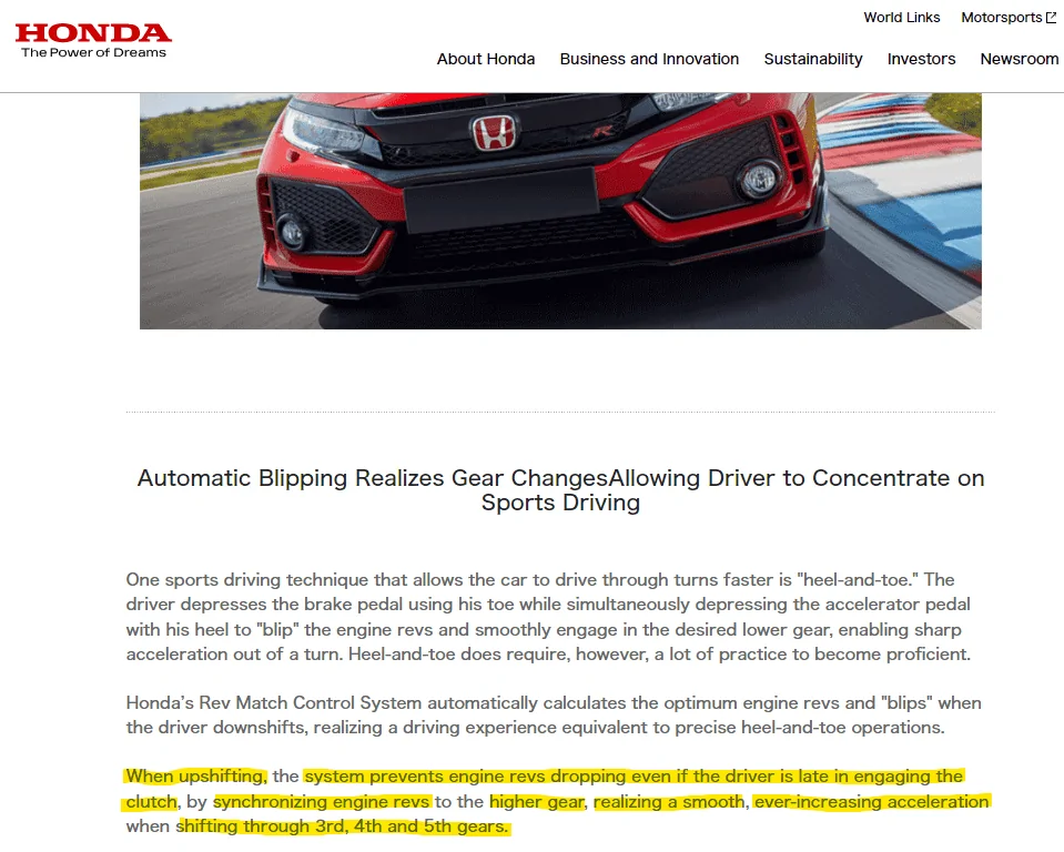

Acura Integra Auto Rev Match Interfering with Upshifts Revmatch-down-u
This is supposed to be more helpful to newbie drivers or those who shift slow but it is supposed to be active upshifting through 3rd, 4th and 5th gears.

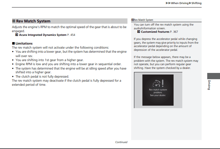

The clutch engagement point on the ITS is quite high, but if you're wanting to disable the Rev matching there are three ways: 1. Disable it in headunit. 2. not fully depressing clutch pedal 3. Fully depress clutch pedal for about a second.
Acura Integra Auto Rev Match Interfering with Upshifts RevMatch System
