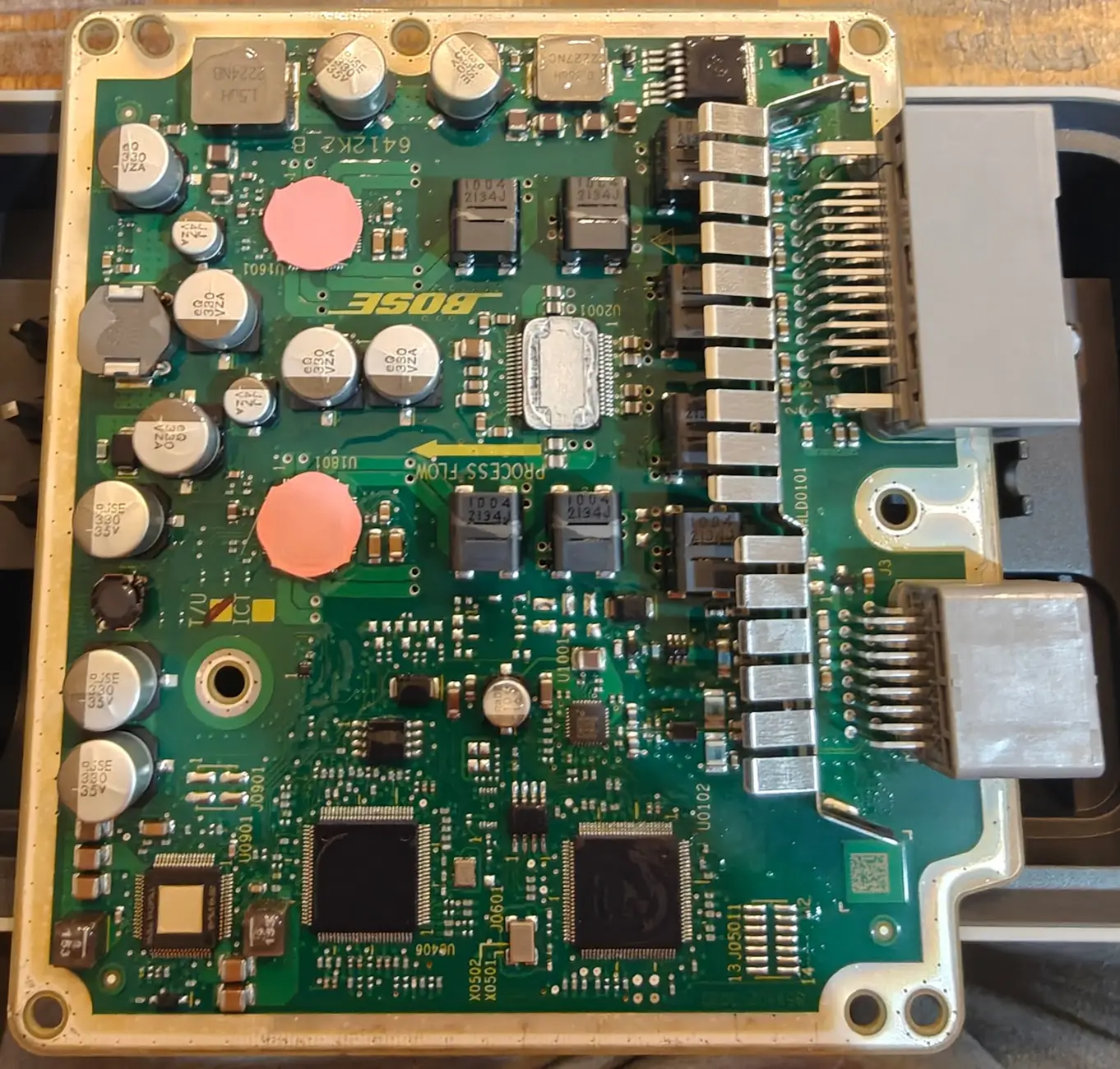

I'm curious - who here would be interested in a complete T harness for full system integration (specifically analog speaker level input, not pure digital conversion like I'm doing)? This harness would enable intercepting every independent OEM channel into your DSP/amplifier.
Building the harness is a pretty involved procedure since the output plug on the ELS amplifier is so new that there is only a board-mount connector available, rather than the much easier to assemble cable-style plug.

Sorry for the slow response - I've been manufacturing harnesses for a large distributor order all weekend. Regrettably, I no longer have analog T-harnesses on my pipeline as I need to focus all my R&D energy into next-gen digital integration (which includes your 2026 Si).
Sorry for the bad news - the upside is that by September I will be fully focused on the A2B integration R&D once I get these orders processed. I have purchased some of the proprietary technology needed to reverse-engineer Honda's protocol and hope to be doing prototype testing by mid-Fall.
