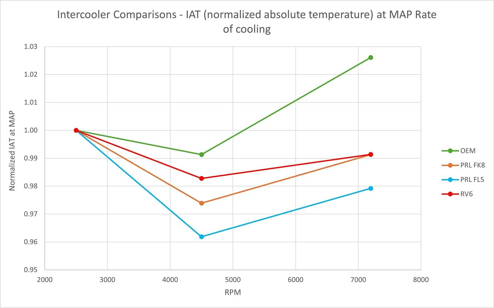

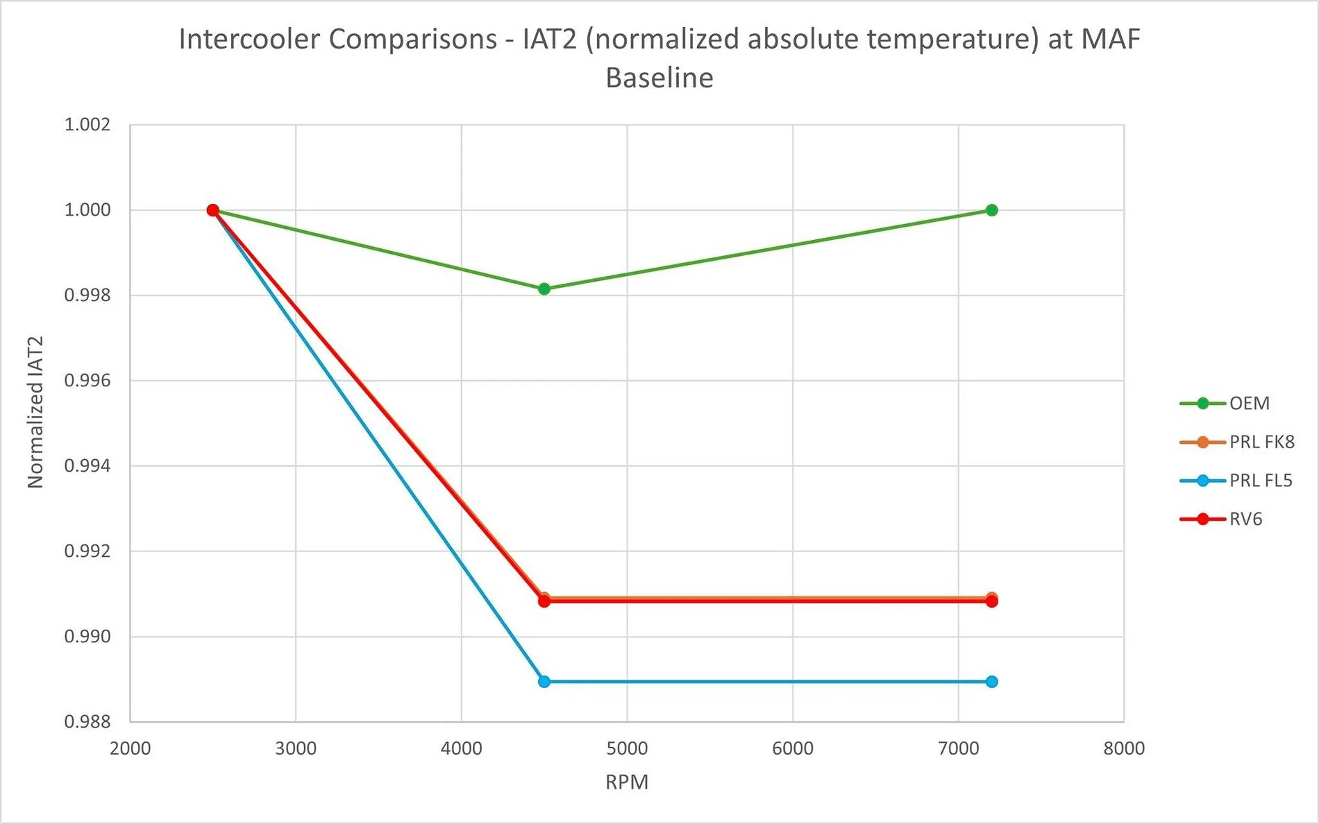

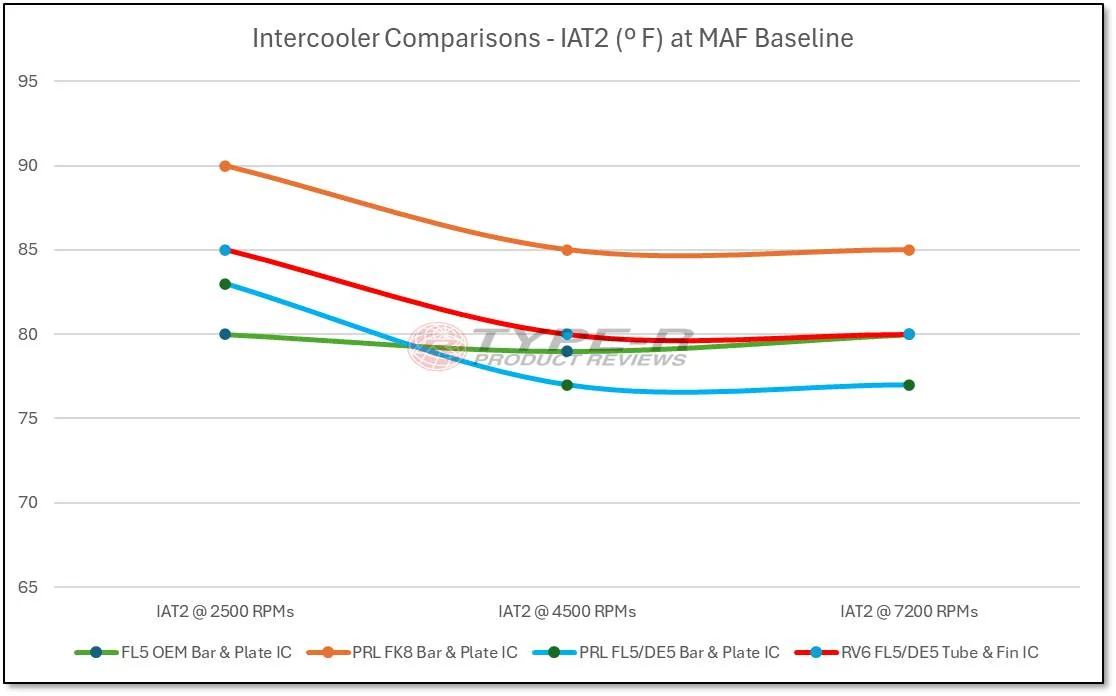

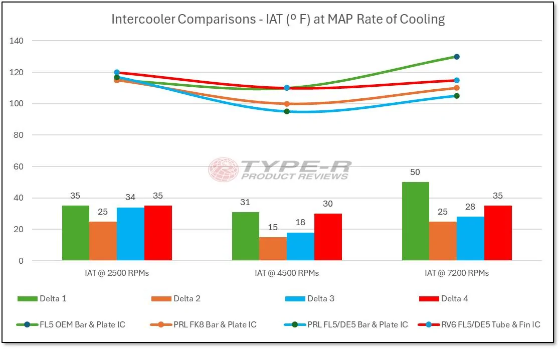

This thread reminded me of a post I saw a while back from the "Honda Type R Product Reviews" FB page. It's a private group I think, so I can't really post a useful link to it, but they posted some interesting data from their test car with an RV660 running like 500whp+ with different intercoolers. I normalized the data they posted since I think that is a bit more useful for comparisons. The RV6 IC is seemingly a pretty good tube and fin upgrade, but the PRL IC performs better in this test. Though that page noted that the trend as more back-to-back WOT 4th gears are performed, eventually on track the RV6 IC ends up being a little bit better. You can see the gradient change toward the upper rev range that looks like it would lead to the RV6 performing better like they said. Personally don't think this is a strong argument for one being significantly better than the other though.
Test conditions:
The data shown is from many 4th gear pulls over many hours and consolidated. What we are seeing are as follows:
• Ambient temp of 45F
• IAT2/MAF of 65F flat
• IAT/MAP 90-80-105F
• Delta 25-15-40F
TPR charts:
Acura Integra Intercoolers for DE5 480796144_625789303742029_4697275900310642379_n
Acura Integra Intercoolers for DE5 481104297_625789373742022_8475831966474274312_n
Normalized results, lower IAT is better:
Acura Integra Intercoolers for DE5 514106133_10010223975712343_965865483235607069_n
Acura Integra Intercoolers for DE5 513913603_10010223989045675_7771056673010174089_n
