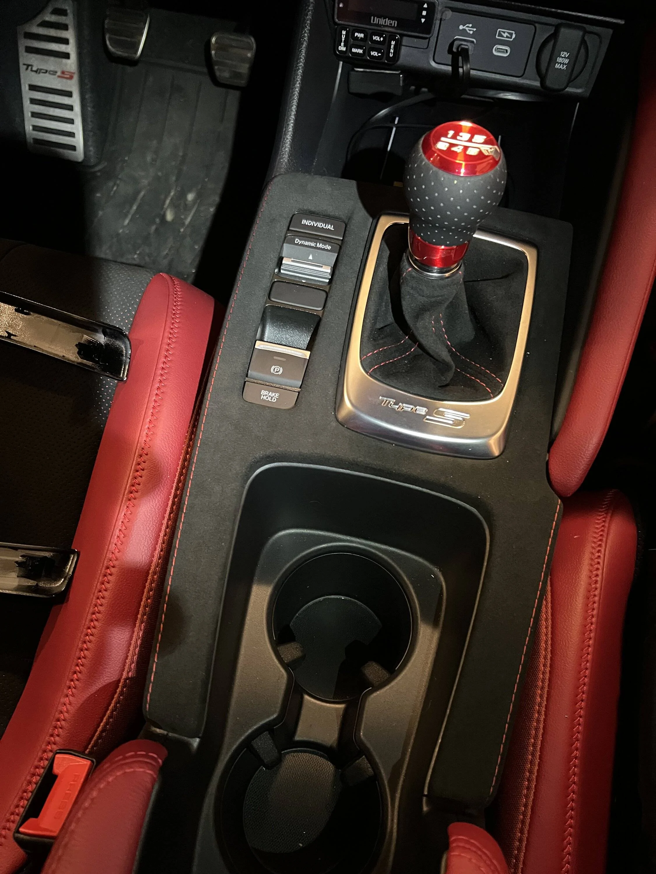

Just installed mine tonight and some of those clips are stiff as heck and was worried to break them. Looks great and no more fingerprints.

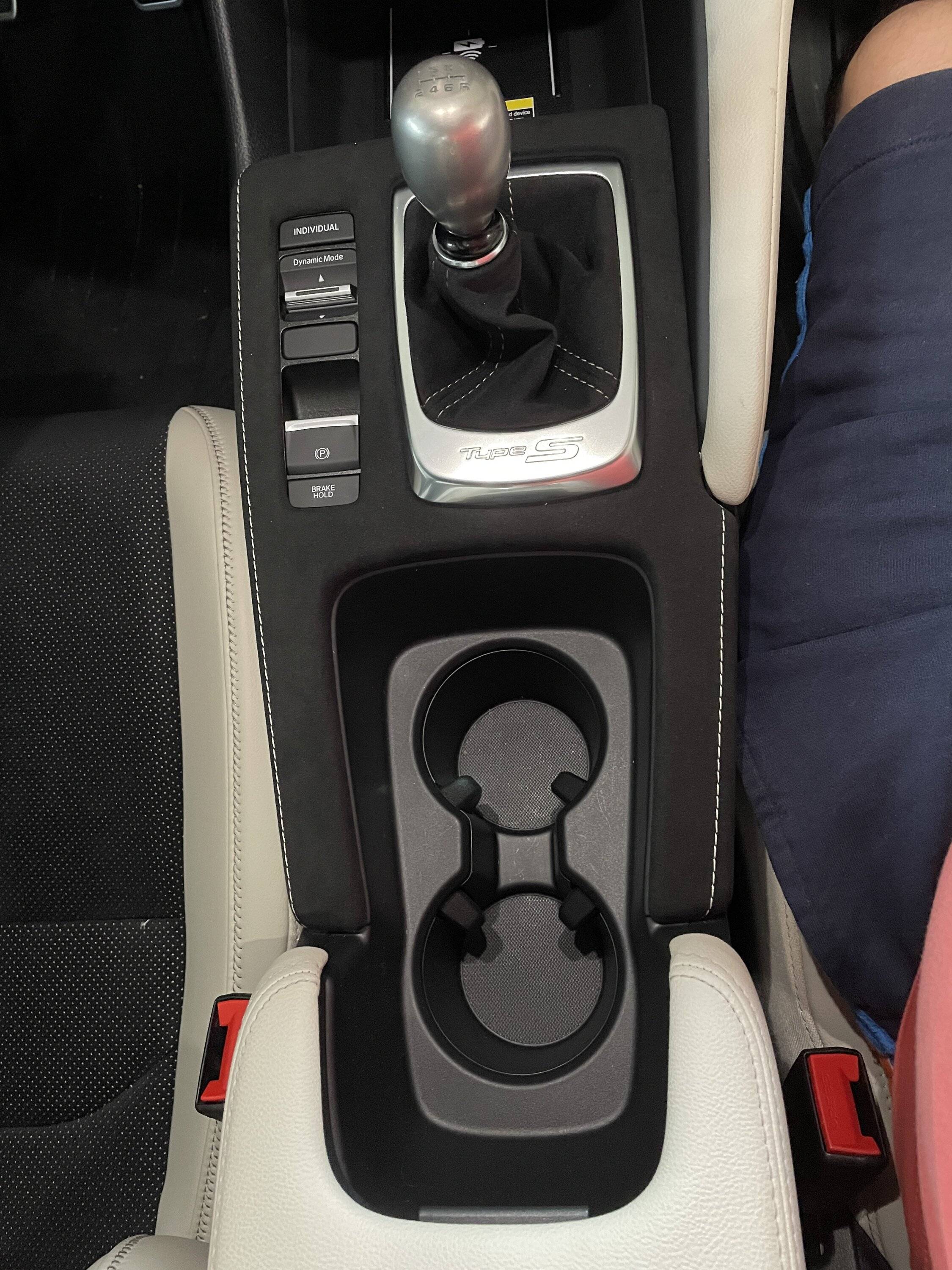

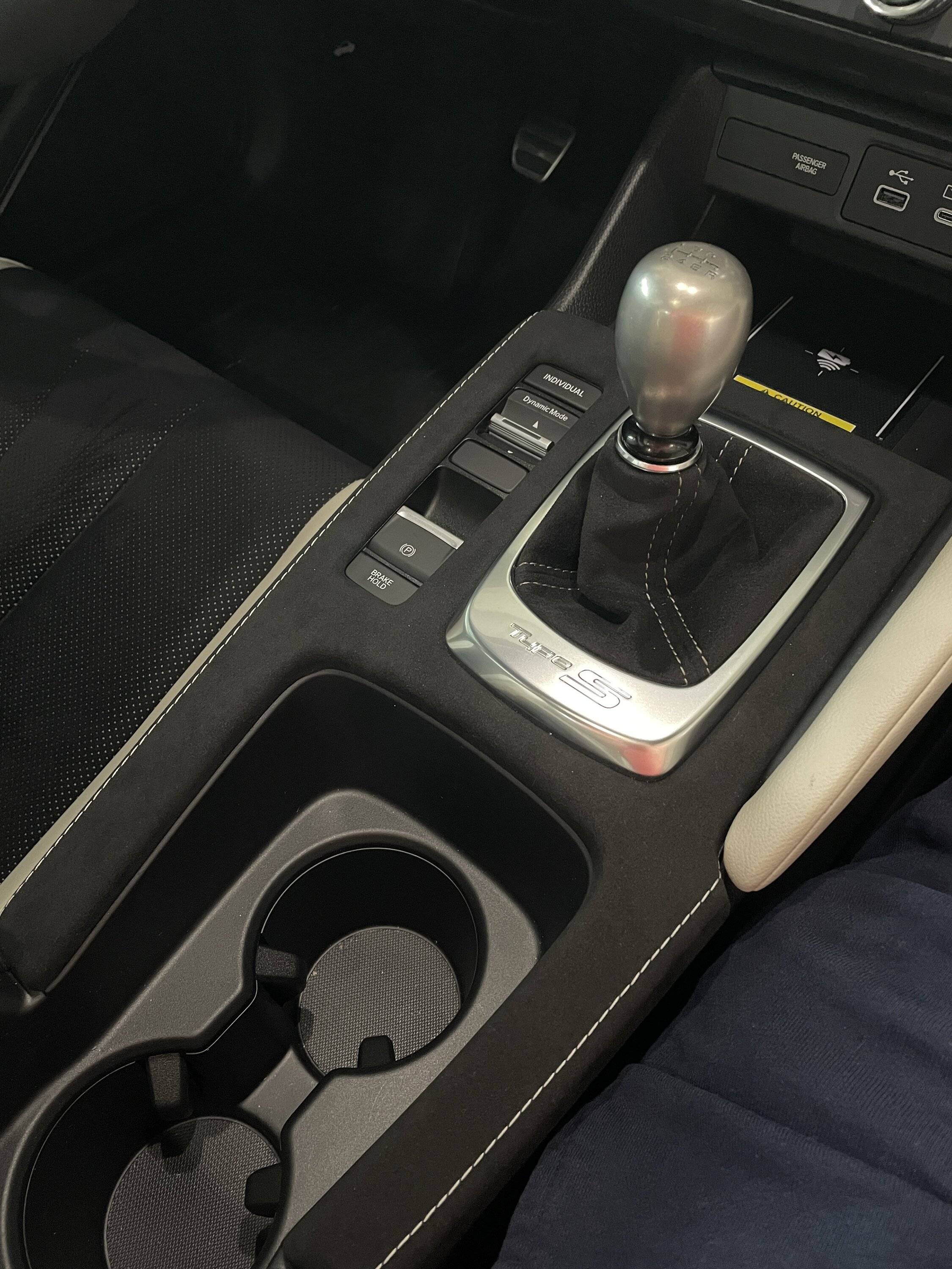

I know personally this is a popular topic but with little information available (at least I couldn't find any) so I'm hoping to contribute to the community.
This is the Alcantara wrapped console I bought from Overland Designs:
https://overlanddesigns.com/products/type-s-console-cover
Disclaimer:
• I'm NOT an expert and used the best tools I had available to me. Take your time and be patient to avoid any broken clips.
• Also make sure to protect the rest of your interior from getting scratched.
• I'm open to suggestions regarding this process so feel free to chime in.
• I believe the process should be similar to all manual Integras from 2023-onwards.
Tools used:
• Phillips screwdriver
• Prying tool
• 15mm wrench (i think 14mm might be the exact size but 15mm worked for me)
• Tiny screwdriver (for poking that small plastic clip)
• A lot of patience

yo so i installed mine today, and that nut under the shift knob was totally fucked on mine. in your video you loosened it with a 15mm wrench then just unscrewed it with your fingers but mine was totally jammed up. i loosened it no problem but it was impossible to take off with fingers and i had to wrench it off the entire way, and it tore up the threads on the shift lever.
i was thinking they must have put thread locker on it for whatever reason as i was getting it off, but i didn't see any compound on the threading. it didn't look like it had been cross-threaded either so i don't know what the problem was.
it went back on much easier than it went off, but still required being wrenched the entire way, and then the shift knob (which unscrewed just fine with fingers) was a pain to screw on. it seriously killed my damn hand and forearm getting it back on lol.

Just installed mine today. The nut under the shift knob was a bitch to get off but I really really despise the tabs to get the covers off. But either way it took about half an hour and it looks a lot better. I’m sure it will help with glare too.

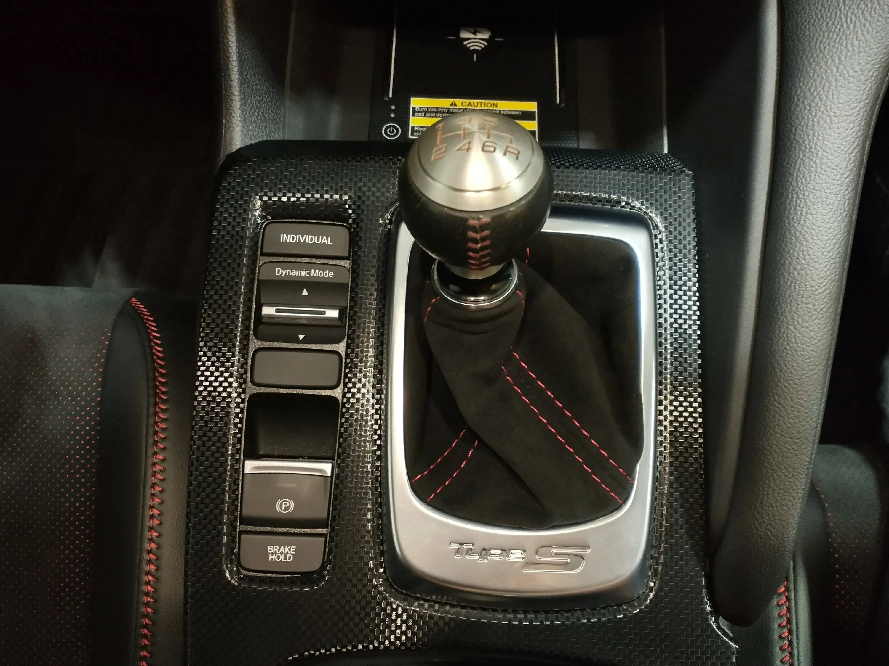

I wrapped mine today with some VViViD Square Black carbon fiber wrap. Also used the opportunity to swap on my Si shifter. The ITS one is nice but I got used to grabbing the whole shift knob and it just didn't feel right
hmm, I have some vinyl and a heat gun, I should give this a try, I also want to do this in my 350Z interior.
