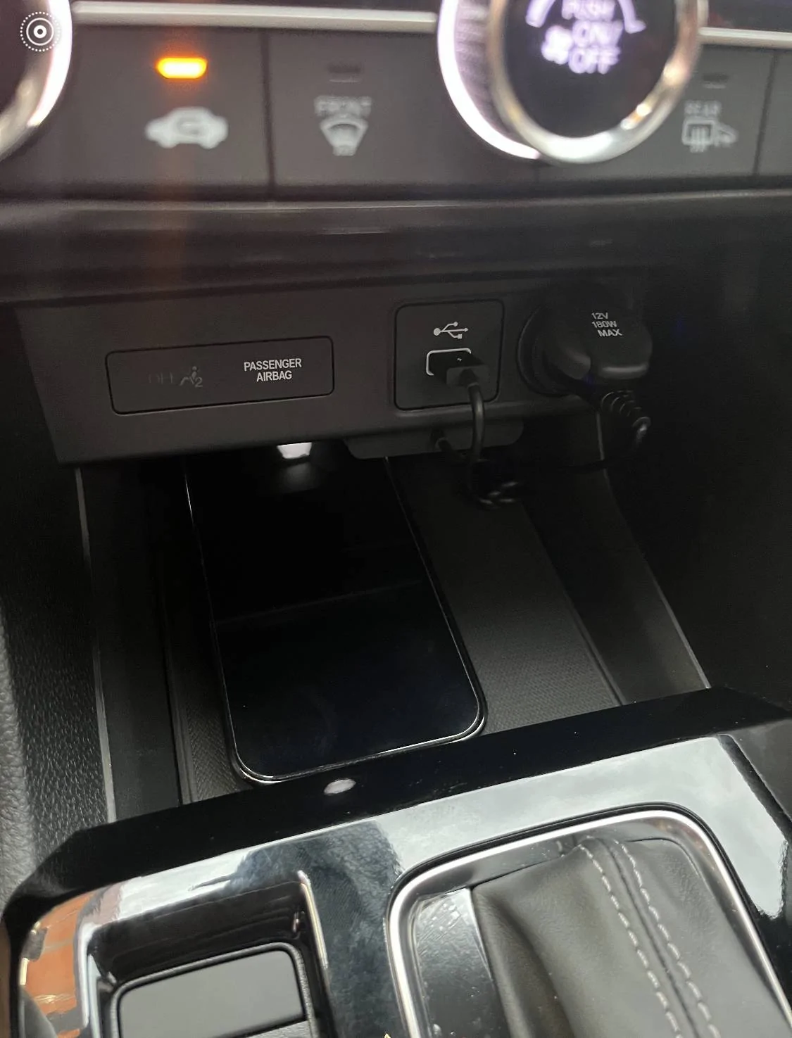

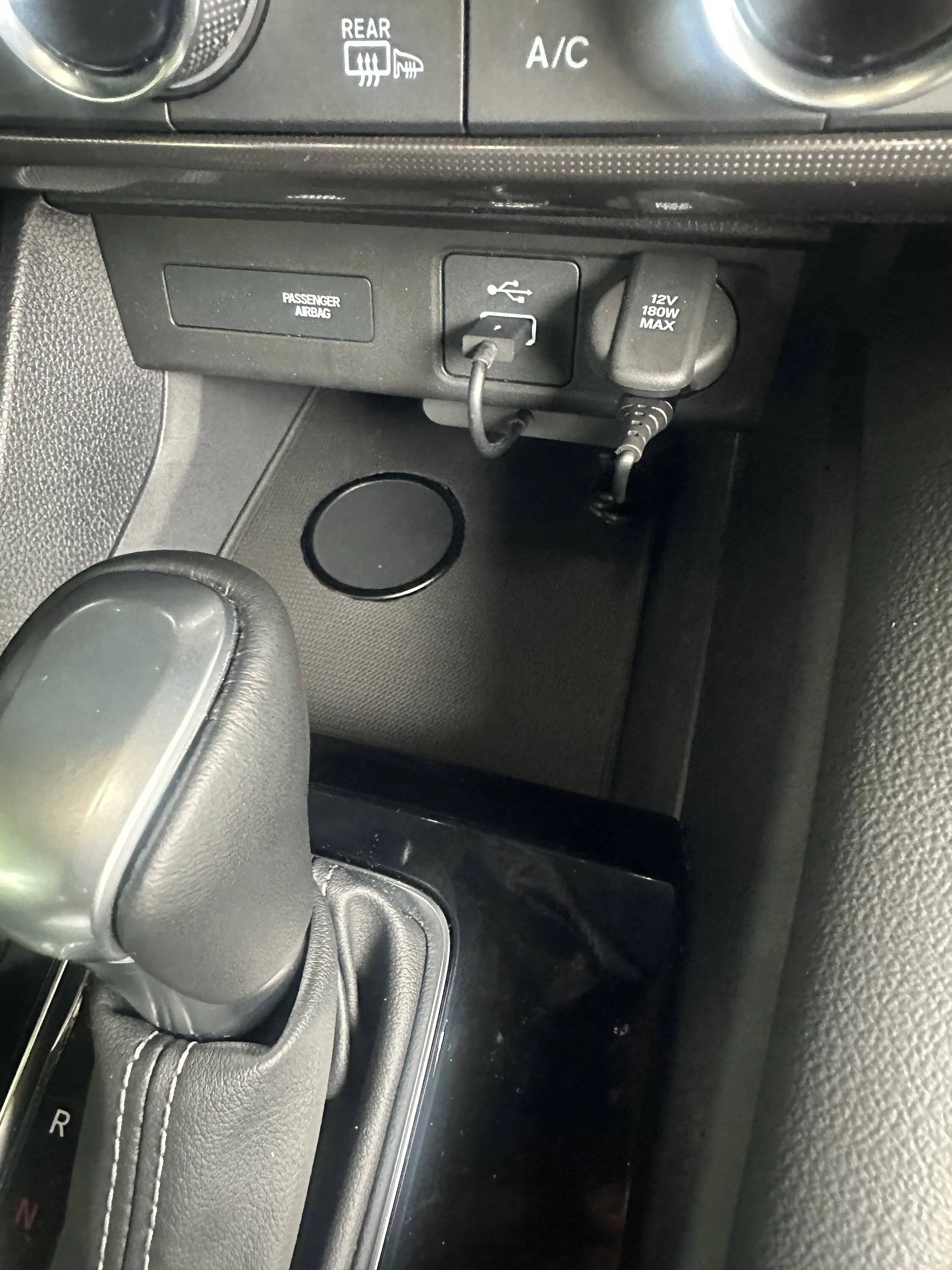

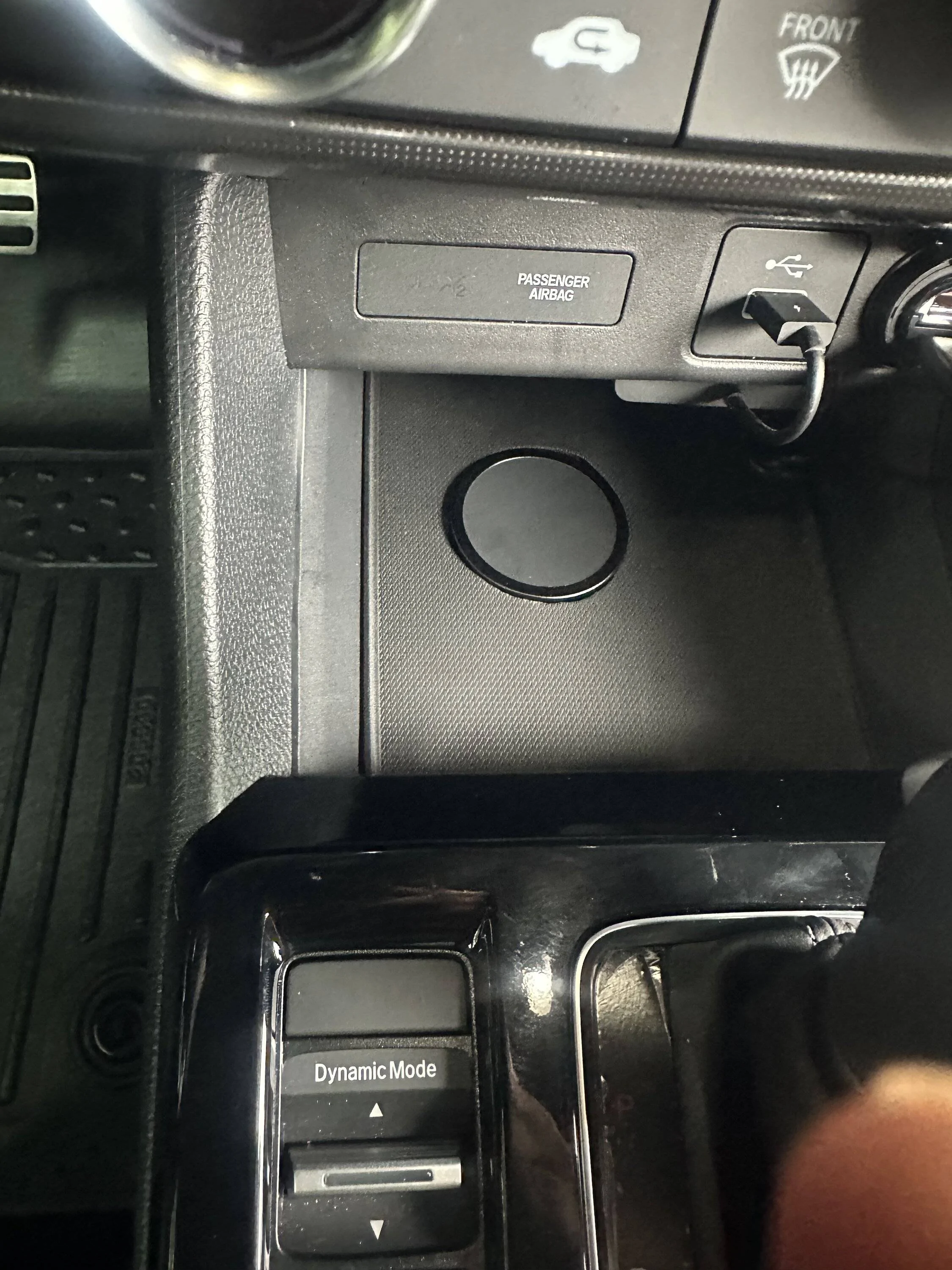

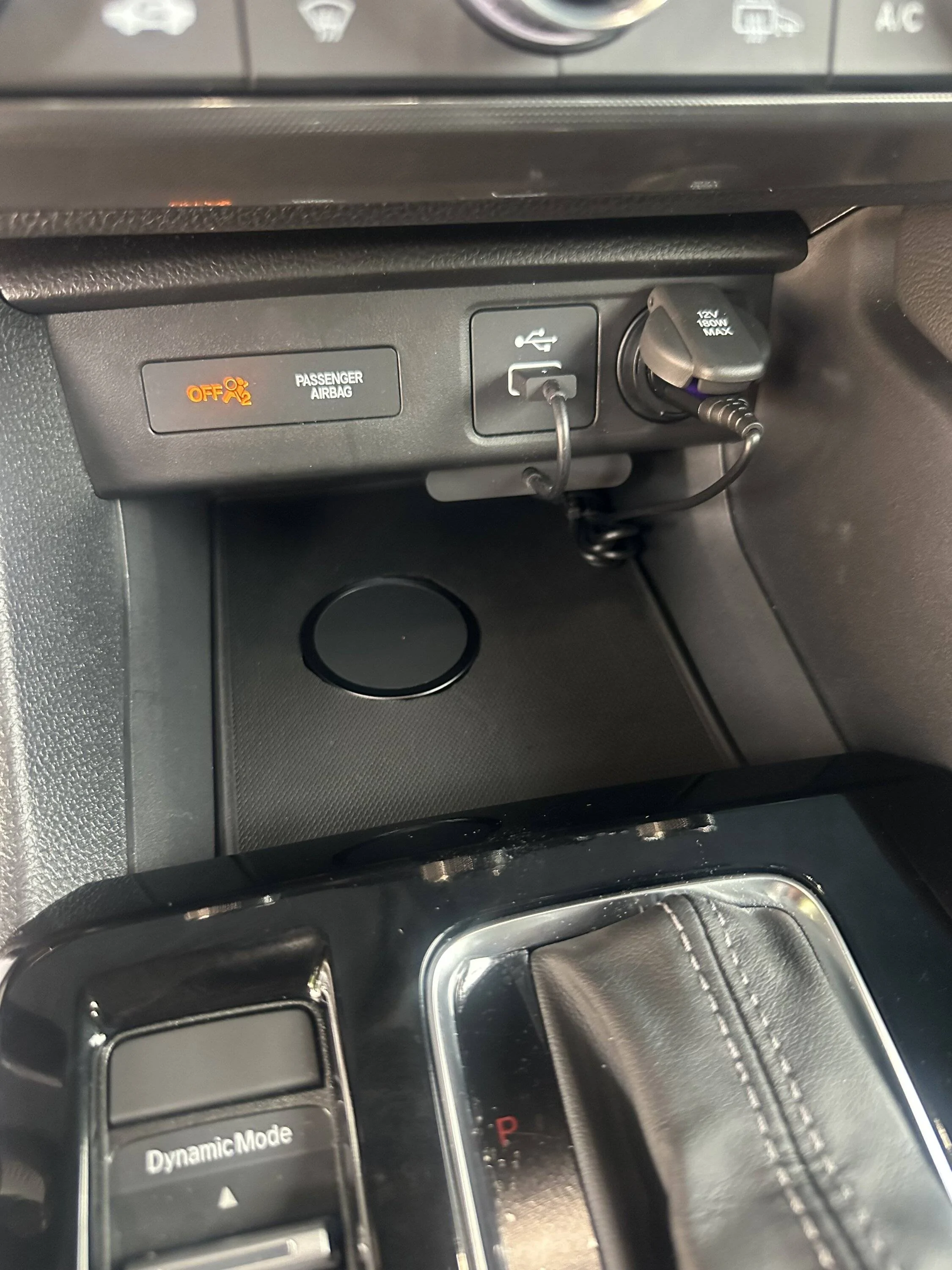

Hello friends, I was not fortunate enough to get an A Spec with Tech, so as many of you know, many of us don’t have all the bells and whistles.

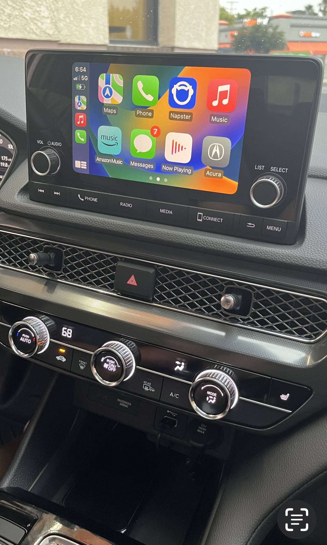

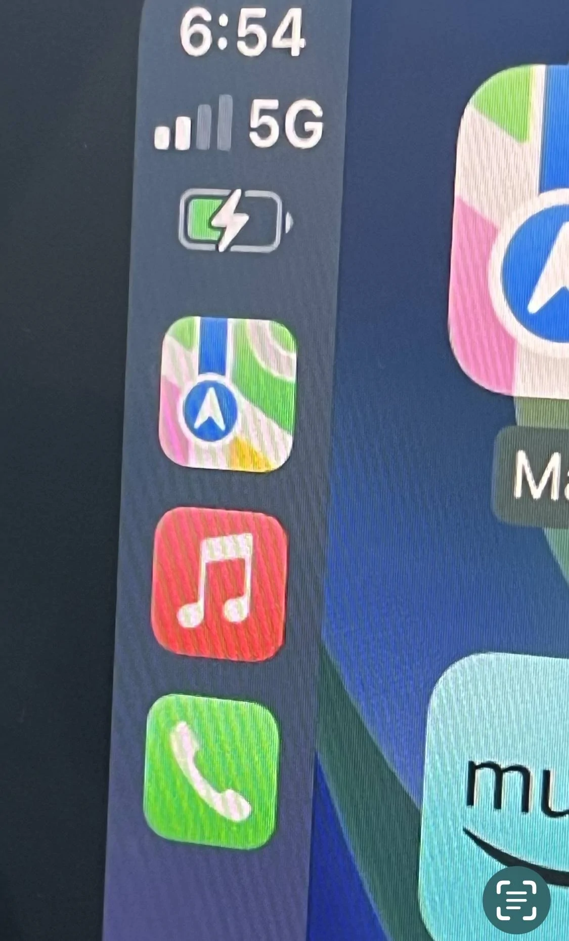

here is a charging pad project I did. I also have a wireless Applecarplay module.
You can buy all these items on eBay or Amazon. The entire build for the wireless Applecar play, and the charging pad and usb adapter was about $65.

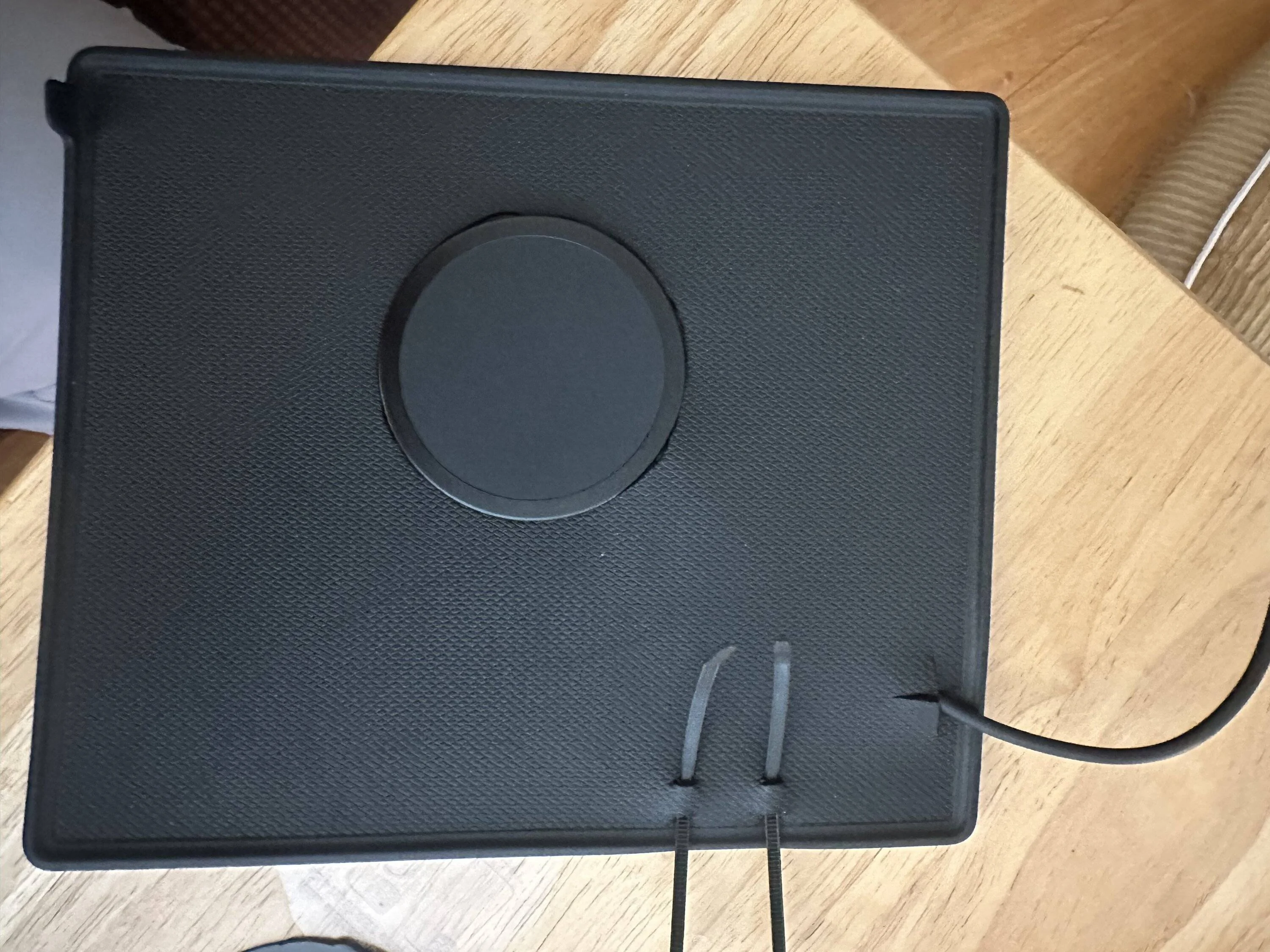

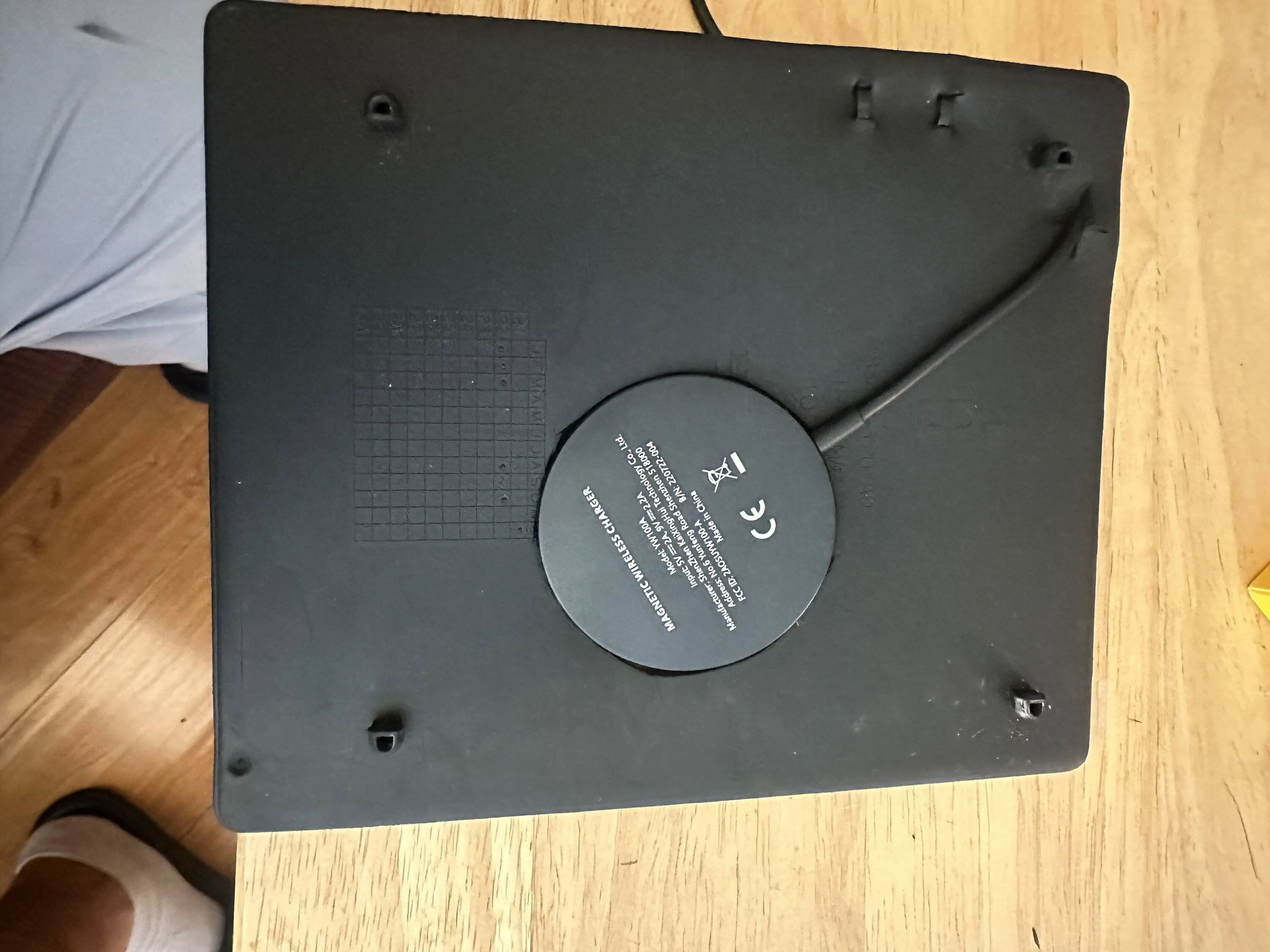

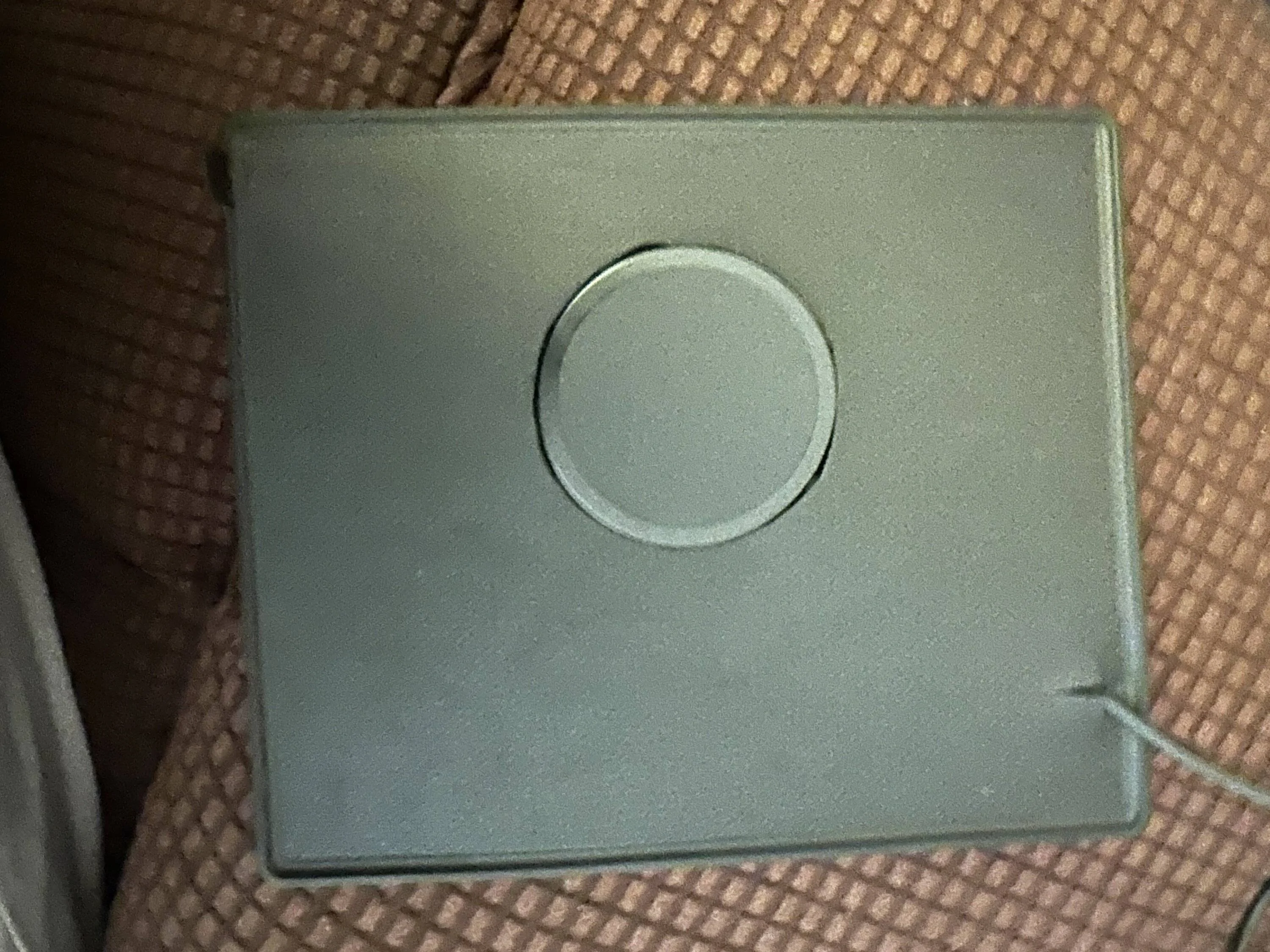

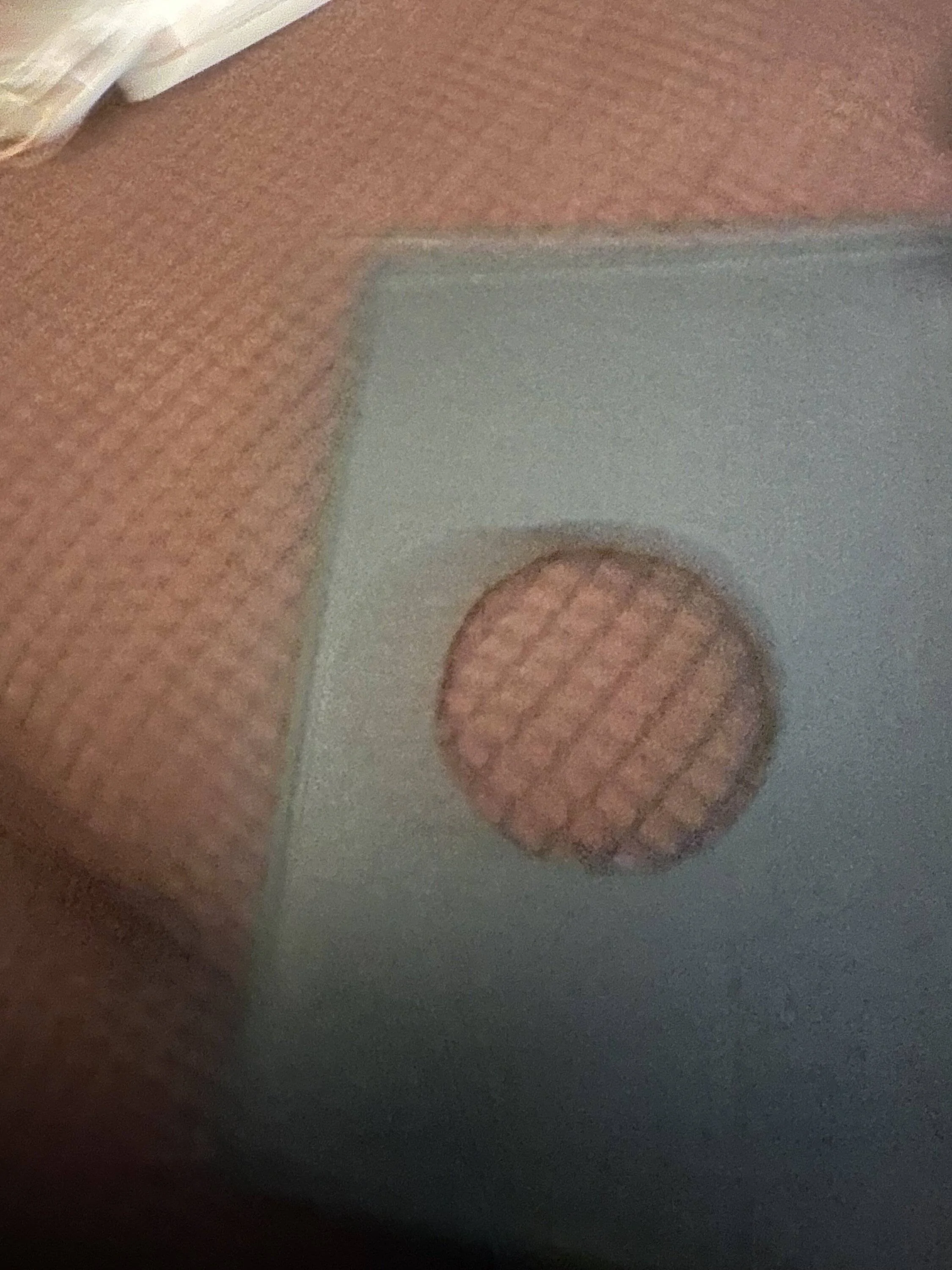

Step 1 remove pad and cut a round hole to match the size of your charging pad. I am using a MagSafe pad.

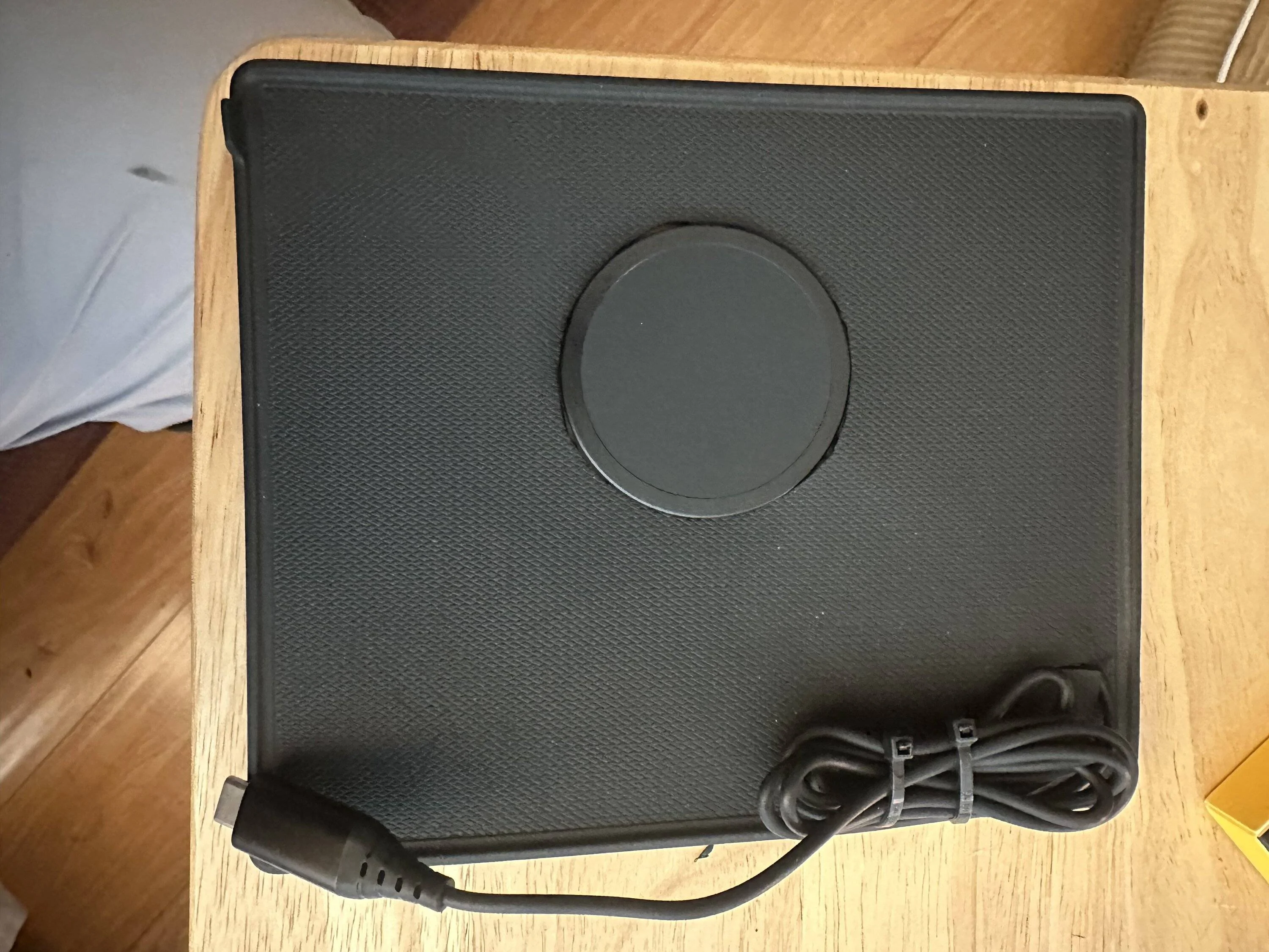

Step 2 cut an opening on the front left side of pad to pass the usb-c cable through.
Step 3 cut 4 slits through the pad and push 2 zip ties through.
Step 4 tightly warp your cable, leaving enough room for it to plug into the outlet.

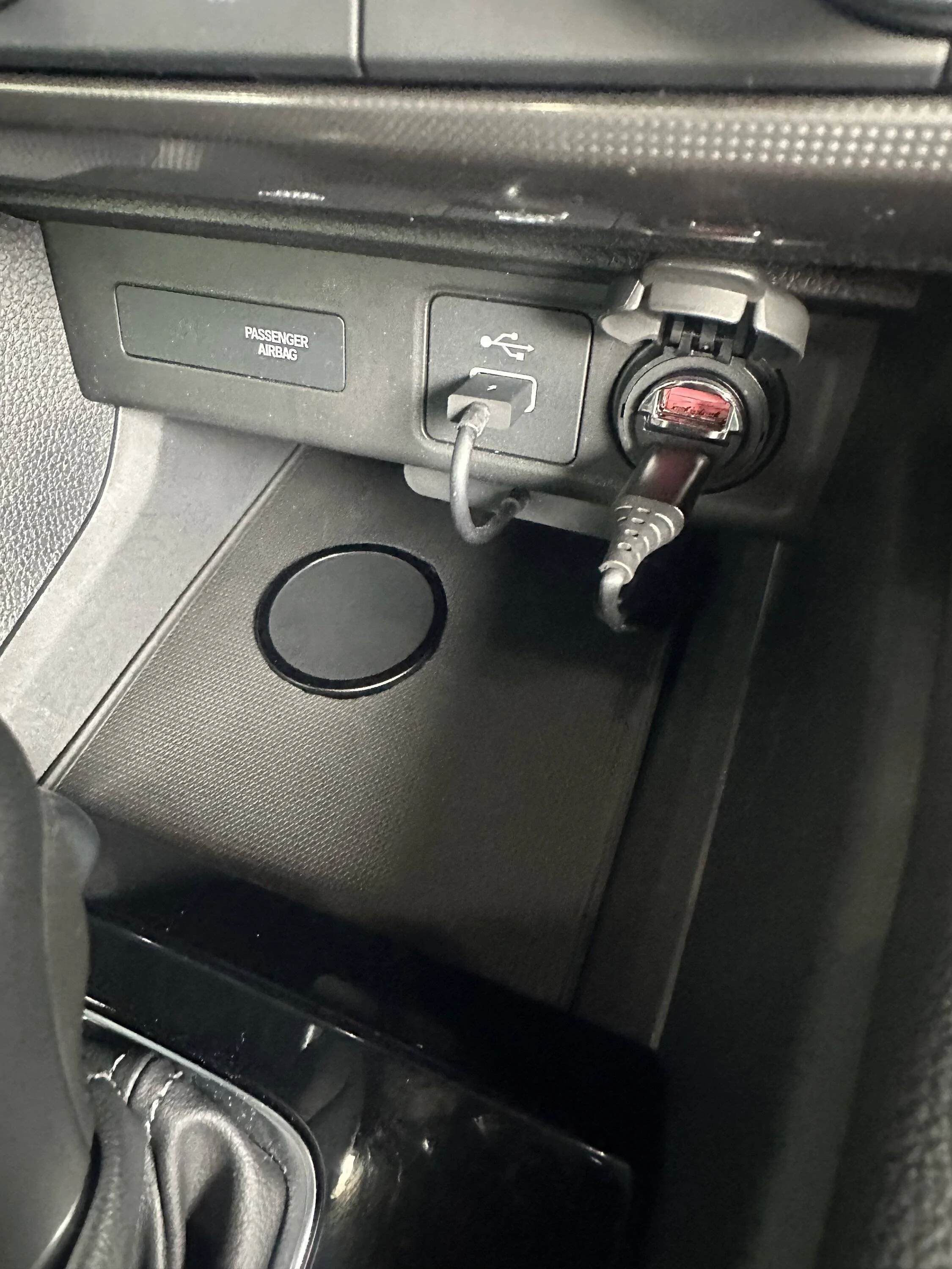

Step 5 plug into outlet, and your done.
good luck
