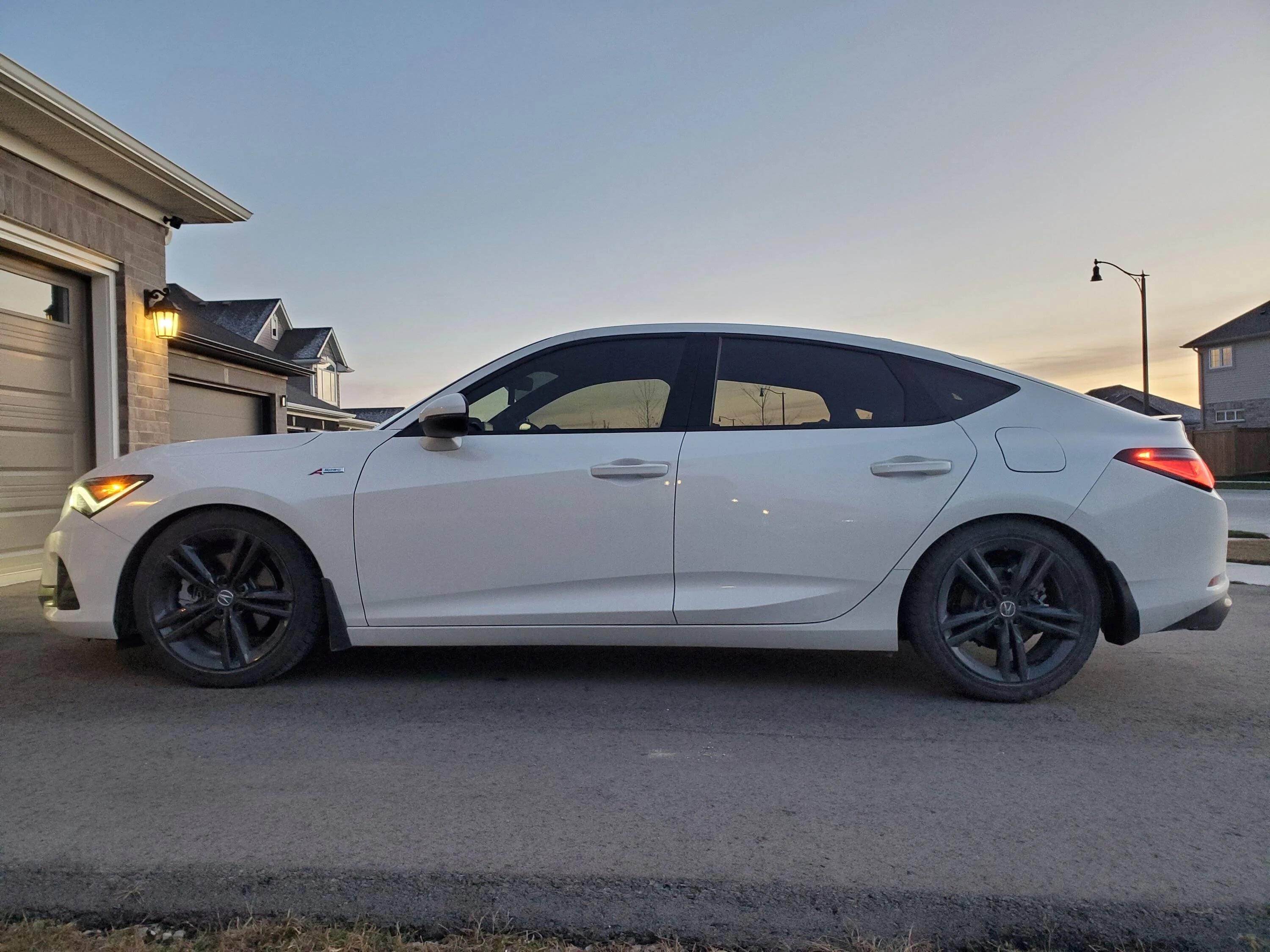

Installed my pro kit yesterday.
Quite happy with it. I will say it dropped more than the claimed 1.3" and 1". I personally wouldn't want it any lower. Almost no wheel gap. No regrets going with the pros over the sports.
Handling is great. Comparable to stock. I can feel the firmness on rougher roads and train tracks at highway speeds but not bad.
I won't do spacers with these wheels...this is my winter setup(canada). I have a new set of enkies for summer. 18×8.5 35 offset.

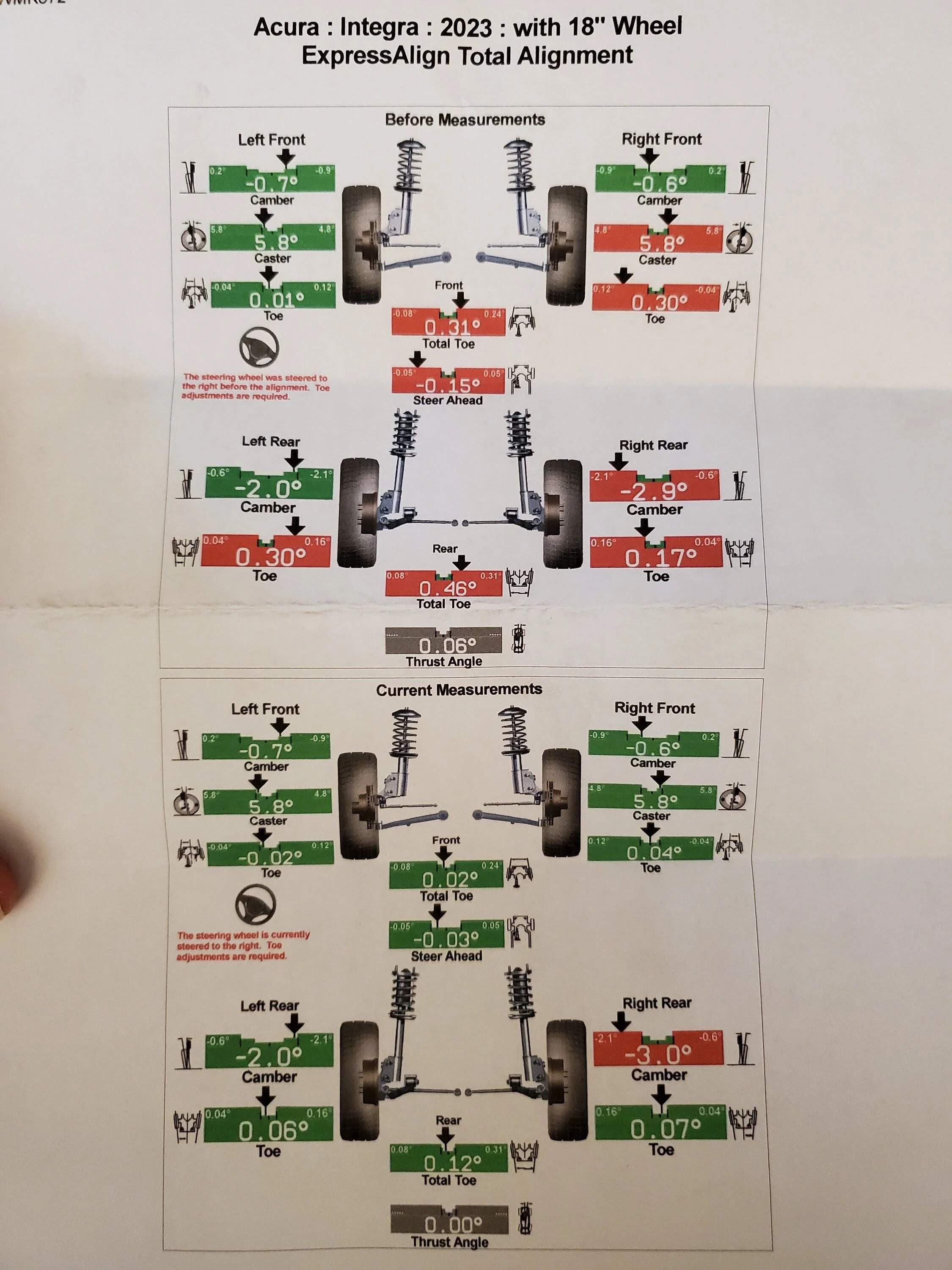

I'm calling tomorrow to book an alignment, I'll post the results. If it's bad, I'll go ahead and order a camber kit.
