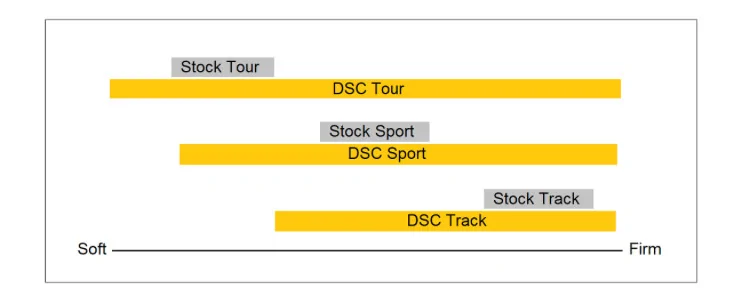

A sneak peek into our development process:

As you say here, it's something we have toyed with, but it is true, our goal is always to create a system in which tuning is possible but largely unnecessary. In fact, our founder created the concept of DSC controllers while racing early Porsches with active suspension and becoming quickly frustrated that to adapt to the track he would have to press buttons between suspension modes every few seconds. It completely ruined his control over the car. (And his timing). We always say that the most important primary difference between stock and our module is that we use significantly wider ranges in each mode. There is overlap, yes, but that's because you don't really want to switch between modes all the time. Isn't it better if one mode can handle a much larger variety of conditions?
The controller responds in what is effectively real time (minute fractions of a second) to things like steering angle and g force. A good tune has values for every possible combination. If, for example, you tend to drive on tough roads, maybe you'd like a slightly more pliant suspension in comfort mode, so you turn the minimum values a little lower. Now, every time you hit a pothole, the car will react. No need to switch modes from one road to the next.
The OEM modules work by showing you a difference as soon as you press the button. Our module, instead, responds to a change in one of the inputs. If you change modes while driving fairly normally in a straight line, you won't feel a difference. This is on purpose, because it allows for a more uniform experience between modes (and, again, we don't really want you to have to switch modes very often)
TLDR: The owner of DSC designed the controller because he felt that active suspension was not responsive enough on the racetrack, and he was hampered by trying to tune on the fly by switching modes. The DSC solves that problem in a few ways!
Acura Integra DSC Sport Suspension Module for our cars! IMG_7514 (2)

The chart really helps me to makes sense of the module and I feel a large majority of users are probably not fine tuning their settings anyway. The question comes a genuine concern for those that do want to dabble and don't necessarily want to drive with their interior apart while they dial in their suspension. Though I can see having a laptop beside you as you drive around and dial in your settings would be just as effective as a separate app or controller.
Either way I'm excited/curious about the module and how it'll affect the ride. My limited understanding is that factory is just a passive soft/firm/stiff but the new module is an active/reactive nature. The behavior at each drive mode looks like it's limiting the difference between soft/firm at each setting. Comfort means we'll have access to the full range of the suspension's capabilities, sport narrows that range a little, and Sport+ even moreso (I'm just parroting the chart). It seems like we'll get the functions of a true, high end adaptive suspension from a basic adaptive setup.
We've come a long way!

According to Honda their system is fully reactive. Base so roll, input, g force, and other factors it determines dampening within a set range. It's not proactive, so it's not using GPS to select proper dampening based on the road, but it does react quickly.
It sounds like the dsx system makes use of that, but increases the ranges that the adaption happens in.
