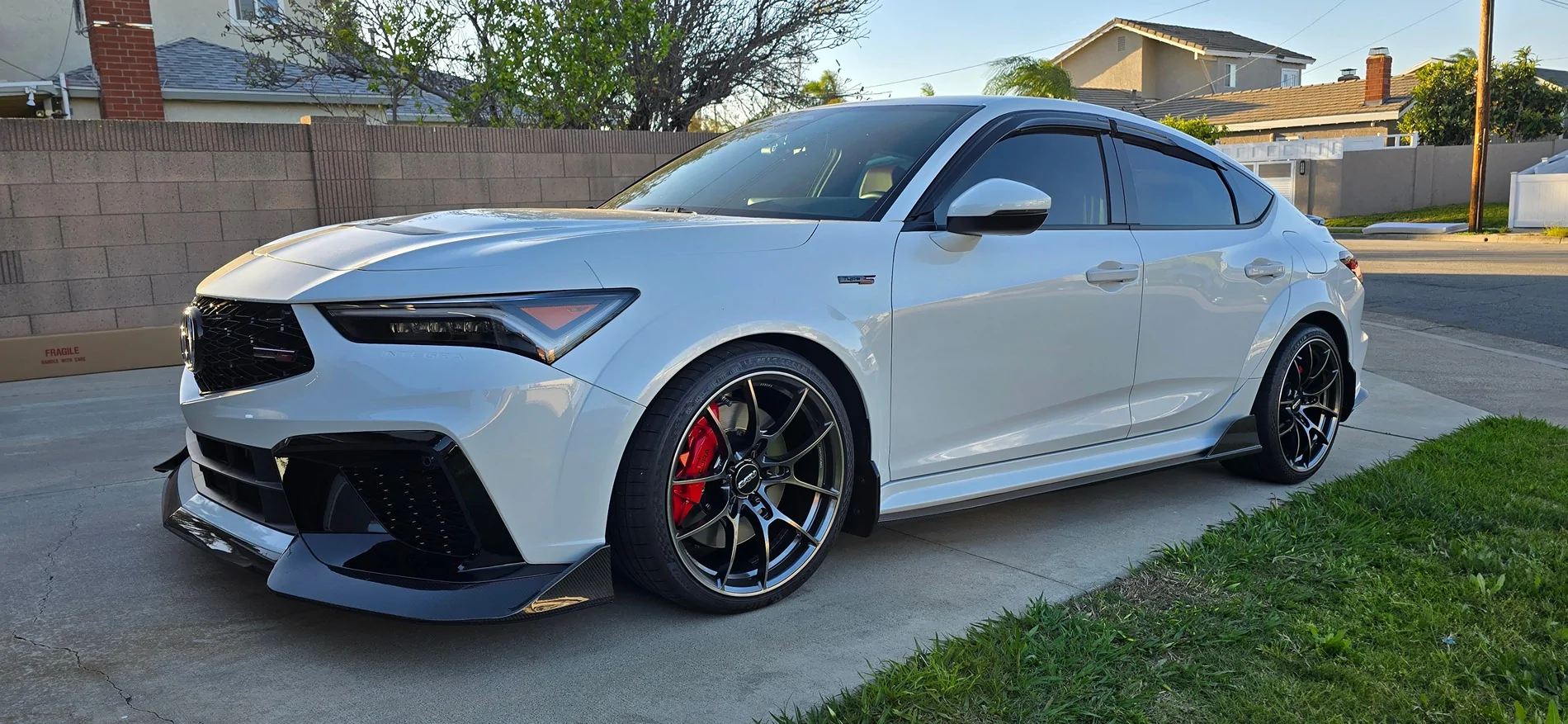

I bought my rims from BHJ and they are legit. However, if you're buying Volks and any name brand rims, there is a wait list. It's based on manufacturing schedule and you're just jumping on the queue based on their manufacturing time. Took me roughly about 6 months to received my G025. As mention above, you will most likely be hit with tariff so take that into consideration, luckily I got mine before the hike, so I had to pay a small fee to receive mine.
Pics and specs of G025 pls.

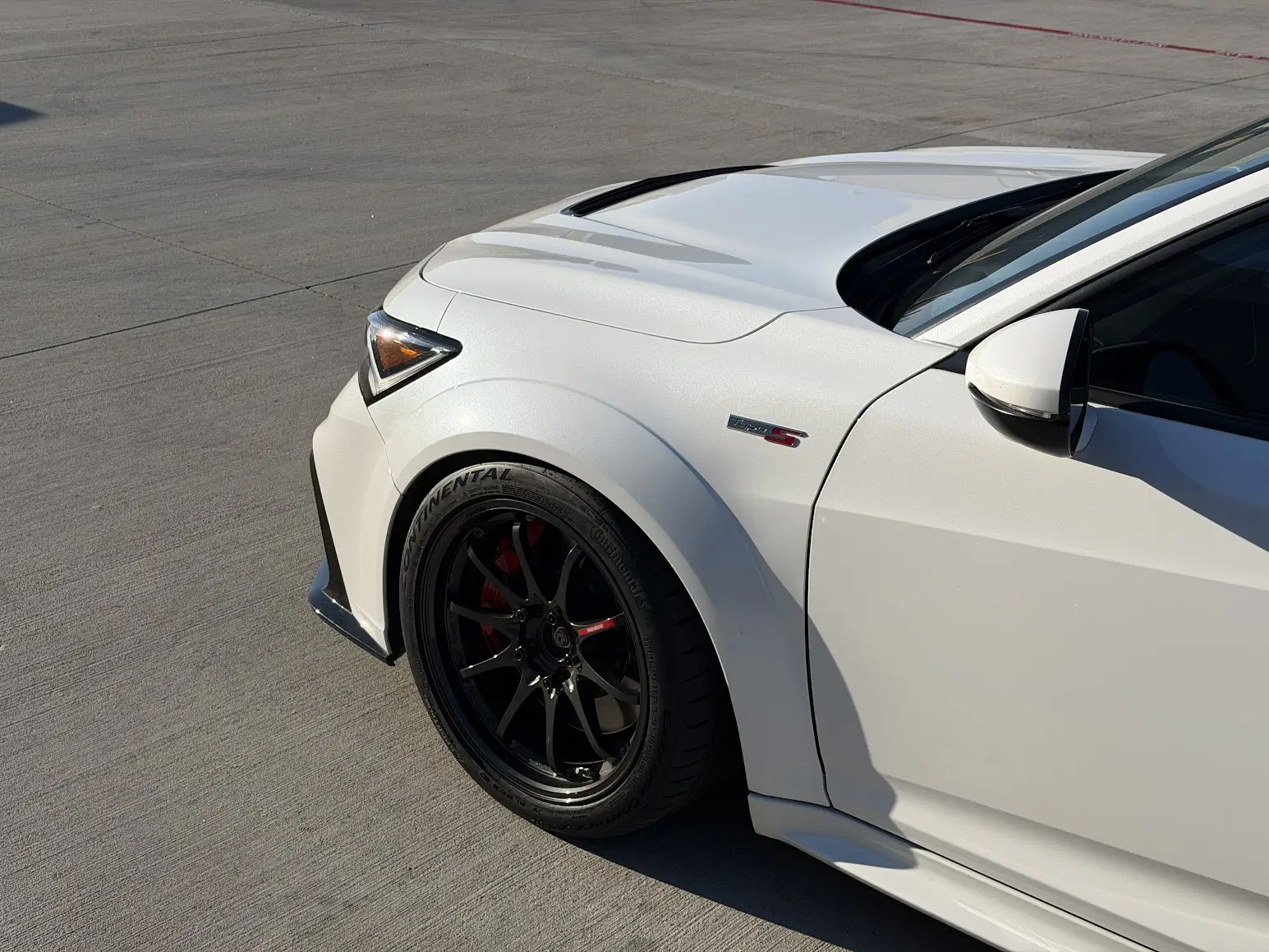

18x9.5 +38 CE28 Club Racer II
275/35 Conti Sport02
Swift Spec-R springs
No rubbing issues
Thank you for sharing this!!! These look really good and exactly what I am looking for. This image helps a ton

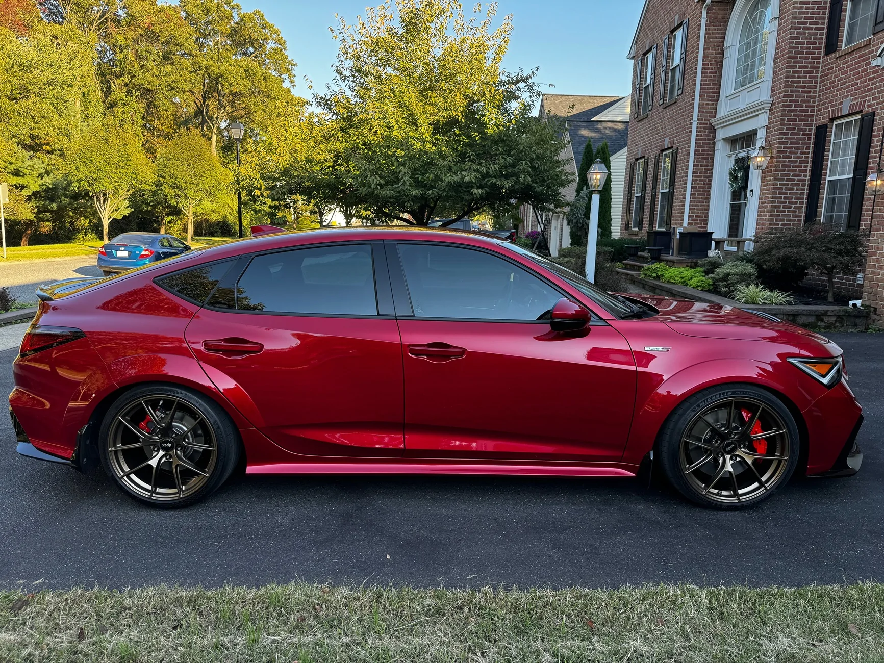

Still running stock height.. Debating either getting springs or fatter tires.
19x9.5 +44 (265/30 stock tires)
Thanks! I was really looking hard at the G025s (especially the Shining Bronze Metallic ones) so I'm glad someone's tried them. Absolutely gorgeous! I really want the 10.5s to work but somehow I don't quite think they'll fit, lol.

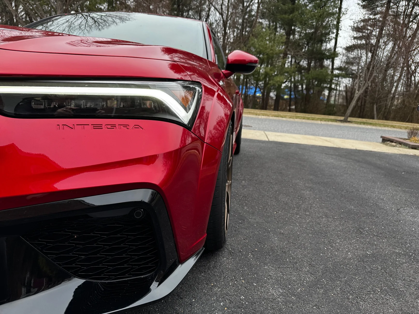

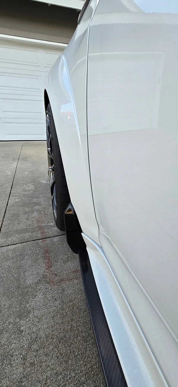

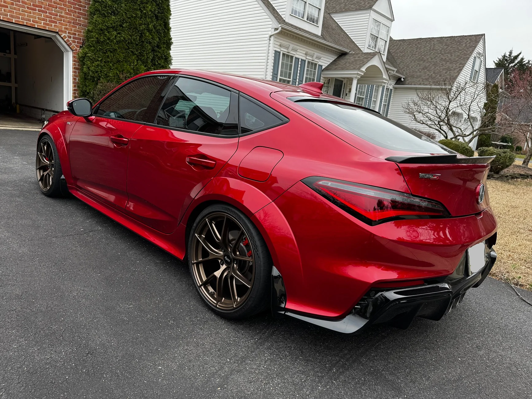

I just bought a set of 18x10+40 CE28N+ in Shining Bronze as I may have mentioned already but they're not on the car yet. Trying to hold out for the new Bridgestone RE-71RZ but they're backordered and I may have to figure out a contingency as my first AX event is in less than 4 weeks. Here's my setup with 19x9.5+45 Apex VS-5RS on the OEM PS4S. Eibach Pro-Kit springs.
