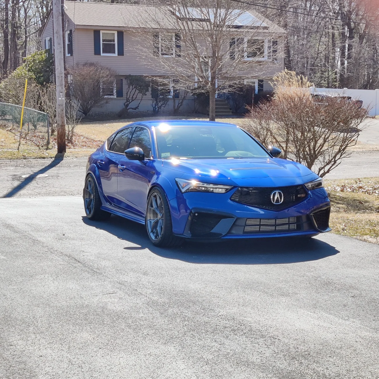

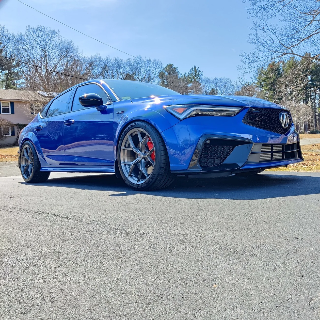

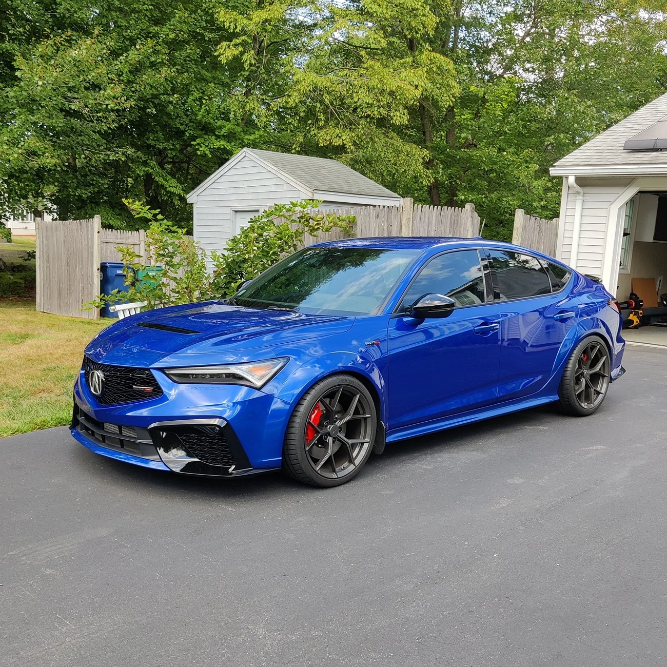

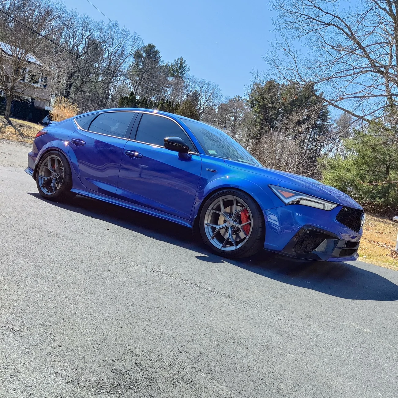

+37 would be a great look if you're sticking with 9.5" wide and lowered in any capacity. It will come down to tire choice
I ran these on a 19"x9.5" +35 lowered on H&R and ultimately settled on 275/30.
265/30
275/30
275/35 (last 3 photos)
