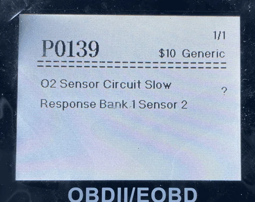

there have been several posts about the burbles and pops disappearing, so I am sharing what happened to me tonight.
Last weekend I installed the TSP downpipe, PRL exhaust and some other goodies but I am highlighting those because of the symptoms.
I have drivin more than 100 miles since the install without any issues. Tonight I stop to fill up the tank after work and all of a sudden once I cranked it after the fill up my burbles and pops were gone. I also noticed immediately that I now had noticeable rev hang which is what I am attributing to the loss of burbles as the ECU retards the timing when load is suddenly lifted from the engine. But in this case it was seeming like the accelerator was stuck for second or 2 with gear shifts thus no load shift for the ECU to add fuel and retard timing.
So, on the way home I am like WTF. The check engine light is NOT on so there are no codes and the TSP downpipe is not supposed to throw a code and it's been fine all week until I filled up for gas. But thinking about it I am like this has to 100% be an ECU issue..
So even though the check engine light was NOT on I pulled out my OBDII reader when I got home.
Checked first bank $EF clear. Checked second bank $10 and sure as shit code P0139 (o2 sensor circuit slow).
So the ECU thinks my lower O2 is kinda special and needs that easy kind of throttle treatment. ( <--my lame humor)
Anyway clear codes and instant burbles and pops with no noticeable rev hang. (for a DI car)
I drove about 10 miles with a couple of engine off stops and no return of code (yet)
So if you lose your burbles and pops check band $10 for O2 code even if your check engine light is not on..

Curious to see if it'll detect whatever it detected the first time and throw another code or if clearing it is a permanent solution.

With the TSP down pipe is your secondary O2 sensor threaded directly into the dp or do they still require you to use some sort of defouler?
I get this regularly with my RV6 dp and have to constantly clear it, they suggest threading the defouler 1 - 2 turns deeper into the bung, since P0139 indicates the O2 isn't reading sufficient exhaust fumes, but I havent had the time to.

thinking back, is this the situation where you pull the gas pump nozzle out after filling too quick, and some gas is caught in the neck? That's when they lost there pops and got check engine light. Ever since someone posted that, I've been filling on low speed and then leaving the nozzle inserted for 10 seconds after turning it off, to keep the valve further don in the filler neck open, so all gas drains in completely. just thinking out loud...
O2 cel don't think it correlates to the fill up but shit did happen when I filled up.

for the TSP they have an extension for the second o2 wire harness as the spot on the DP is too far down for the original wiring to reach but the 2nd O2 sensor goes directly into the DP below the cat.
if cel comes up again that connector will be my first place to look.
