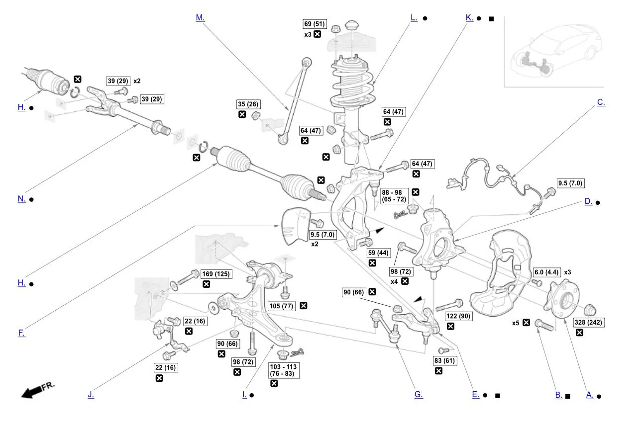

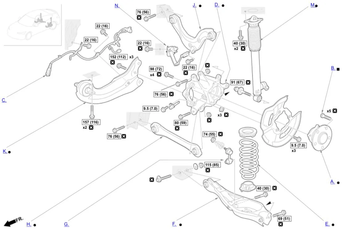

Hey gang, would anybody know where to find the bolt torque specs for the ITS? specifically for front and rear suspension bolts? Just did the springs and rear sway and the only thing i could find online so far where the torque values for the FK8 CTR.

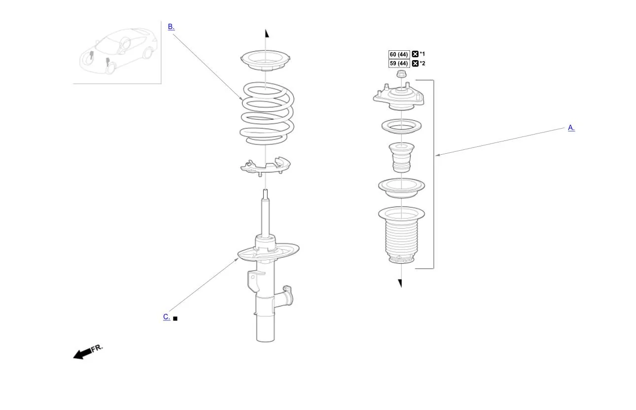

For the front suspension you will be looking at the “*2” value as *1 is for non-ITS (although they’re basically the same). For the rear specs are for the type S.
Torque values are in N-M parentheses are lb-ft

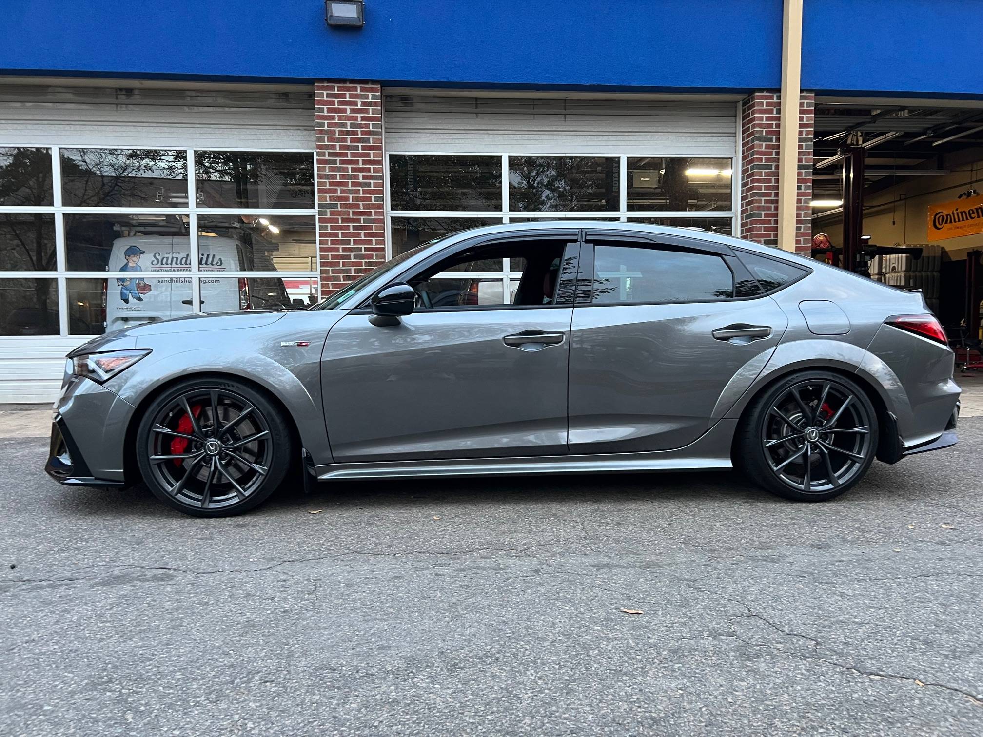

Judging by your thumbnail, your car is beautiful!! Can we get some pics, especially now that you have springs installed? Thanks!!
So, of course, it's time for the best emoji....
:postpics:

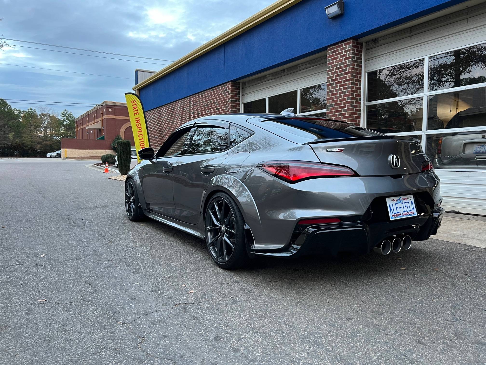

603
514
Sure, who doesn't love to show their ride. I don't have any great pics since the drop as it's been nasty weather and the car has been tough to keep clean. (Track pics are pre-drop)

Thanks! I always thought I wanted a red ITS, but that liquid carbon looks fantastic!
603
514
Thanks.
The ITS looks great in all colors IMO. The body lines kind of play with the light at certain angles.
