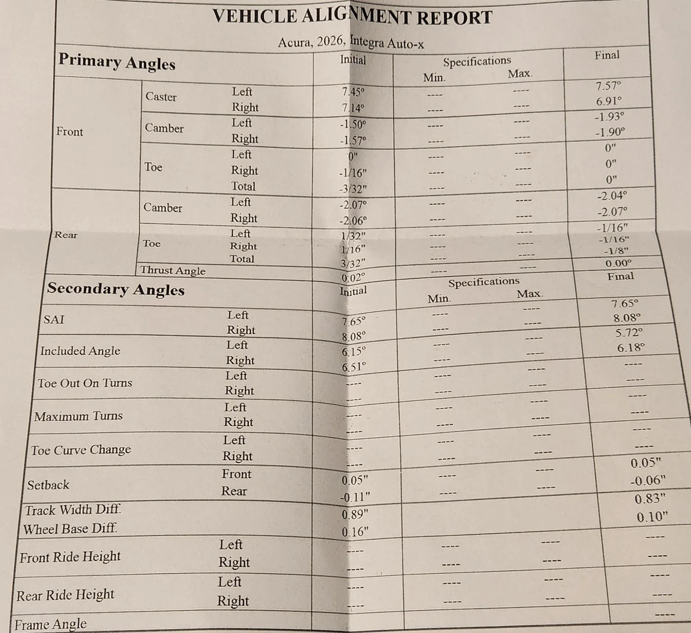

Finally got it to a shop today whose owners are autocrossers, too. Got this number before/after. Immediately felt it behaved differently in rear on freeways in curves. Like it wanted to oversteer or else. AX on July 11 and 12. Can't wait to see it in action.

Hell yeah, that'll do.
I love how precise the steering gets with 0 toe. No more rubber necking or you'll go off the road 😏

How'd they adjust the camber? "Strut pin" trick I'm guessing.

You're right about how they adjusted camber.

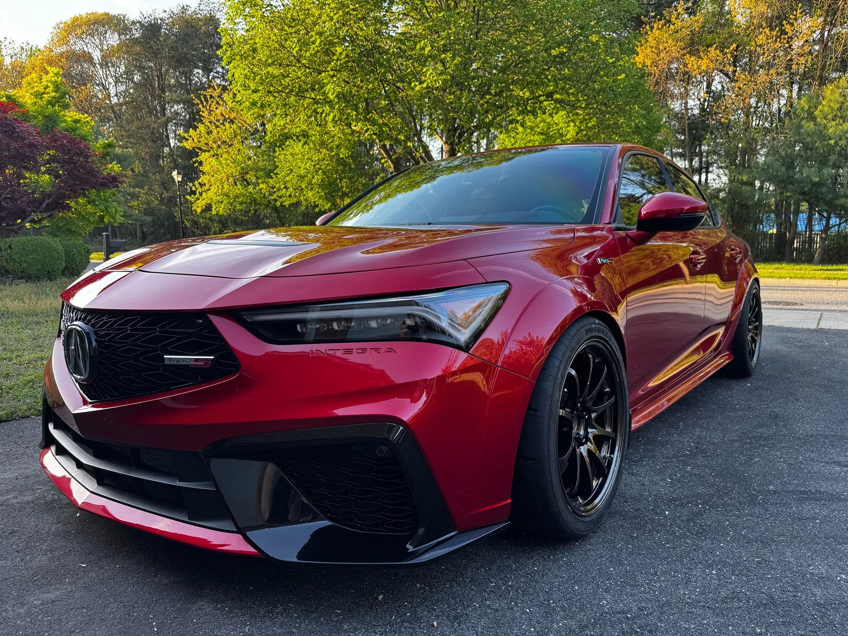

Personally I went with 18x10+40 CE28N with 275/35 RE-71RZ because they're some of the only wheels I personally like the aesthetics of in an 18 on this car- and I got a pretty good deal on them. They did run me north of $6k though with the tires. This is the life we live.
Acura Integra Autocross megathread 1783014558523-rc
BTW this setup WILL RUB slightly even with camber. But SLIGHTLY is the key word. I was shocked and appalled to find out they rubbed when I put them on the car because everyone told me they wouldn't... but it literally went away after a couple days as they just kind of "made room" for themselves in the inner fender liner. I checked; there are no holes burned through and the tires are no worse for the wear aside from some minor scuffs that are also gone now. Just the slightest amount of clearance issues on major bumps but it was a surprise initially.

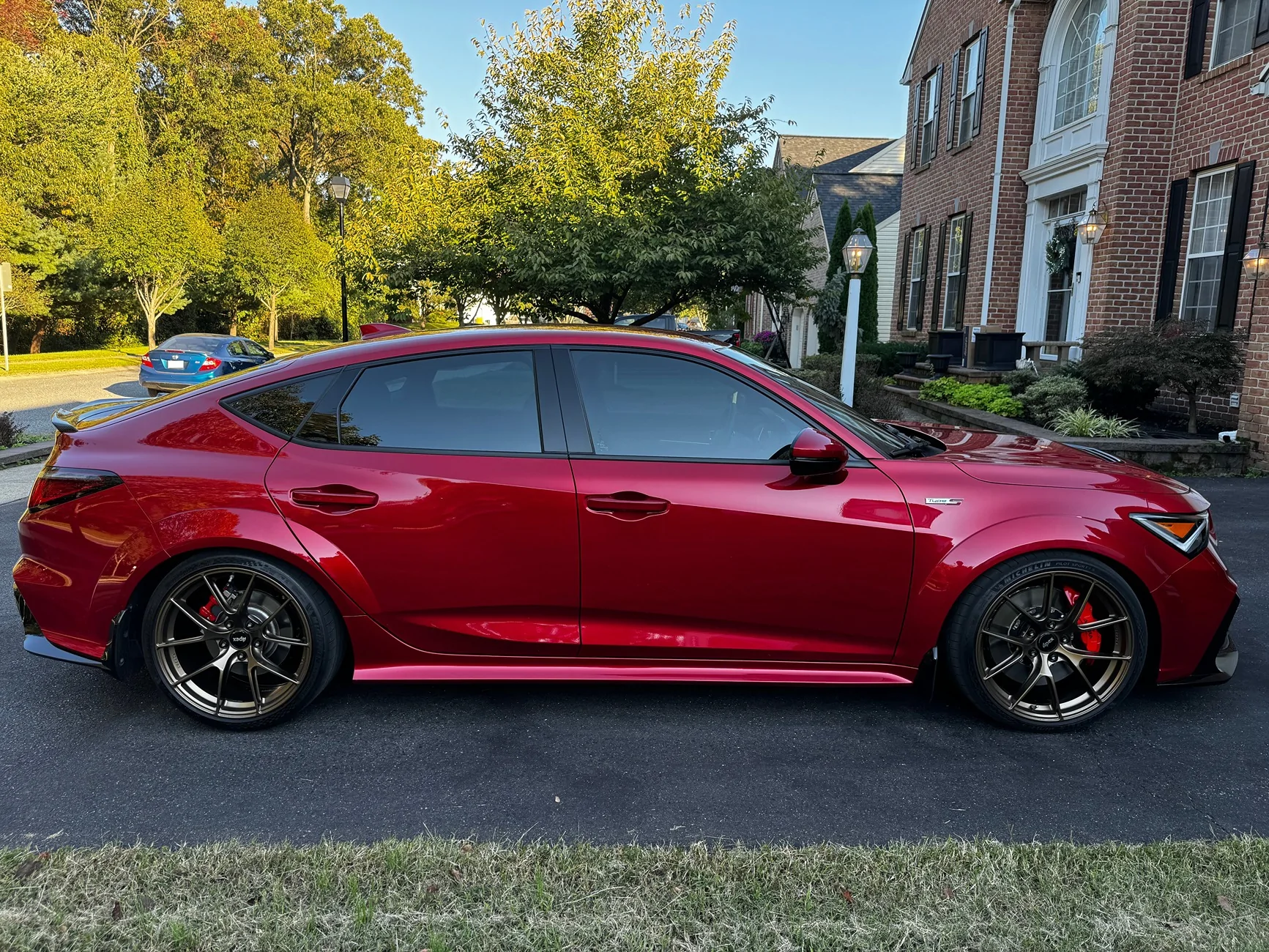

Here's my "daily" setup, still on Michelins but with Apex VS-5RS 19x9.5+45.
Thank you! Your car is gorgeous. I had to zoom in, it's just a perfection with both sets of wheels. Mine is never so clean, and it's black, lol.
Thank you for your advice and the warning about scrubbing. I might be overly cautious, but I think that might cause fire on track? Maybe I'm overthinking, but putting a new set and go on hot laps might be an issue.

Thanks! It's parked outside more so I see it more often and I agree, it's fun to look at lol.
I think a fire hazard is a stretch, but my concern was just screwing up my tires I just spent $1800 for. Apparently any other tire that aren't Bridgestones should be fine.
