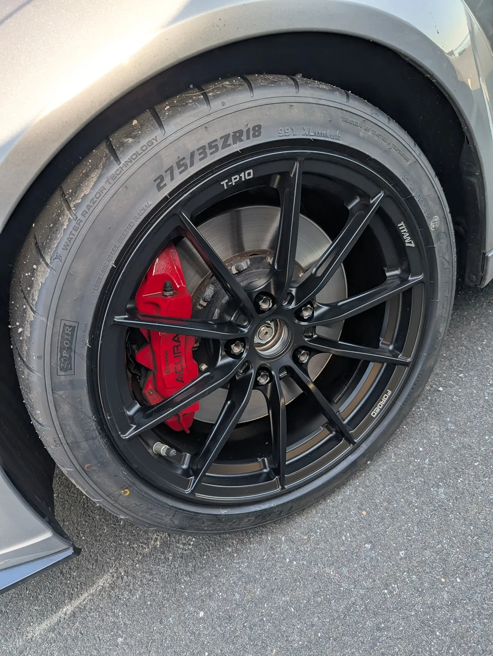

My Titan 7 on the ITS. p10-18x9-5-53-5x120-64-1-machine-black
Unicorn build.

@mattm Looks solid, I like the black!

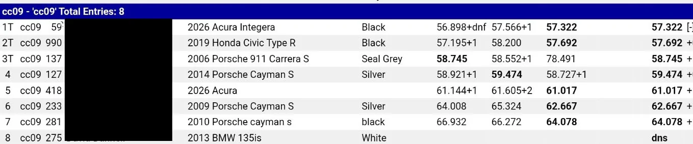

Anyway, my stellar instructor/codriver took the CC09 class win today at the PCA event. He drove my car for the very first time today and was the only one in class running on OEM tires with me. Second place went to another instructor in his own CTR FK8 on 200TW Bridgestones.
I ended up 4th overall, but don't get me wrong—I was turning 58s in the morning. I made a deal with my codriver: he takes the class win while I focus on my skills. And today, my brain genuinely short-circuited after his assignment. I learned how to left-foot brake in a manual car. Now, I've done left-foot braking in my Camaro, and I learned heel-toe at Skip Barber—but doing it in a stick shift completely overloaded my CPU. I drove most of the day in a manual-override of my brain, constantly fighting the urge to push the clutch in every time I braked. I even stalled at the start and at the finish a few times. I just can't seem to rewire myself... yet.
But if this skill can get someone to 1st place (which my instructor just proved), I'm all in.
We didn't spray the tires. We started at 38 psi square, but then the CTR instructor shared his setup: 33 psi front, 42 psi rear. I couldn't bleed the fronts anymore (I had them chalked), so we bumped the rears up to 42 psi. Worked perfectly.
He's #59, I'm #418. And just to be clear—I'm not usually at the back of the pack; I was leading the FS class at SCCA until today. Today was their competition day, and I got kicked out to 2nd in a class I no longer even have a car for. Kinda sad, but that's life. Can't wait for next year with them—still deciding between BS or BST.

The 53 offset is a unicorn. Titan only did some limited sets. I got lucky.
