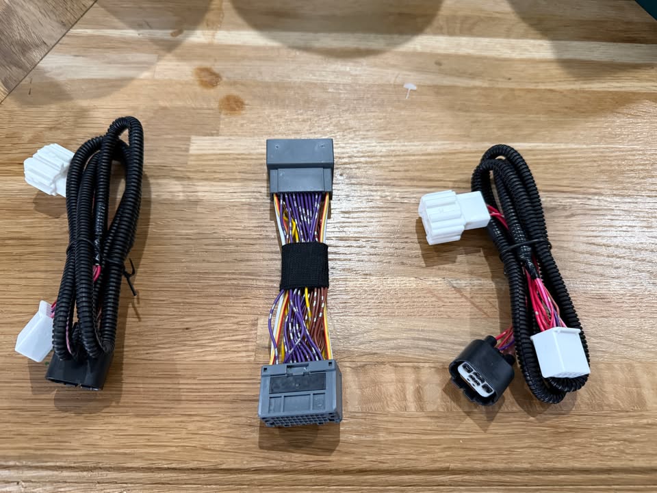

for the rear motor switches. You need these wires
Acura Integra Auto Folding Mirrors installed 1778341420232-m7

Thank you so much, this helps a ton.
One last question, where does that gray/purple harness go? Driver door?
Edit: yes, driver door.

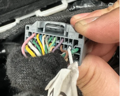

  • My reverse-tilt doesn't work, but I was able to unplug the tilt wire to fully disable it. So now it doesn't move in the wrong direction anymore. Everything else about the passenger mirror still works.
  • Seems like the "open windows using keyfob" feature no longer works.
To disable the reverse tilt, I you can de-pin this white wire (note, it's not actually white, this is from the mikstore installation instructions for the reverse-tilt kit)
Acura Integra Auto Folding Mirrors installed 1778361859609-hj
