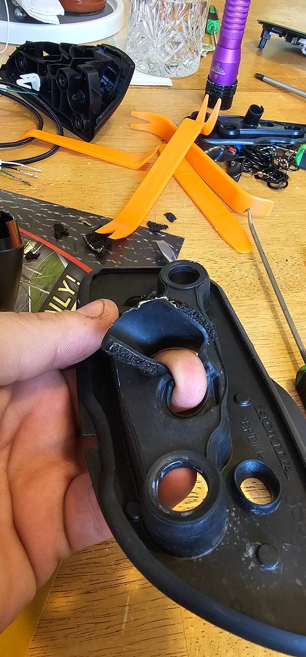

If anyone orders the mikstore kit c i did not depin the harness. I cut the rubber gasket on the back of the mirror with a pair of scissors then pryed the metal/rubber skid guide thingy up and pulled the harness through the base as is. This isnt for people who care about damaging the rubber gasket. I just elecal tapped the cut back up after. This is probably the easiest way to install power folding mirrors. Thanks OP!
This is the rubber gasket on the back. I opened the cut so you can see where i cut.
Acura Integra Auto Folding Mirrors installed 1000003215
This is on the other end of the mirror base. That skid plate just pushes in the base and comes out with a flat head or a pry tool. It pushes back down and stays where its supposed to when pressed back in.
Acura Integra Auto Folding Mirrors installed 1000003216

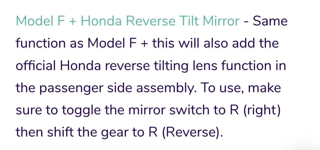

Reading the other thread on this topic, I have some concern about the tilt feature. It seems like for our cars it is always enabled and we cannot simply turn it off by putting the switch in the middle. Is that still the case with the latest kit?
3,448
2,940
Did you order the Model F kit with tilt?
If you did it seems to function like the Aspec Tech. Leave switch on passenger side to enable tilt.
Acura Integra Auto Folding Mirrors installed Screenshot_20250423-095947
ajamils
Arsalan
Apr 22, 2025
Houston, TX
2025 ITS
Yes, that's what I ordered but then got confused reading some of the comments where the OP mentioned that he had to install a separate switch to disable the tilt function.
3,448
2,940
Oh. Maybe he purchased the standalone tilt kit. I think it may work differently
