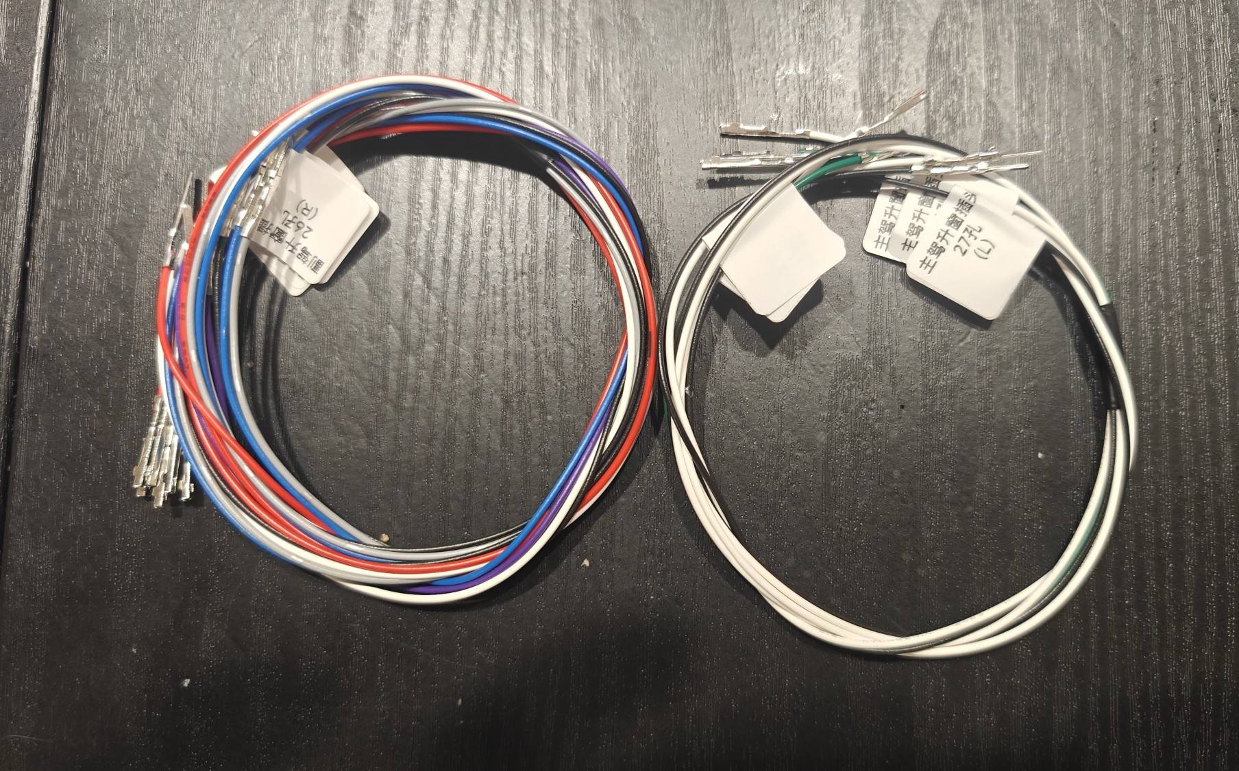

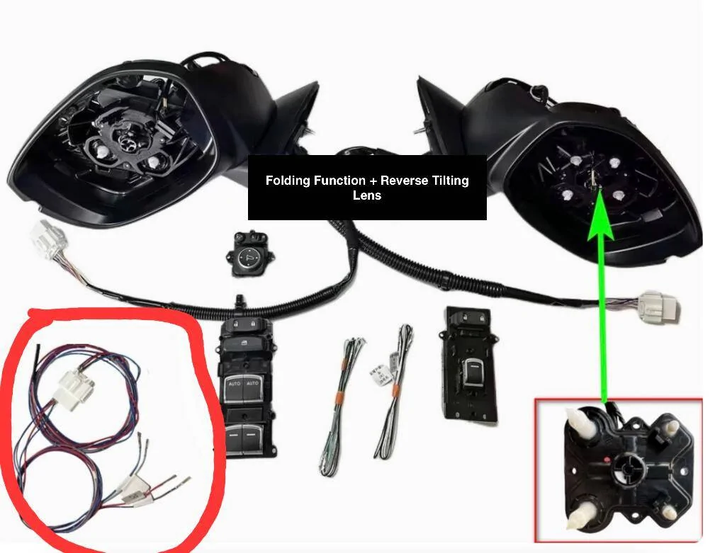

I'm going to swap bases as well and just use the original painted caps but getting confused with the instructions that shows connecting different wires.
Also, I received there two wires bundles but I think I'm missing the one shown in the image on the site.
