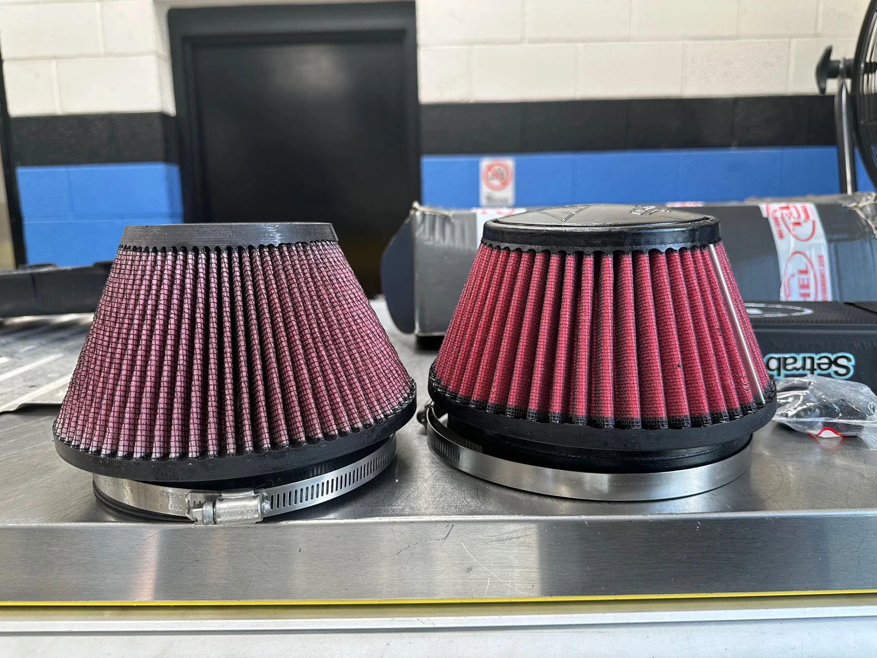

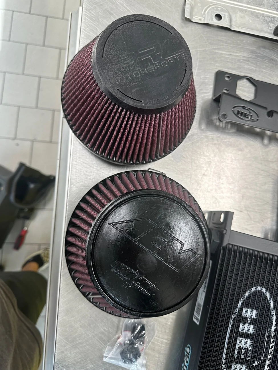

The AEM filter is like a nice sweatshirt compared to the PRL filter is like an old thin worn t-shirt. Definitely a big difference.
I will say the intake noises are slightly, maybe 10% quieter with the AEM on now. Still a million times better then the stock intake noises. lol

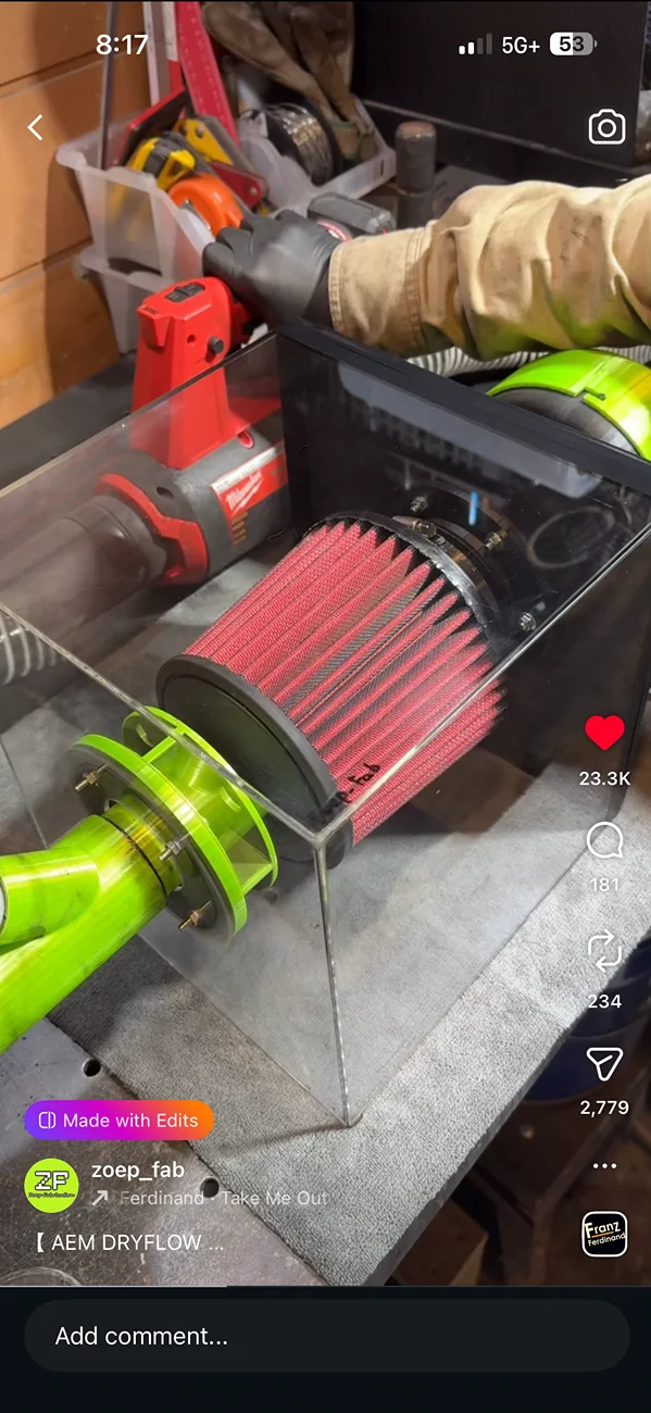

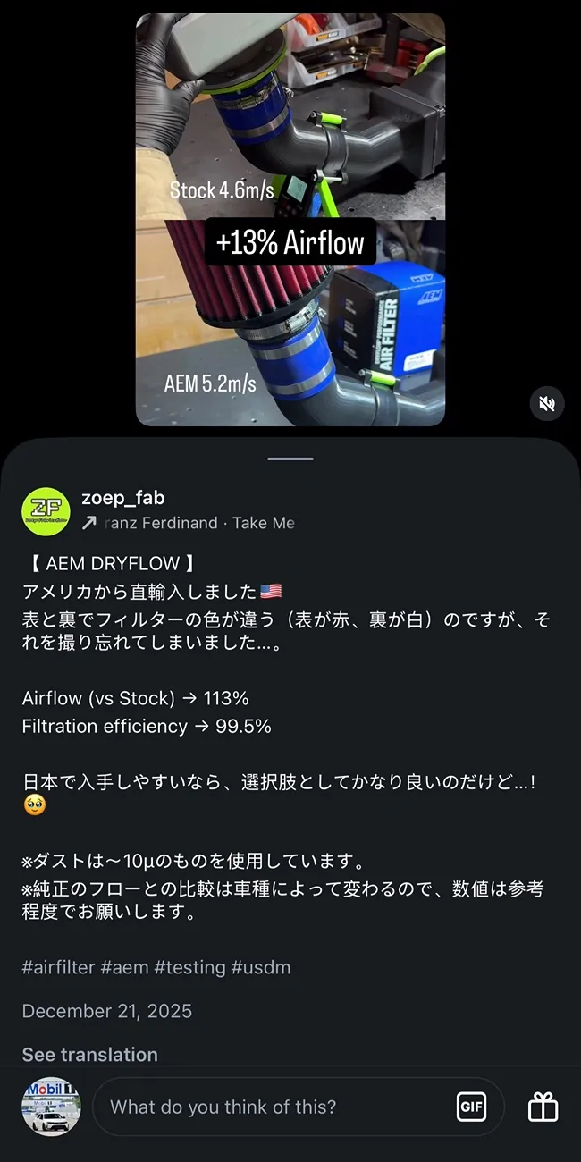

Check out this guys Instagram. He tests the efficiency and compares different brands of intakes. Pretty neat setup he has.
According to his tests, AEM Dry Flow has 99.5% filtration efficiency.
Good info. Thnx.

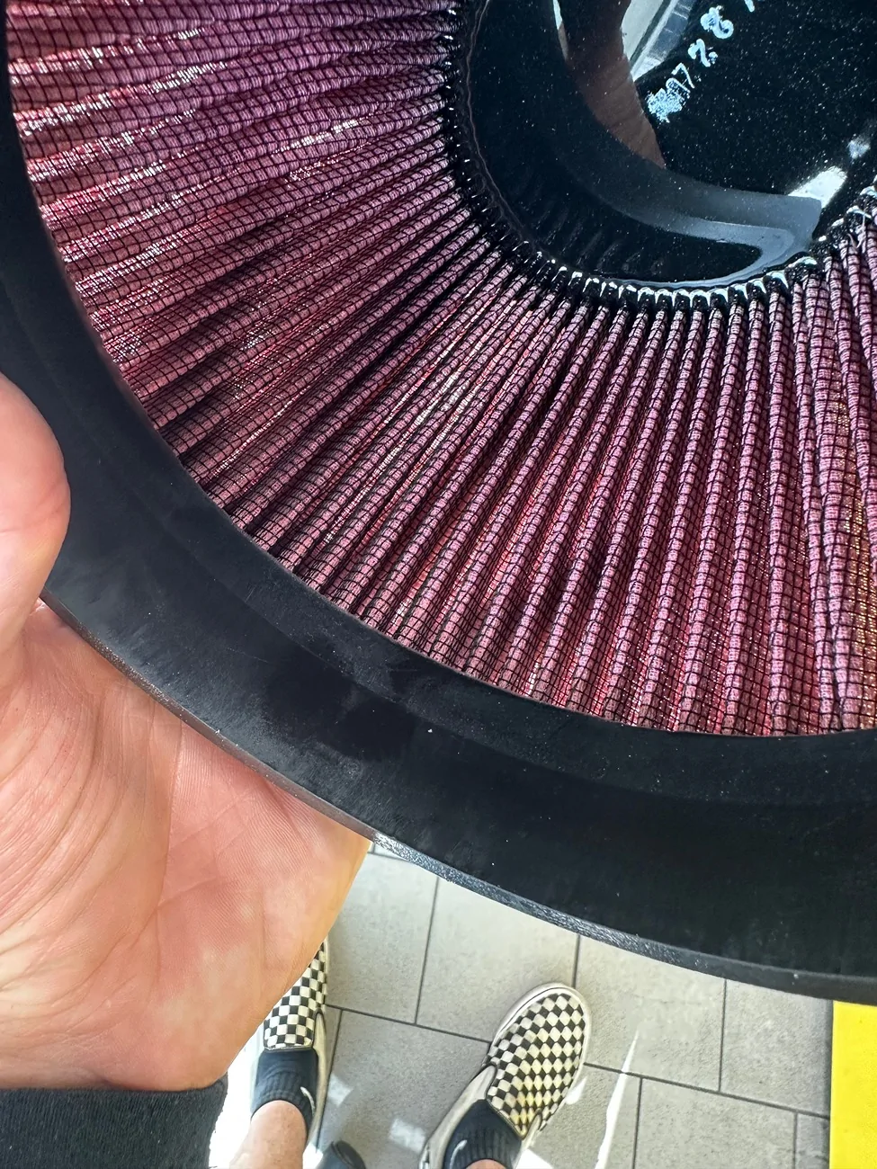

I switched to the AEM dry flow filter about 7,000 miles ago since the PRL filter was letting a lot of dust inside.
Just so everyone knows, the PRL filter is just one single thin piece of cloth that is see through.
I was running the Spoon/Sprint drop-in filter for about 8k miles, it's about as see through as this if not even more. Checked it recently to clean it, ran a clean finger against the inside and pulled back dust that was definitely not there when I first installed it (car already had about 11k miles on it with the Oem filter at that that time).
