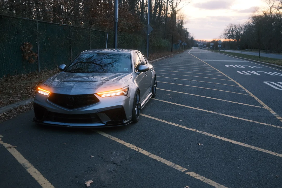

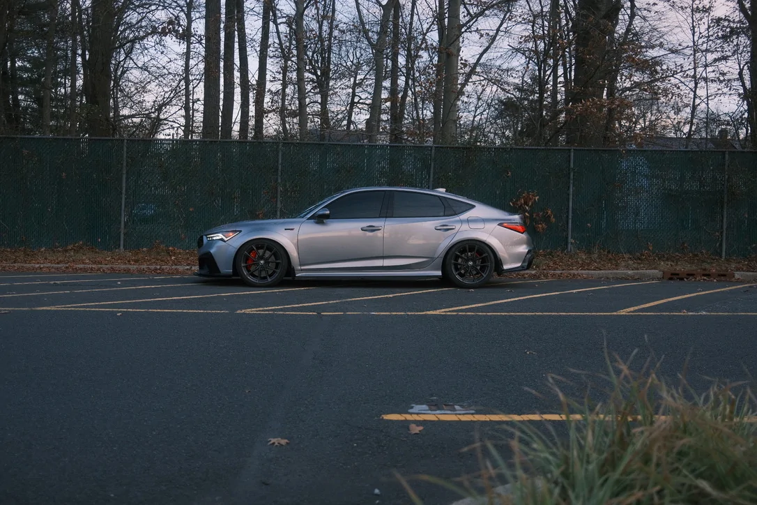

Integra Type S, Cayenne GTS
I'm running the Eibach Sportlines with 20mm spacers. It's close with stock tires but would really like to jump to 35 profile. Do you have these on your setup?
I am on Eibach Sportiness with 15mm spacers all around in the colder months.
