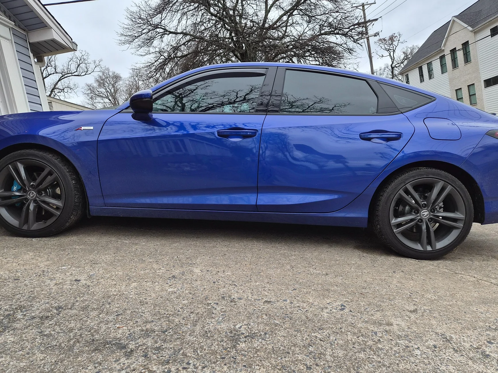

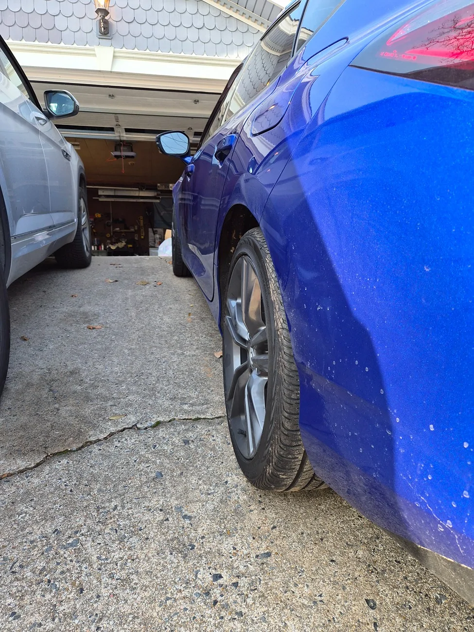

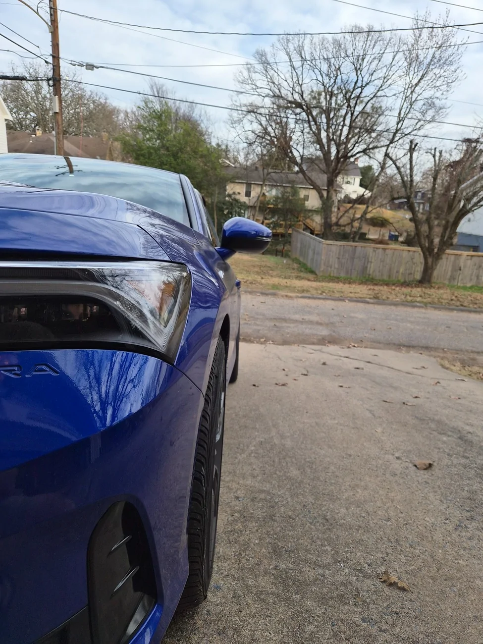

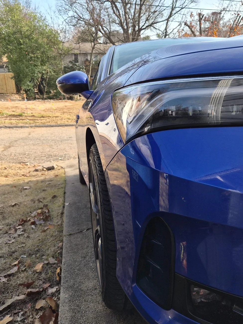

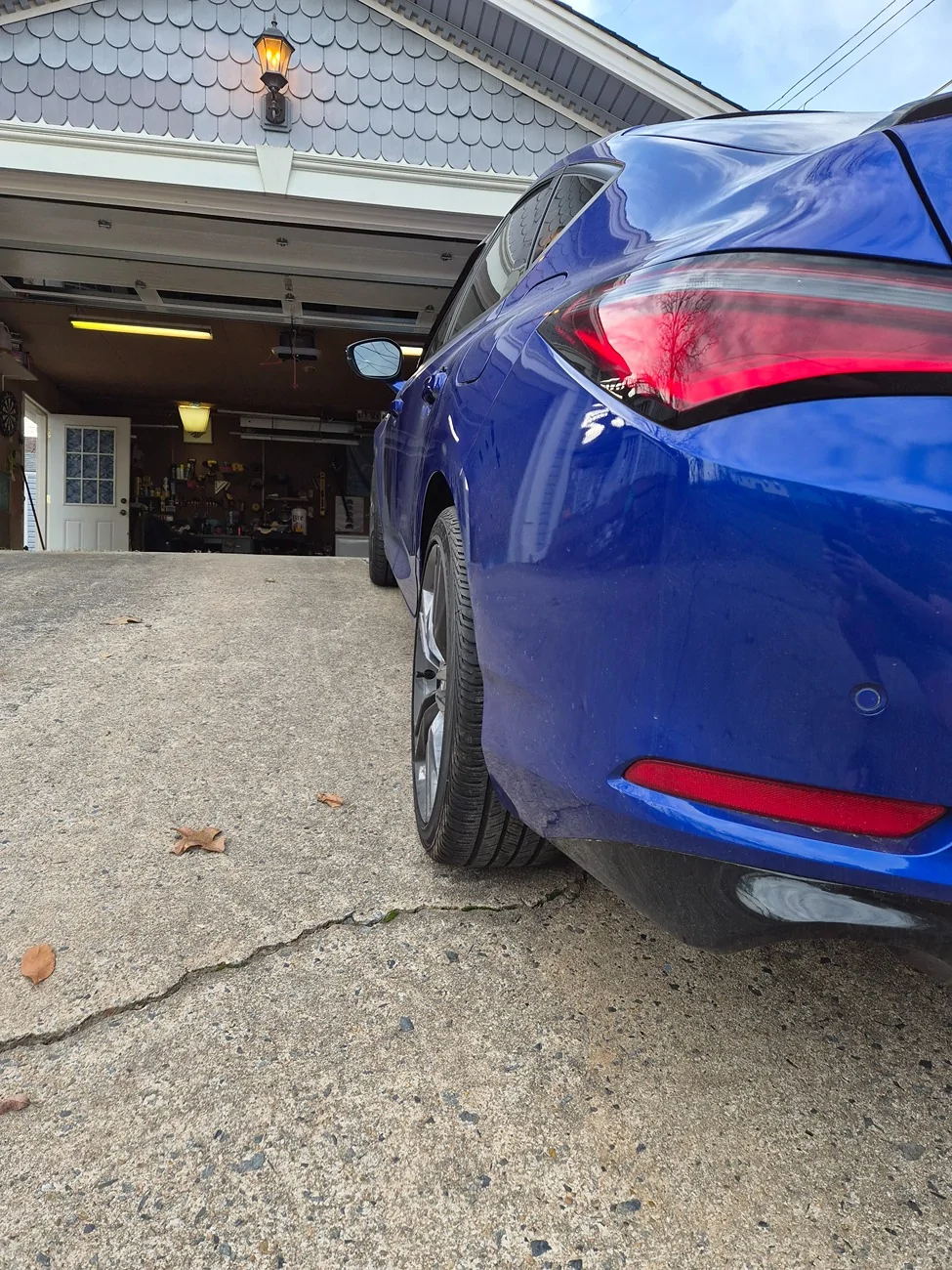

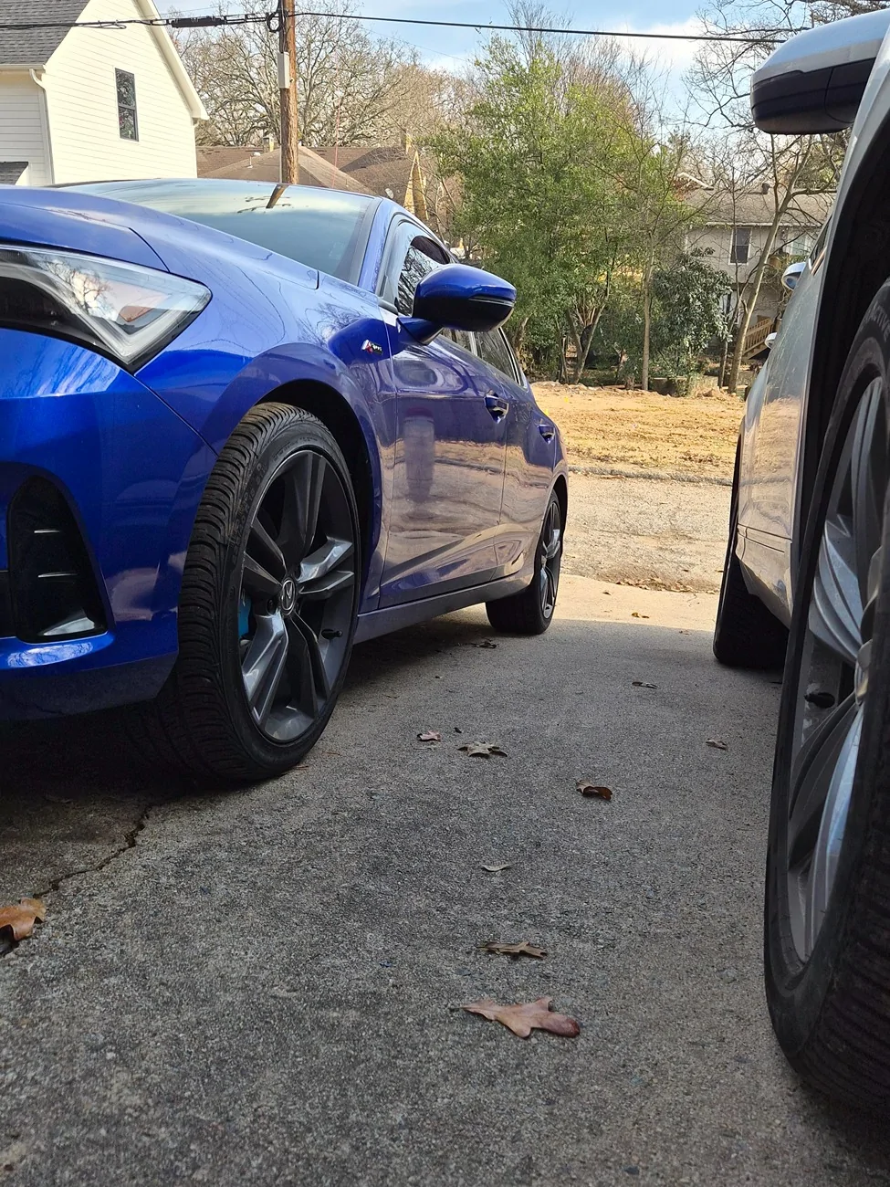

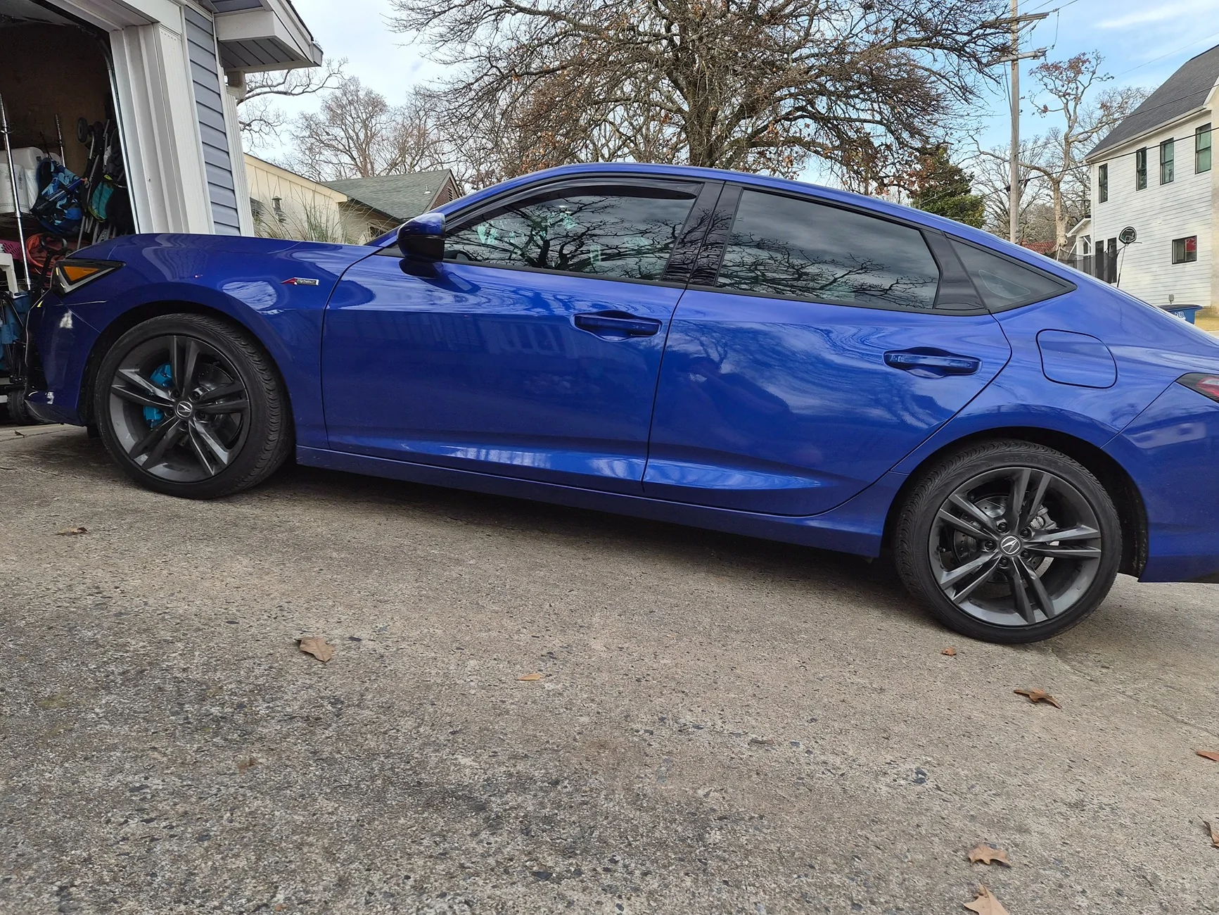

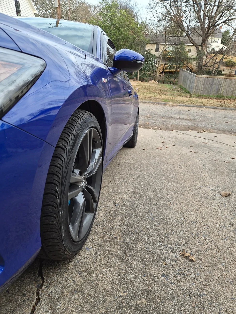

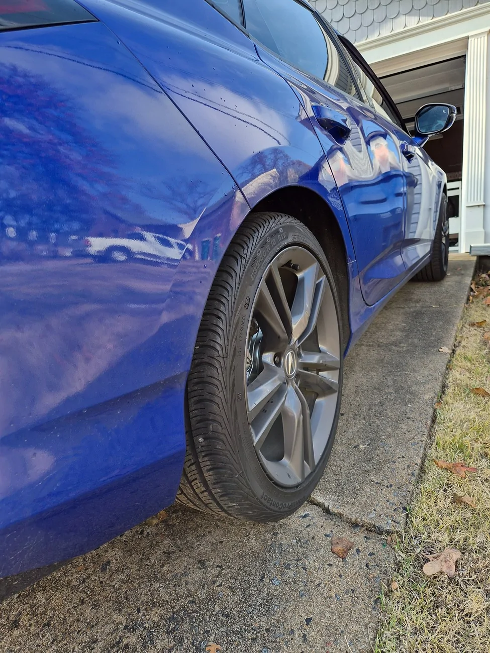

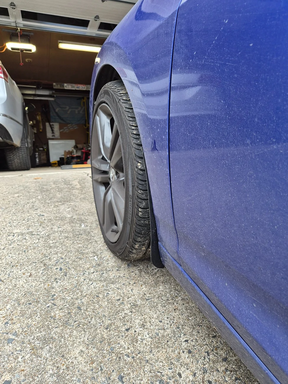

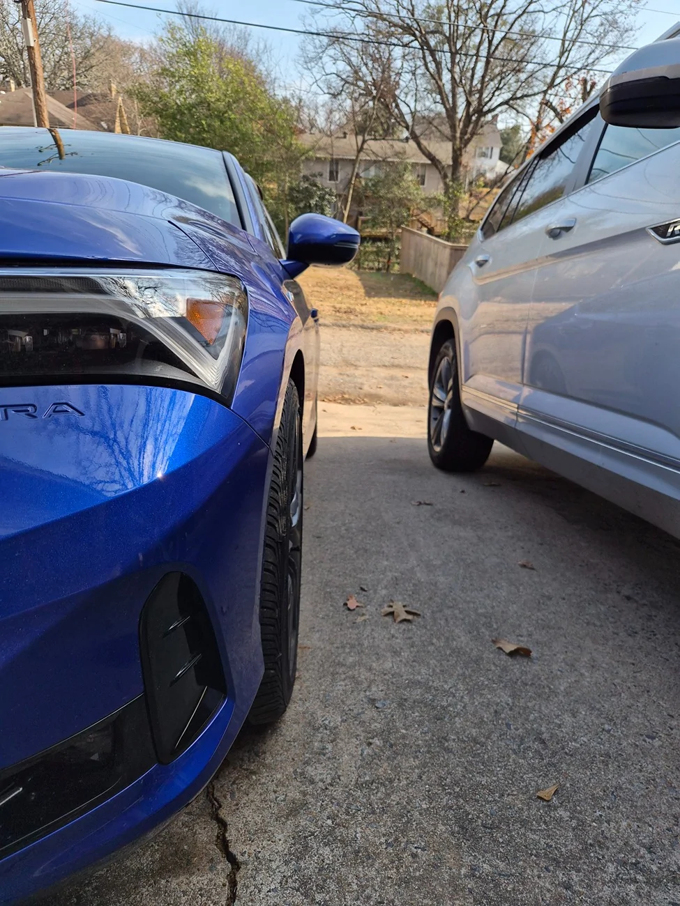

Here are some stance pics - thought they give a good view on stock wheels/tires since I have 20mm on the front and none on the rear. Rear spacers go in soon!

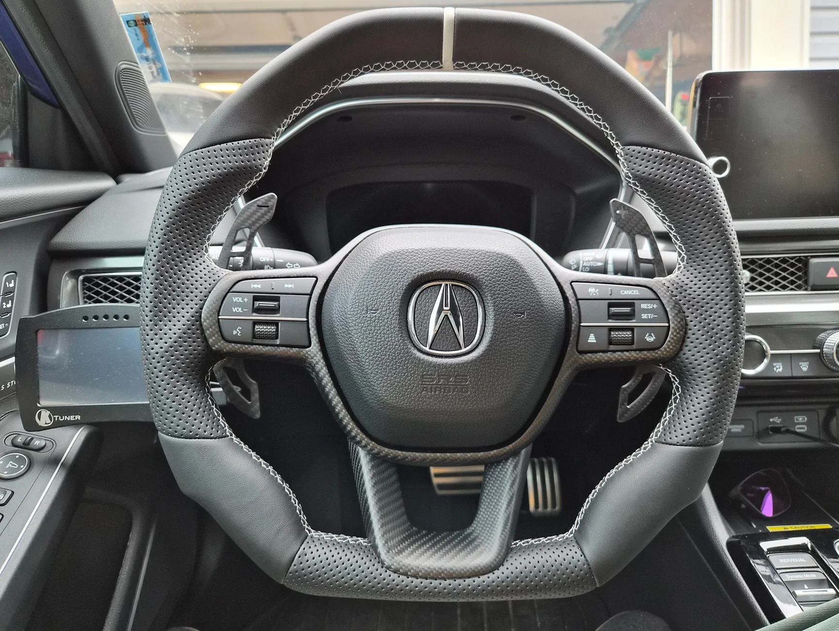

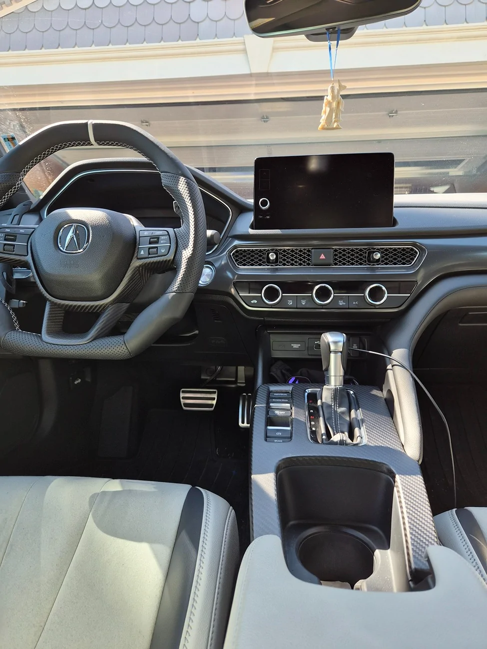

Carismo signature perforated leather wheel with the matte CF trim and CF magnetic paddle shifters installed -
Acura Integra '25 Integra ASpec CVT Build 20260215_115331
I got the steering wheel used here on the forums & got the trim from carismo, but saved on white-label shifters. Pretty simple install, just takes patience with fitting the trim back together. The paddle shifter wiring harnesses have to be routed up by the ribbon harness on top for it to fit back together.

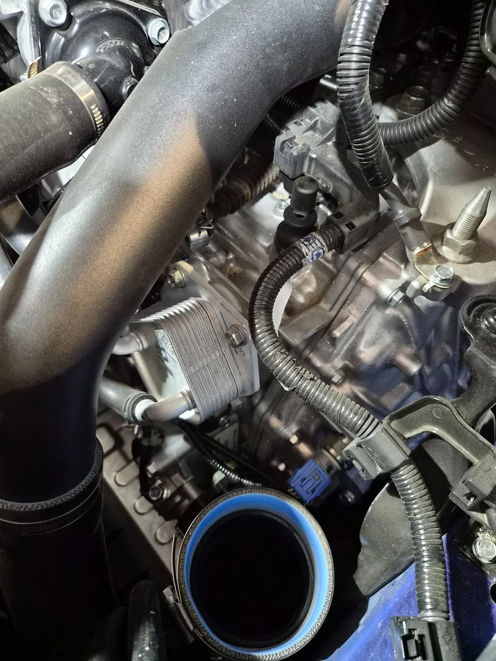

Was able to check the intercooler outlet and confirmed no boost leak. Will have to do some more max boost testing because I've only seen it hit 21psi flat so far. The tune on map 3 is supposed to be 25, but they may have limited it to 21 on the cvt.. perhaps.

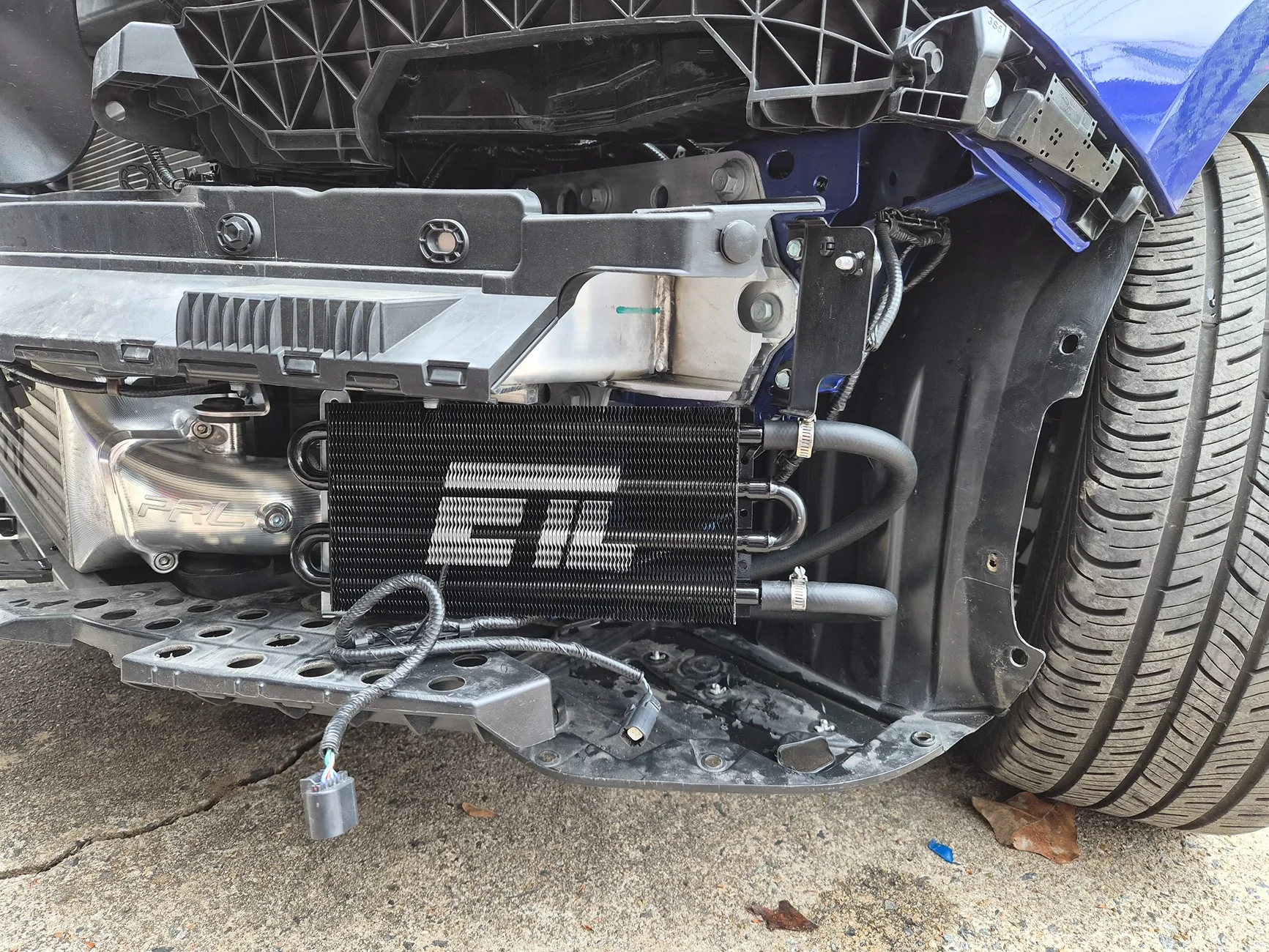

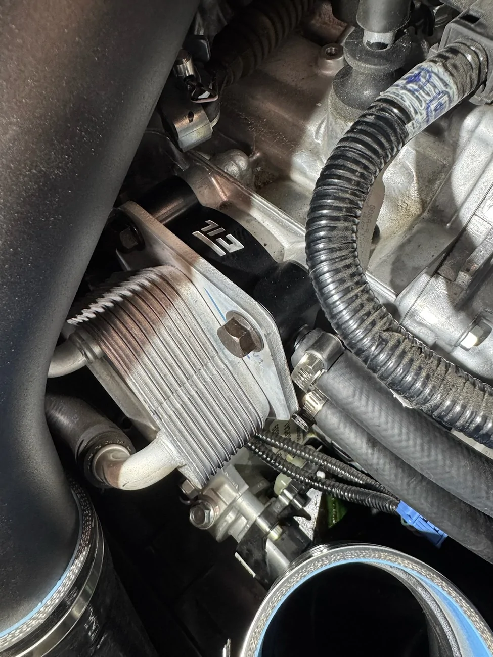

While I had the bumper off I "pre" installed the ETL transmission cooler. This is made for the 10th gen civic so the mounting brackets don't quite work. Happy with how I got it mounted, though.
Acura Integra '25 Integra ASpec CVT Build 20260308_130844
Routed the fluid houses into the engine bay, so once I'm ready to put in the sandwich plate it's good to go.

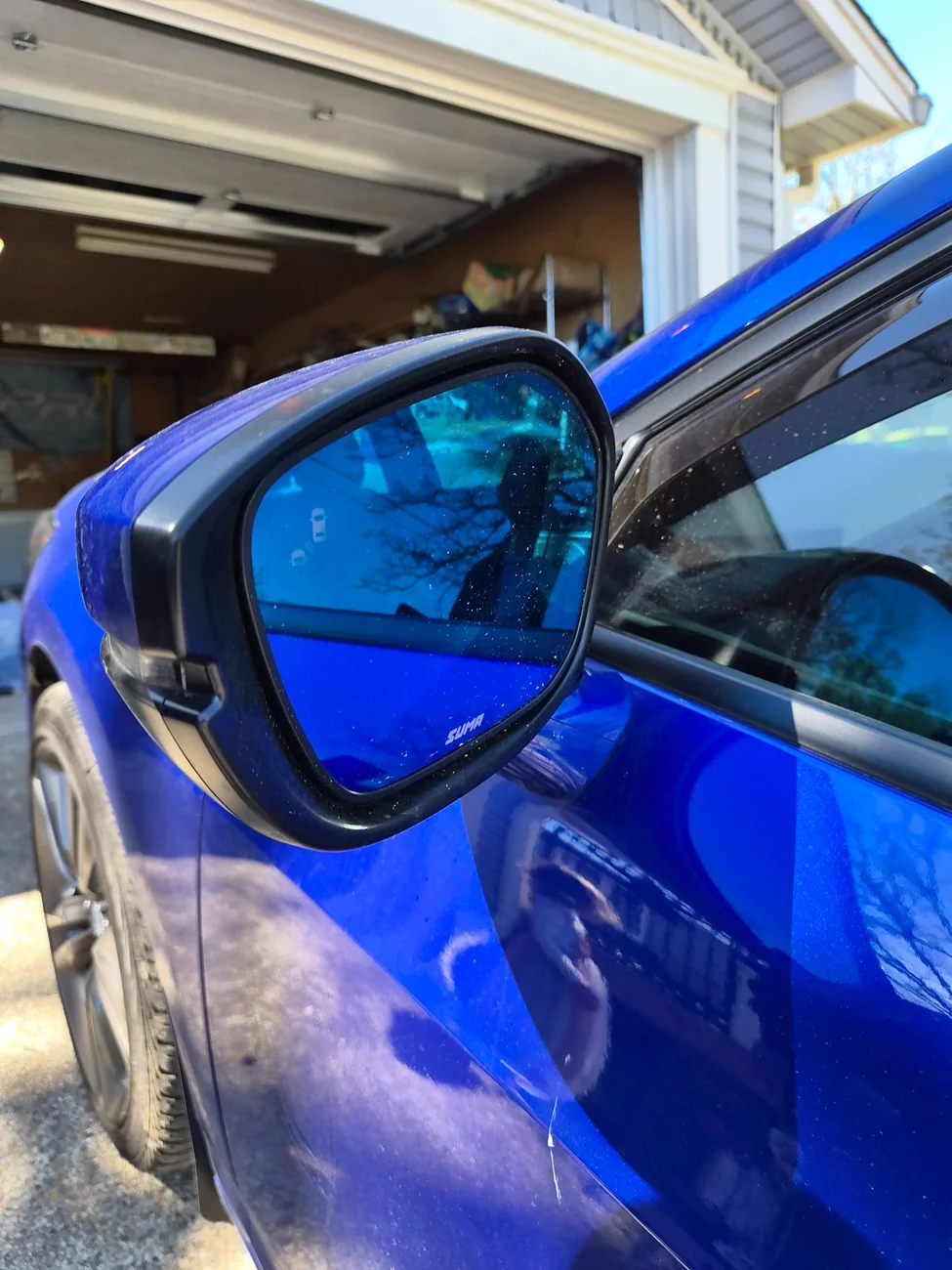

And last, got the Suma mirrors in that I had ordered last November. Waaay more blind spot visibility on these and very simple install.

Went to the shop for oil change and went ahead and had the ETL trans cooler sandwich plate installed. So glad its on there - will report back on how my trans temps have adjusted with it on.
Just hit 10k miles so did the trans fluid drain and fill as well while they were in there.
Pic of the trans cooler mounted is a few posts up, sandwich plate below

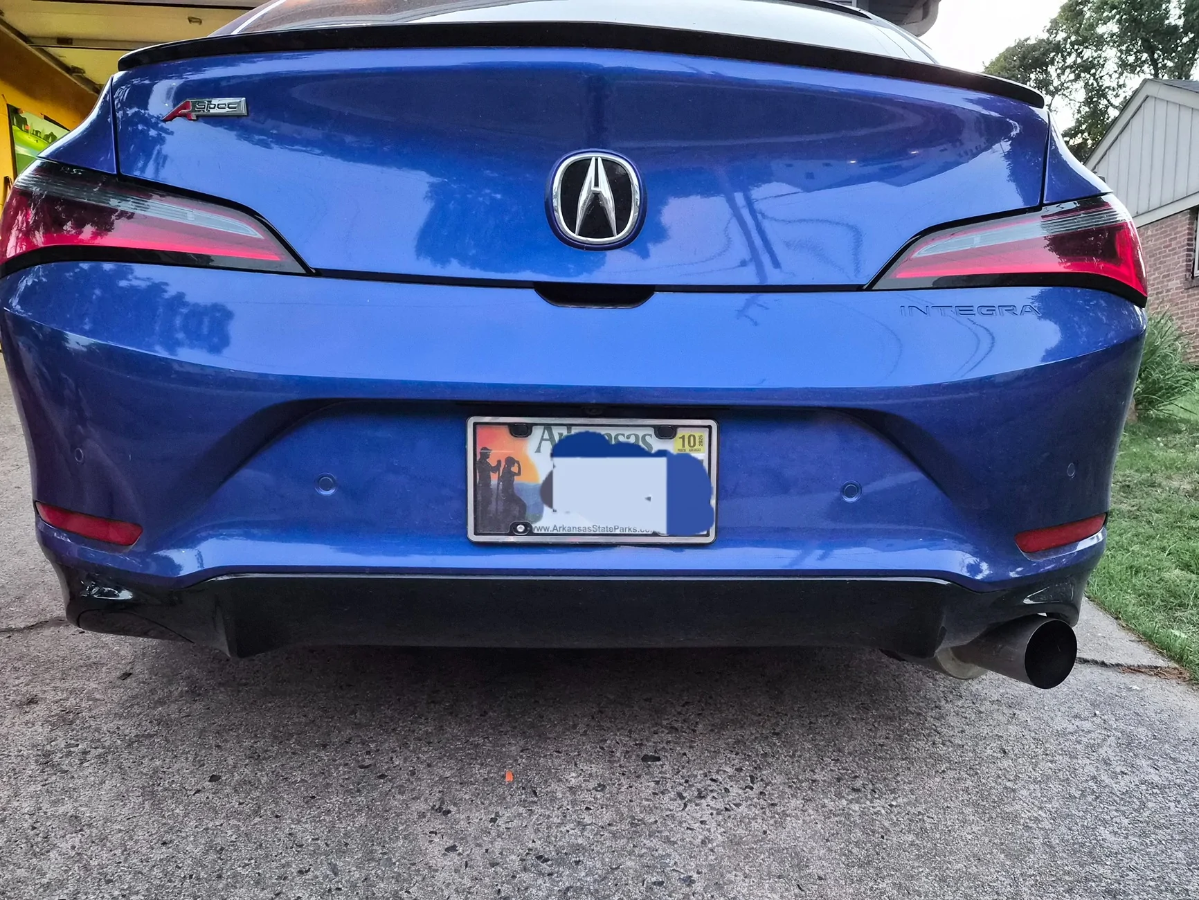

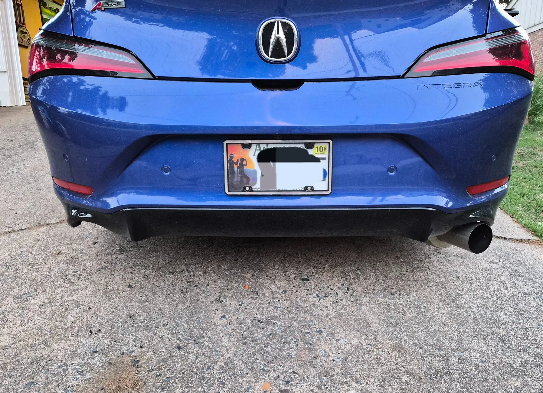

Artwork bodyshop rear cutout delete installed
Before
Acura Integra '25 Integra ASpec CVT Build 20260421_194450
After
Acura Integra '25 Integra ASpec CVT Build 20260421_195338
