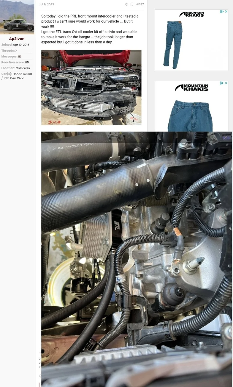

Very interesting! I found that part when searching maintenance guides but I couldn't find it in the bay. Also, it didn't look like what I assumed the fluid cooler would look like.
Since you mentioned that, was able to find a post on here where someone installed one:
https://www.integraforums.com/forum/threads/what-did-you-do-to-your-teggy-today-👨🏻‍🔧🧰🚿🛠.50286/post-834197
@Ap2Iven we've been over here trying to figure out the whole CVT cooler deal - would love to hear your experience with the install!
Revision: the stock "cooler" is actually more of a warmer. It is integrated with a motor that gets the cvt fluid to operating temp and keeps it there. Any added fluid cooler would have to sandwich between the stock plate and the transmission housing.

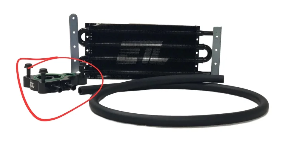

With the ETL cooler, what im curious about is why that plate/bracket needs to be mounted in front of the stock cooler? It looks like you could leave that out and connect the stock ports to the new fluid cooler?

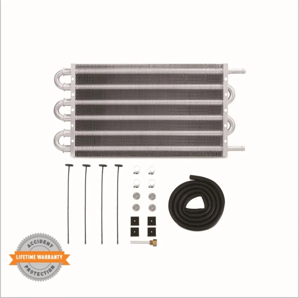

I'd like to go with a mishimoto cooler, but theirs doesn't include that plate/bracket.
ETL

Mishimoto

Gemini aid:
The adapter plate you saw in the ETL kit is a custom-machined part that is essential for:
Providing a mounting point for the new fluid lines.
Diverting the fluid from the stock heat exchanger to the new external cooler.
Ensuring a proper, leak-free seal with your car's specific transmission case.
If you were to buy a universal Mishimoto cooler (which is just the core and some basic hoses), you would also need to either find a company that sells a compatible adapter plate separately or have one custom-made.

Mishimoto
Gemini aid:
The ETL is for the older models it will not fit

Not me, that one was Ap2lven's post/photo. I should have the kit by Friday, but not sure when I'll get it on, have a decent amount of work queued up:
