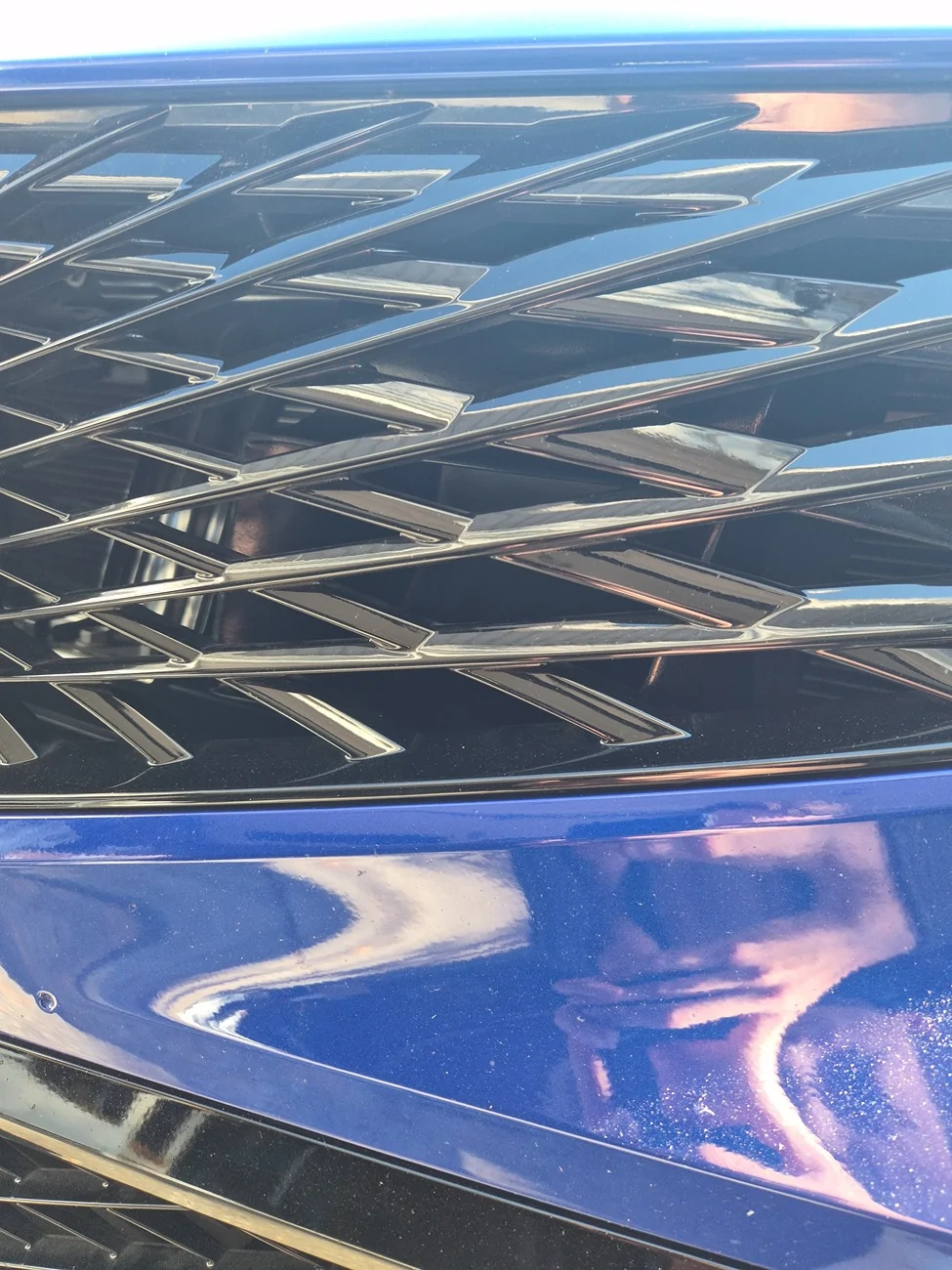

Put on the 27won air intake snorkel a week or two ago. Was kind of cursing the install - requires taking an angle grinder to a part and either cutting or deleting the radiator shroud (I went this route). I didnt read that step until I had the bumper off.
That said, once done it really wasn't that bad. I didnt take pics during install, but below shows the stealthy black snorkel behind the grill:

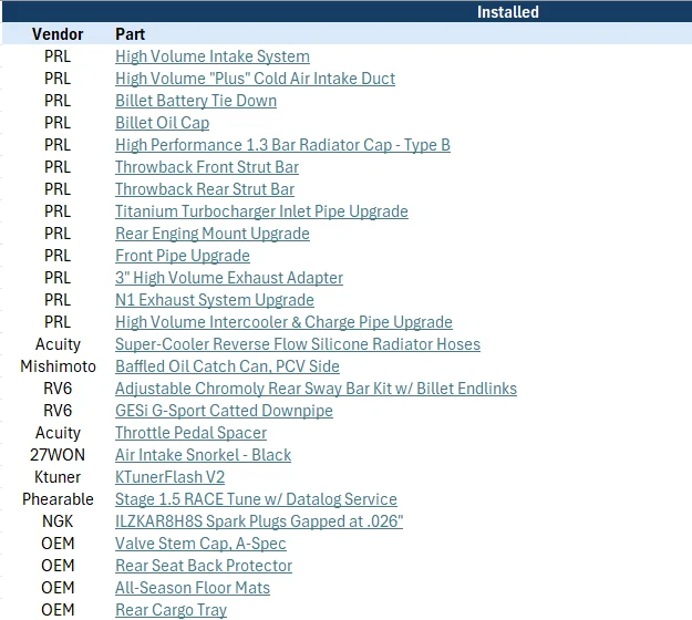

Recap:
Acura Integra '25 Integra ASpec CVT Build 1764813330997-q8

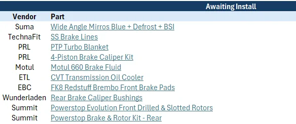

Awaiting Install:
Acura Integra '25 Integra ASpec CVT Build 1764813383970-rg
Need to decide if sticking with OEM CVT Fluid or switching to Ravenol or Amsoil.

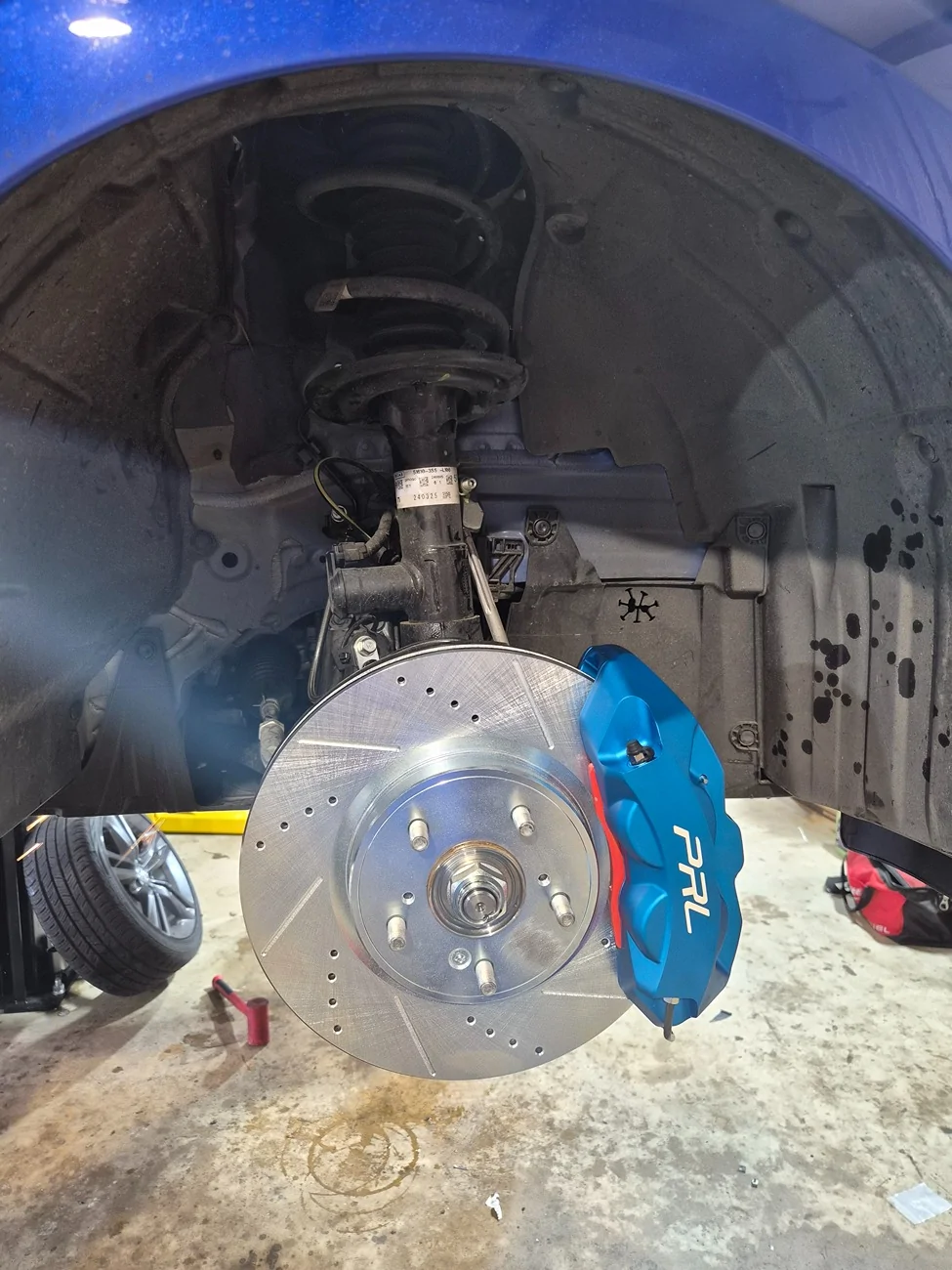

Brake upgrades going on today -
PRL Front Calipers w/ EBC Redstuff pads
Ceramic rear pads
Powerstop front & rear slotted & drilled rotors
TechnaFit SS front and rear brake lines
Wunderladen rear caliper bushings
Acura Integra '25 Integra ASpec CVT Build 20251223_102210
Note: on the Aspec, the PRL calipers do not clear the stock wheels. Luckily I had the PRL 20mm spacers on hand (had bought them then changed my mind on using them). Stock wheels have slots for lugs through the spacers, but they dont line up perfectly so we cut down the lugs a little. 20mm looks amazing! Will need to get a set for the rear.

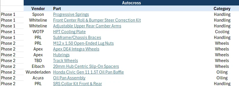

Updated Autocross list:
Acura Integra '25 Integra ASpec CVT Build 1767158192196-m
