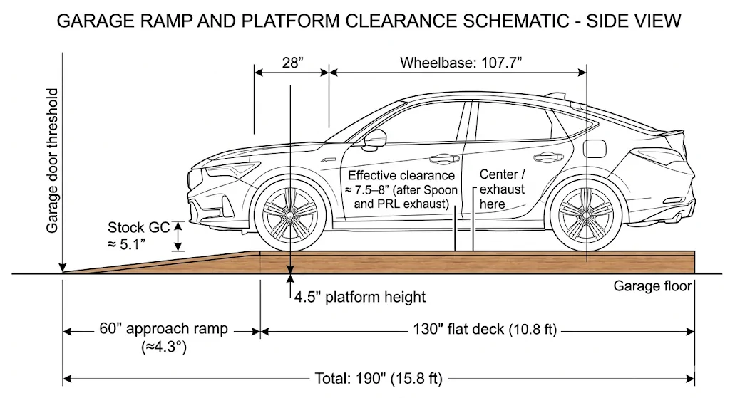

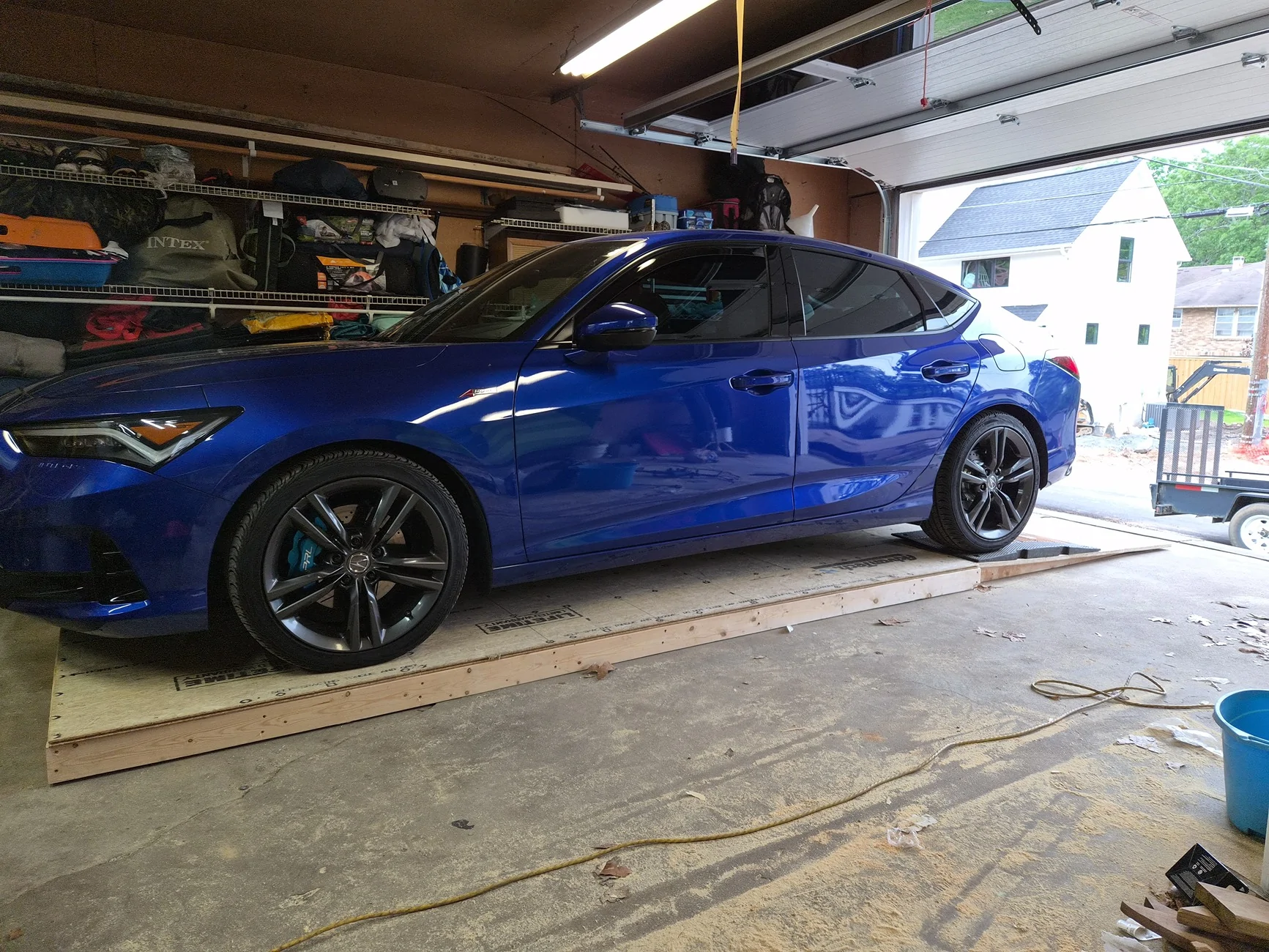

Finally made it so i could park in the garage today... old house/steep driveway problems.
Acura Integra '25 Integra ASpec CVT Build d77f0c98-7a2b-4f0a-9926-587815840c45
Platform gives 4.5in of height and is 76in wide x 130in long. Ramp portion is 76in wide by 60 inches long, ripped 2x4s corner to corner for the grade. Made 6 ramp spines inset 2.5in, 10.5in, and 28in from each side.
There was baaaarely a scrape with just the ramp & platform, but added those 2.5in humps I had previously bought and its perfect.
Besides being able to park in the garage, this should also let me add the spoon progressive springs (.8in drop). Can easily add more clearance if needed.
Acura Integra '25 Integra ASpec CVT Build IMG_20260426_101922
May add astro turf to the top or paint it to make it look nice Lol

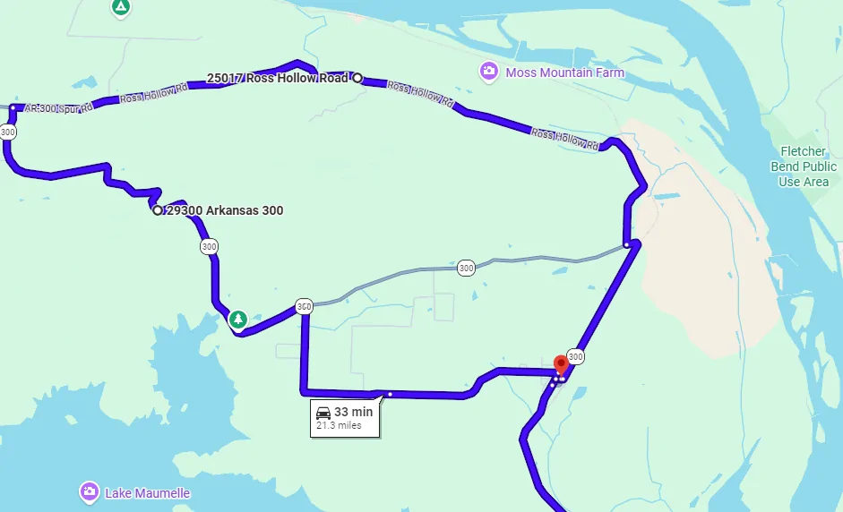

CVT / Heat Soak update:
Went on our local/mini tail of the dragon (Little Italy route) this past weekend to let a friend test out the car and see what the trans temp & ECT temps are up to under real stress. The car was in Sport + S Drive with manual mode for this.
Acura Integra '25 Integra ASpec CVT Build 1783526783067-8d
We really could only push the limits for short stretches - car was warmed up, and heat index was 103. After the first climb we had pushed trans temp to 212, but ECT was healthy at 195. The second climb (featuring 2 hairpin turns) pushed Trans Temp up to 232 and ECT up to 221...
That is admittedly... lame. From there we slowed down a bit to see how fast it cooled - ECT dropped back very quickly, but trans temp took about 10 mins or around 10 miles.
Takeaways - I need to get the Cooling Plate and better tires. I'm also considering ways that I could get better airflow to the transmission cooler. Simplest route might be adding venting to the wheel well liner, but more drastic could be to cut a window into the bumper for the cooler and add a grill for it.
Planning to add the cooling plate and then test again from there.

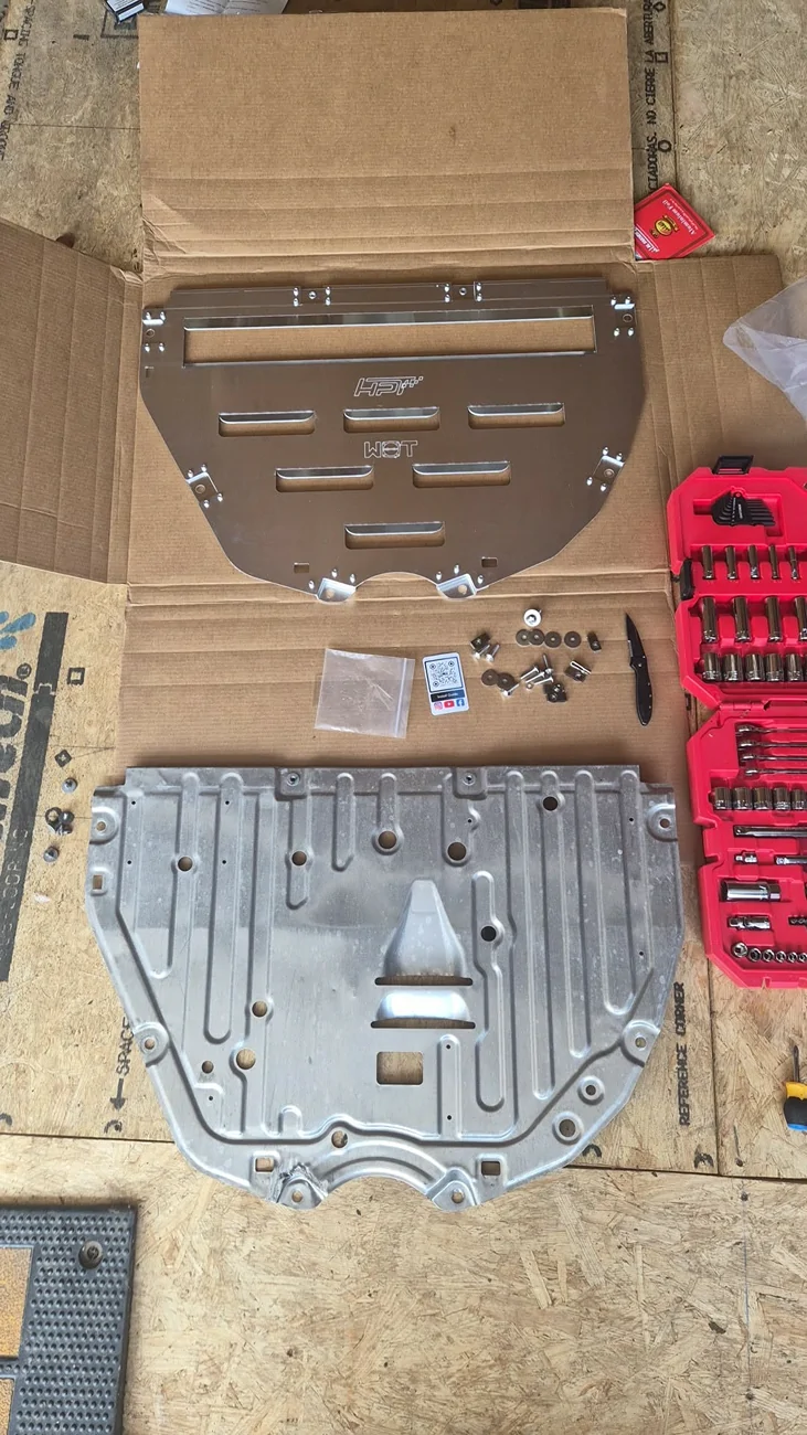

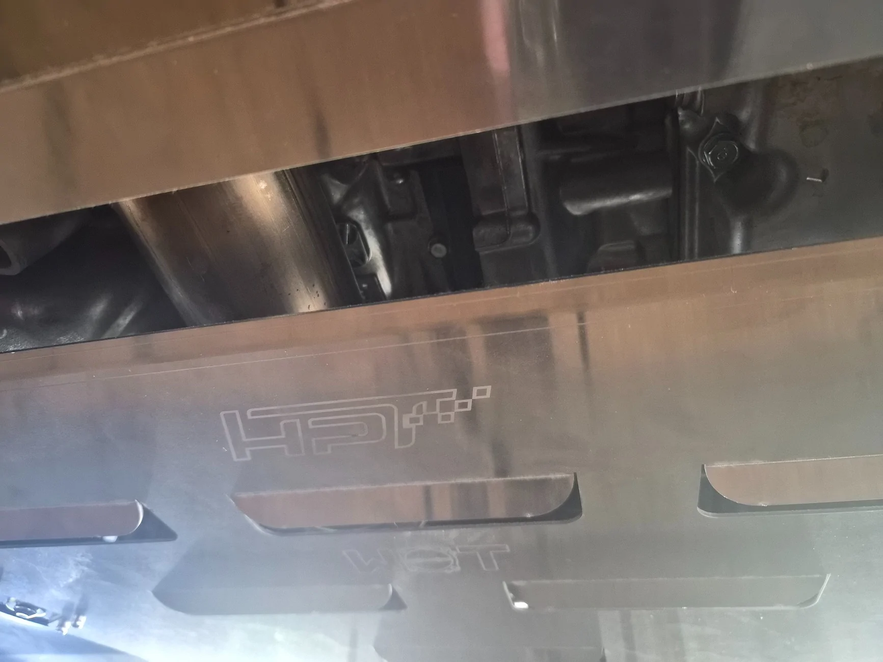

Wotp x hpt cooling plate installed & some concept pics for trans cooler airflow.
Acura Integra '25 Integra ASpec CVT Build Messenger_creation_3D2848BA-D4D7-4722-A901-39324FF3B178
Acura Integra '25 Integra ASpec CVT Build 20260717_132557
Acura Integra '25 Integra ASpec CVT Build 1784246058987
slowcountry
slowcountry
Dylan
May 19, 2025
244
122
Arkansas
After spending some time with it, the WOTP x HPT cooling plate keeps ECT about 9 degrees cooler on avg. Where 195 was the stable/avg ECT, it is now 186. But, I still have some heat issues in this crazy hot weather... mostly at sustained high freeway speeds & during spirited driving.

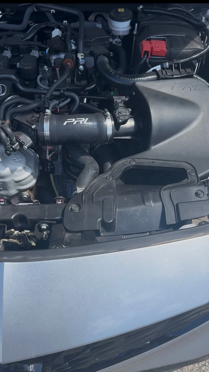

Just picked up my 2026 Integra A-Spec CVT and already tossed in the PRL HV CAI. I’m starting with an RMM and debating which one to go with, so recommendations are definitely welcome.
After that, I’m thinking rear sway bar → turbo inlet → whatever else makes sense. What would you guys recommend next for improving performance, handling, and overall driving feel without going crazy?

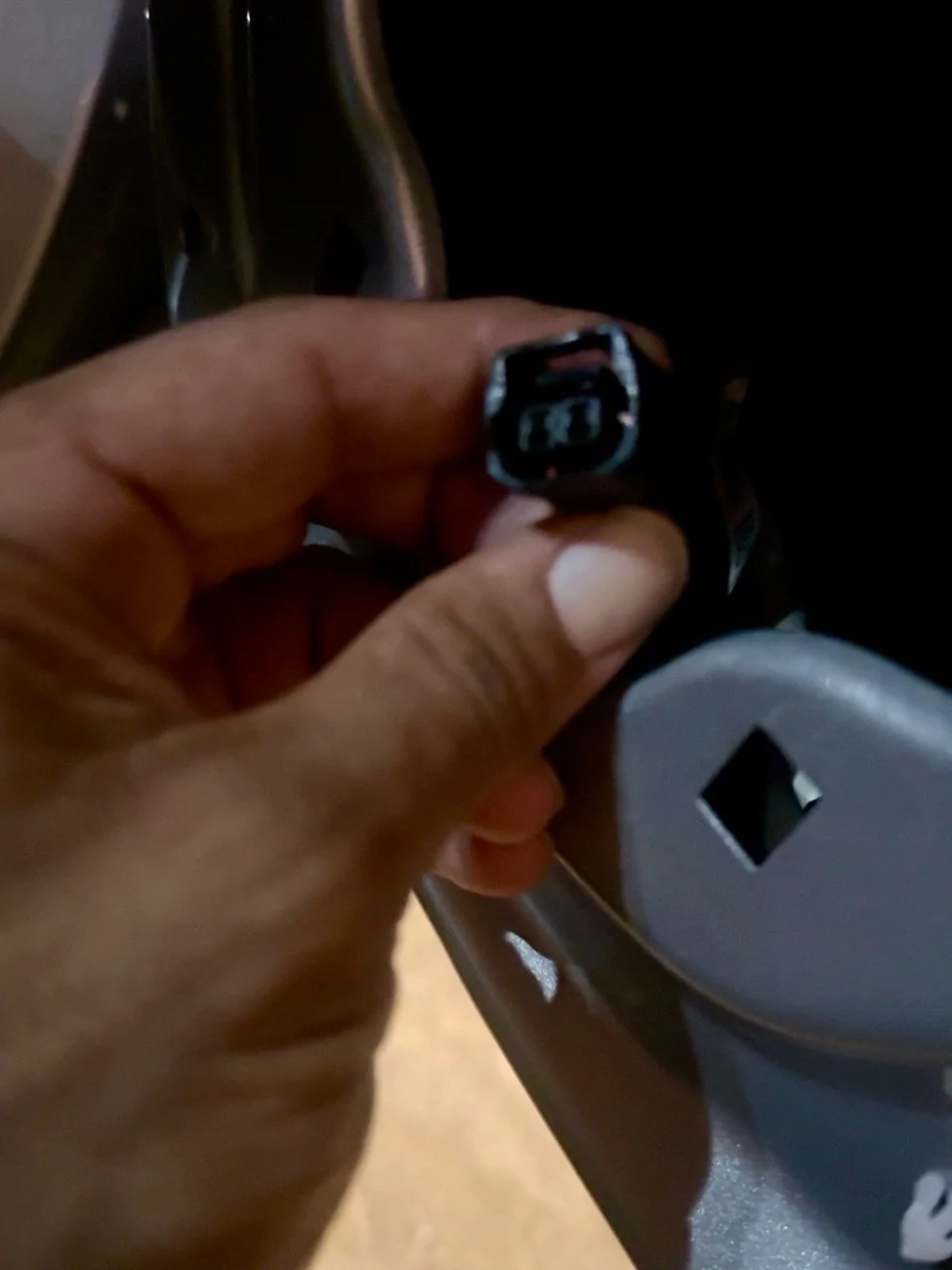

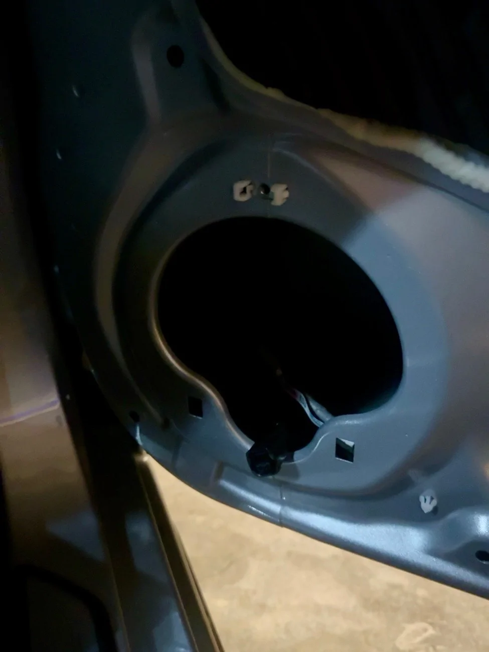

Also, I’m upgrading the speakers in the non-ELS system and could use some confirmation on the fitment. I’m planning on using the Metra 72-7801 wiring harness with the Metra 82-7805 speaker brackets. Is that the correct combination for the 2026 Integra? Best Buy hasn’t been able to give me a straight answer.

I’d do both the front and rear sway bar. The front is always ignored cuz the subframe needing to come down is a pain. But it’s worth it. Keep stock ride height, move to coilovers. But get ones that’ll let U keep stock ride height. Get to +8 caster. Shoot for -2 camber. Things will be UWU as fuck homie. UWU AS FUCK!
edit: exhaust

Agree on tires - stock suspension is limited by the stock tires. Just hard to justify replacing them before the stock tires wear out.
Front and rear tower struts were one of my favorite mods for handling. The FSB is pretty thick stock, but it's heavy. I just went with the RSB so far. The turn in and cornering is extremely tight.
You'll have a full intake side upgrade with turbo inlet added.. next is exhaust line, intercooler/charge pipes, tuning, and heat management.
