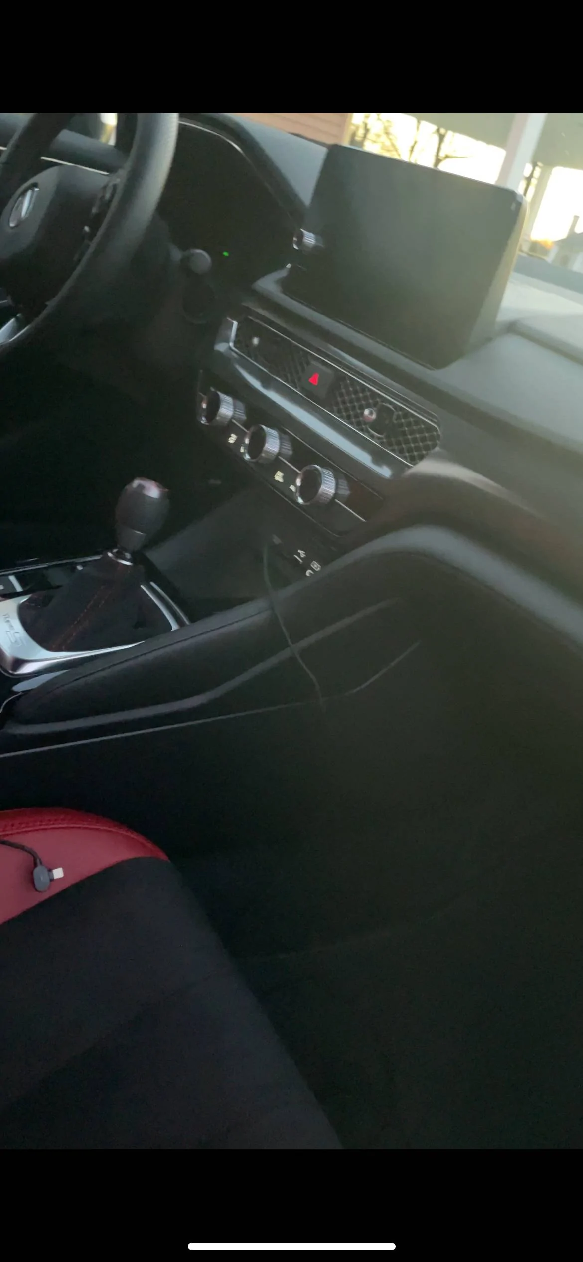

Second issue I have is that the under the dashboard there is a piece of leather that matches the color combination of your interior and it goes all the way to the shifter. With my red interior that one piece is black. I've looked online and have not seen one other model to have that piece not be red. It's not by any means bad looking just not what I paid for. You're probably thinking "How did you not notice that when purchasing the car"... and the truth is I did, but I was told the red interiors replace that piece with black because it would be "To much red". This problem is not a big deal, and is very fixable and I'm it seems like it's covered by warranty.
- Has anyone seen that piece be the wrong color
- Is there anything else I should be on the lookout for after running into these types of issues?

Yea that screech is real bad, i don't know anyone on here that has it that bad. The black trim is just hilarious, the explanation from the dealer is even more hilarious. That's suppose to match your interior colour, which is red.

The trim piece being black is a mistake. either the dealer switched it because of a flaw or some damage, or the factory screwed up when assembling the car.

The interior issue is a factory defect or dealer shenanigans. I'm not sure what I'd do in that case... I'm not sure what's involved in swapping that piece out, but you could try taking it to another dealer because these guys are clearly idiots. Or just lean into it because it's "special"? It's not hurting anything, some could argue it could possibly affect resale down the line but I don't even think that's a concern personally. If you like it, roll with it.

I actually wish my Ebony Interior came with that boomerang shaped piece in red by accident.

Lol. I switched the red trim out for black. There's an Aspec rolling around somewhere with 4 seats and red trim.
it's this. i had a '15 Si which would fairly regularly get rocks in the wheels, they eventually fall out (either from your driving or from being ground down small enough to fall out :p)
as for the trim, the dealership is bullshitting you, or completely clueless. honestly the more ive dealt with dealerships, the more i'm surprised at how clueless the people they hire are (while still wanting to charge $100+ an hour for labor lol)
