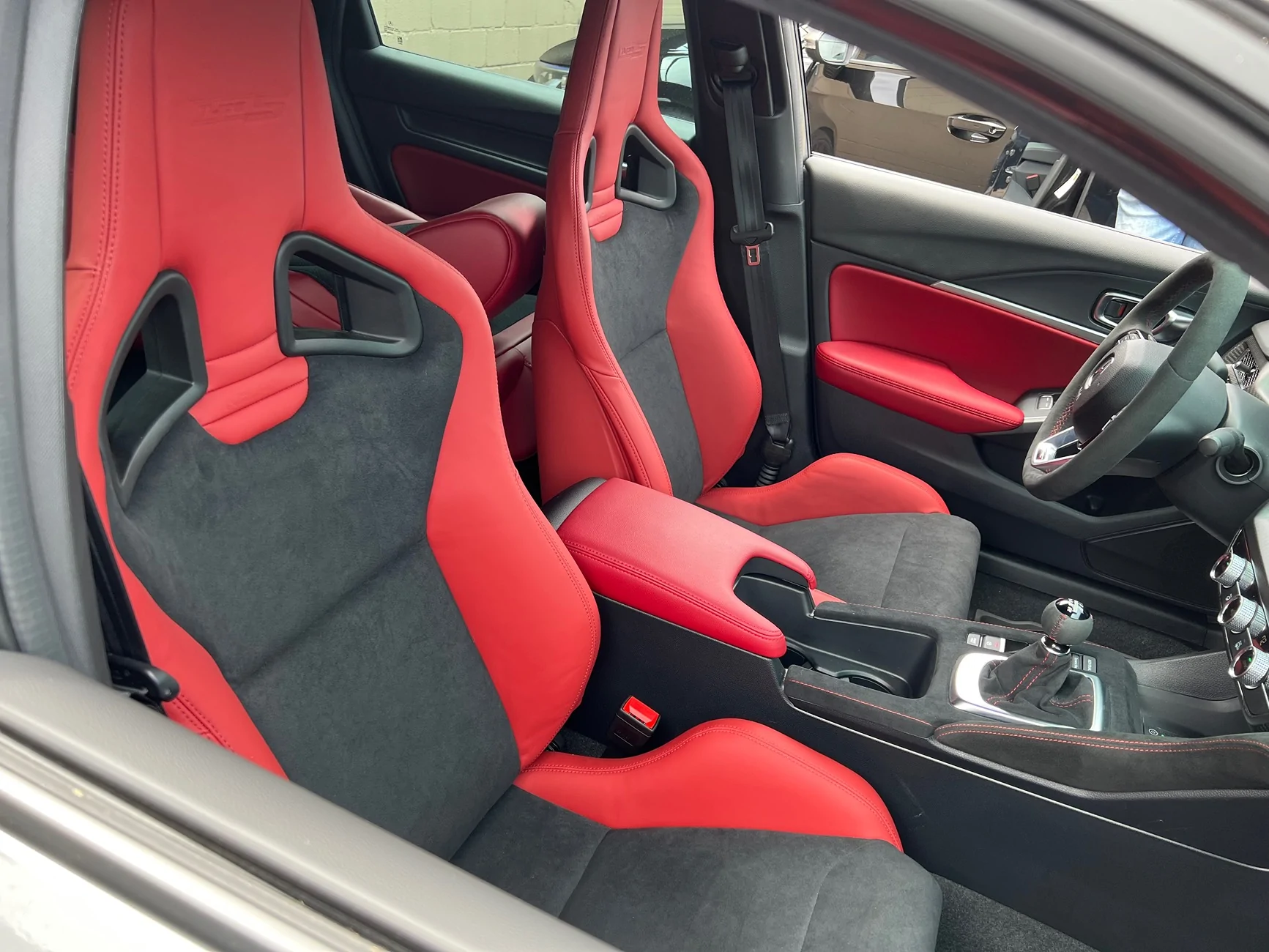

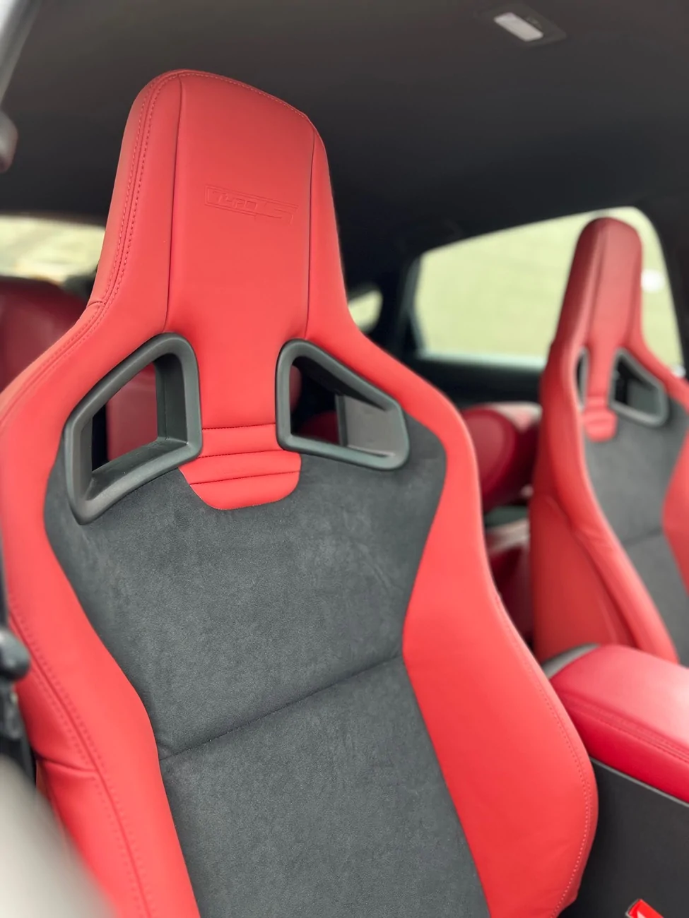

Found them on a local FL5/DE5 group.
Install was done by a professional. It requires a couple harnesses and reprogramming of sensors and airbags.
Would've loved to get a leather/Alcantara version of these in the DE5.
Congrats! Another member of the β€œseat crew”
I would’ve preferred lawn chairs to the OEM seats.

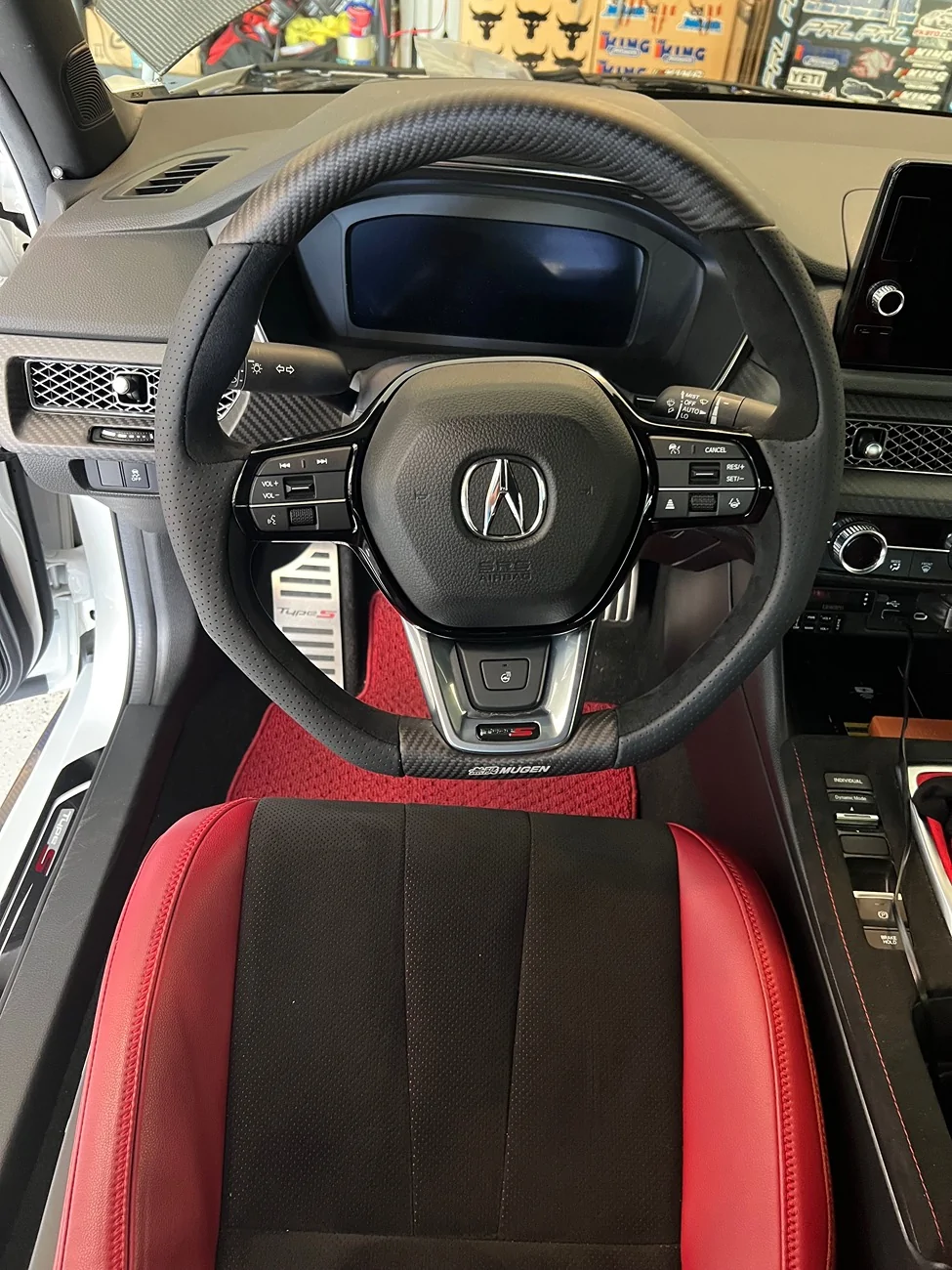

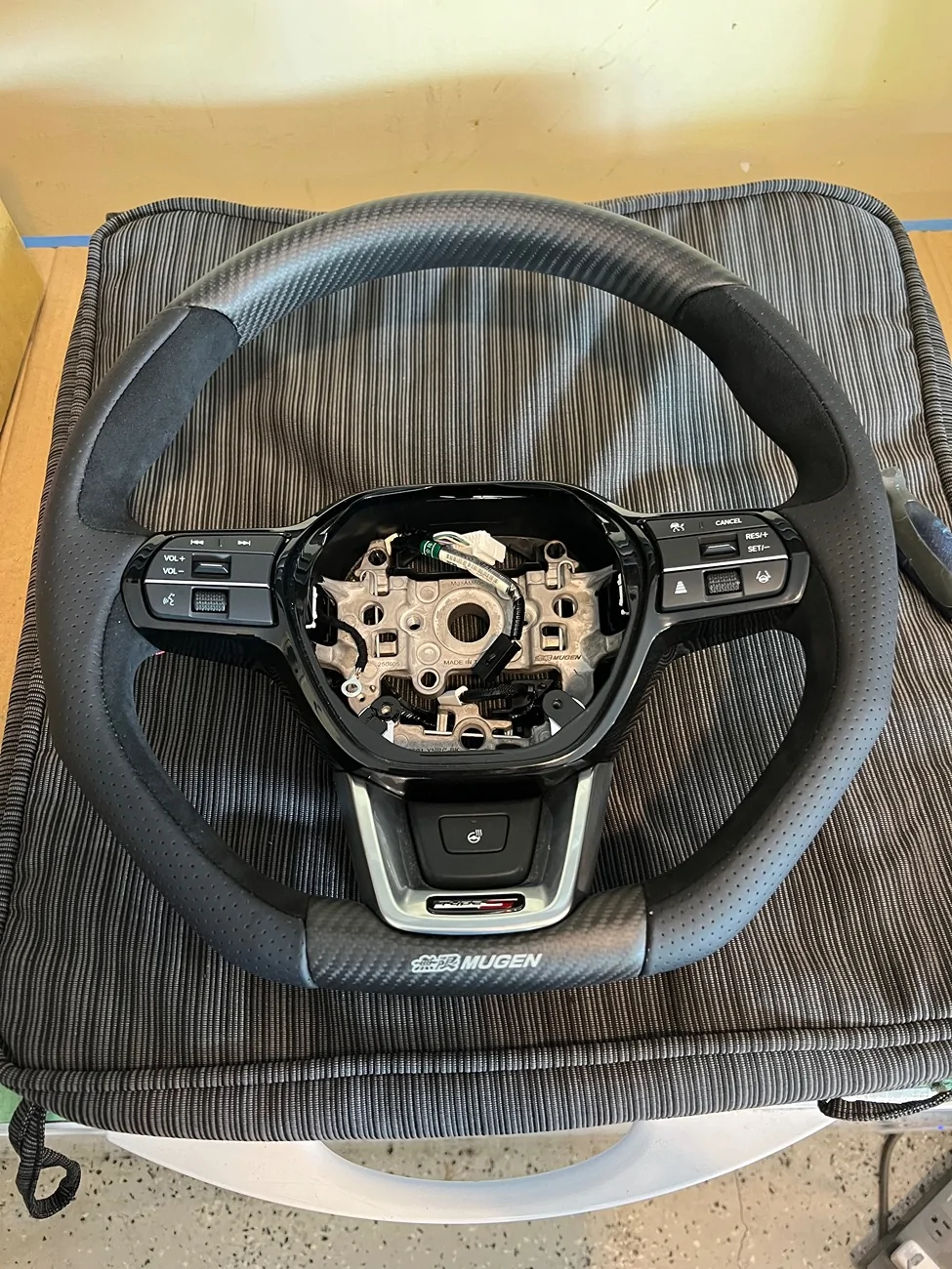

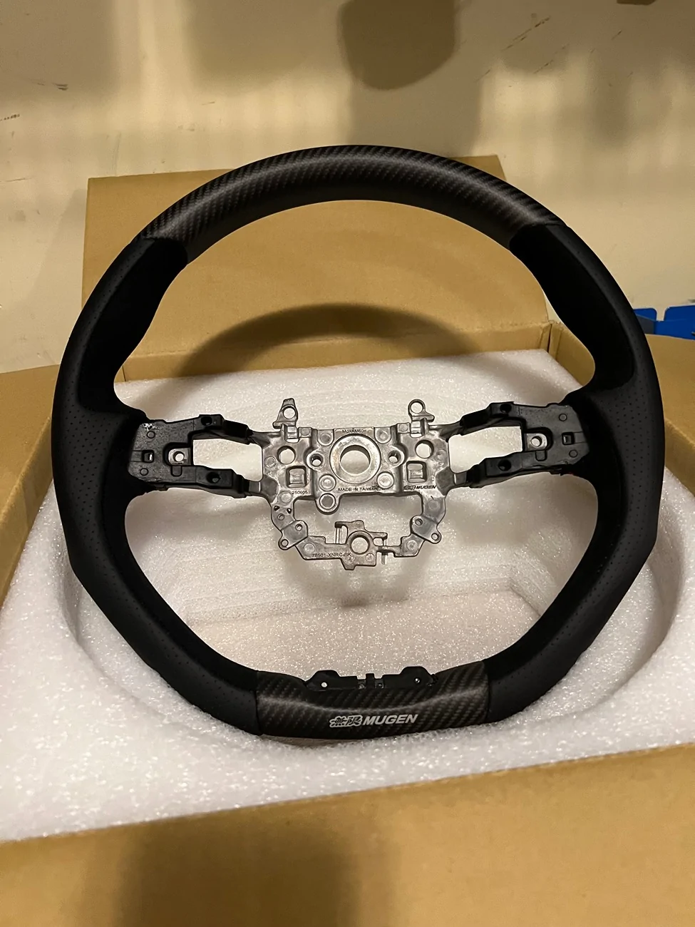

Likely just re using the factory trim and switch. Canadian owners have heated steering standard.

The Mugen steering wheel had a heated option?
No heated option for Mugen wheel. Had to move all the trim over from OEM wheel.
Some steering wheels like the Carismo have heated option, but not Mugen.

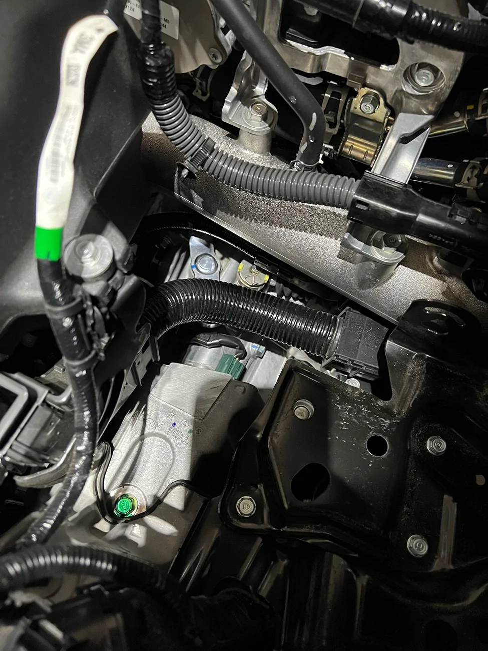

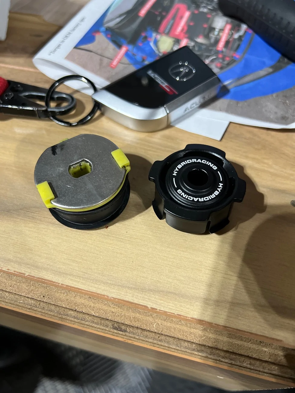

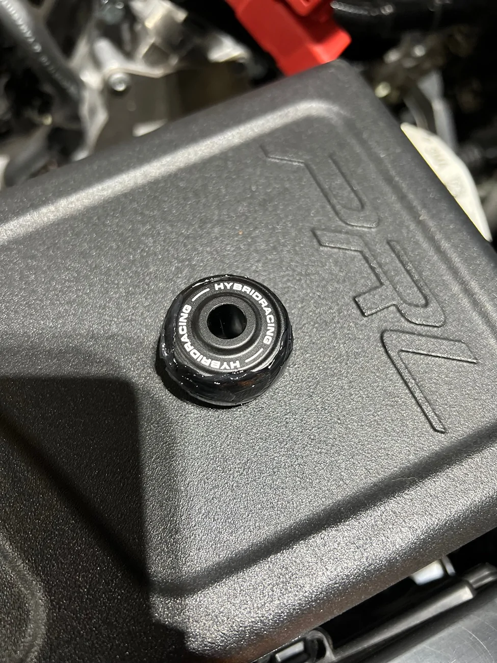

Installed the Hybrid Racing shifter cable bushings. The smaller bushing is an absolute bitch to snap into place. You need the hands of a six year old girl in order to fit in the area.
The result is nice. I have them paired with a Hybrid Racing shifter and the engagement into each gear is very mechanical, positive and fluid.
Tomorrow I’ll be installing the detent springs and the shifter base bushings. Should clean up any of the β€œslop” shifter wiggle while in gear.

The Mugen wheel is really nice. How exactly does steering wheel heating function work in this car?
Did you mean in general? We have to get the accessory heated wheel which has the heating elements built in but it also comes with the button, harnesses, fuse, and rear shroud to accomodate the button.
