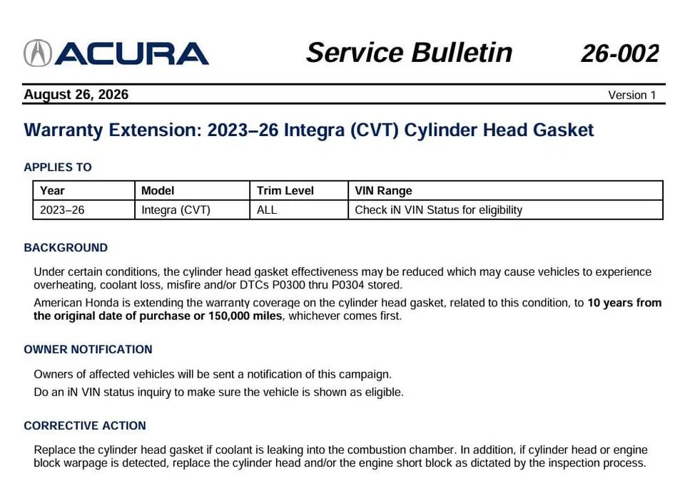

Warranty Extension 1.5t Head Gasket Issue

I see what this says, but doesn’t this only apply to the 1.5t motors?

So far, yes. People on reddit have mentioned that the 2.0 has this issues as well, but the number of cases is smaller. It took honda years to admit it about the v6 and the 1.5t. I wouldn't hold my breath on them mentioning the 2.0 until the numbers pile up.

This will be the first warranty that I intentionally void on the car. Damn the torpedoes. I noted the VC gasket on mine was leaking over the weekend, so I'm going ahead and putting head studs in it next oil change. If the HG goes anytime after that once it's tuned to match the supporting bolt-ons the car already has, so be it, that's on me. Pulling the head and/or entire engine/trans assembly in these cars is stupid easy anyway. I'm actively searching for a used engine to build into something spicy as it is.

Very happy to see this bulletin as I learned about the HG issue the weekend after I bought the car. lol

So does anyone know how soon this HG problem tends to show up, or what those certain conditions may be?

Me got a bad feeling, happen to check my coolant bottle and it was at the min mark. :( Just asked the service manager a few weeks ago if they have seen any 1.5Ts with HG and he said no only 2.0 RDXs. I could be the highest mileage Integra they know at 72k, although I doubt it. Just went through the same thing with my '17 CRV had it done privately with Unity studs and factory gasket. Acura will only give us factory studs torqued to the factory spec, which obviously guaranty another failure down the road. Not sure, love the car and have Acura Care, but these 1.5Ts - keeping them long term is a ticking time bomb, still scratching my head.....
