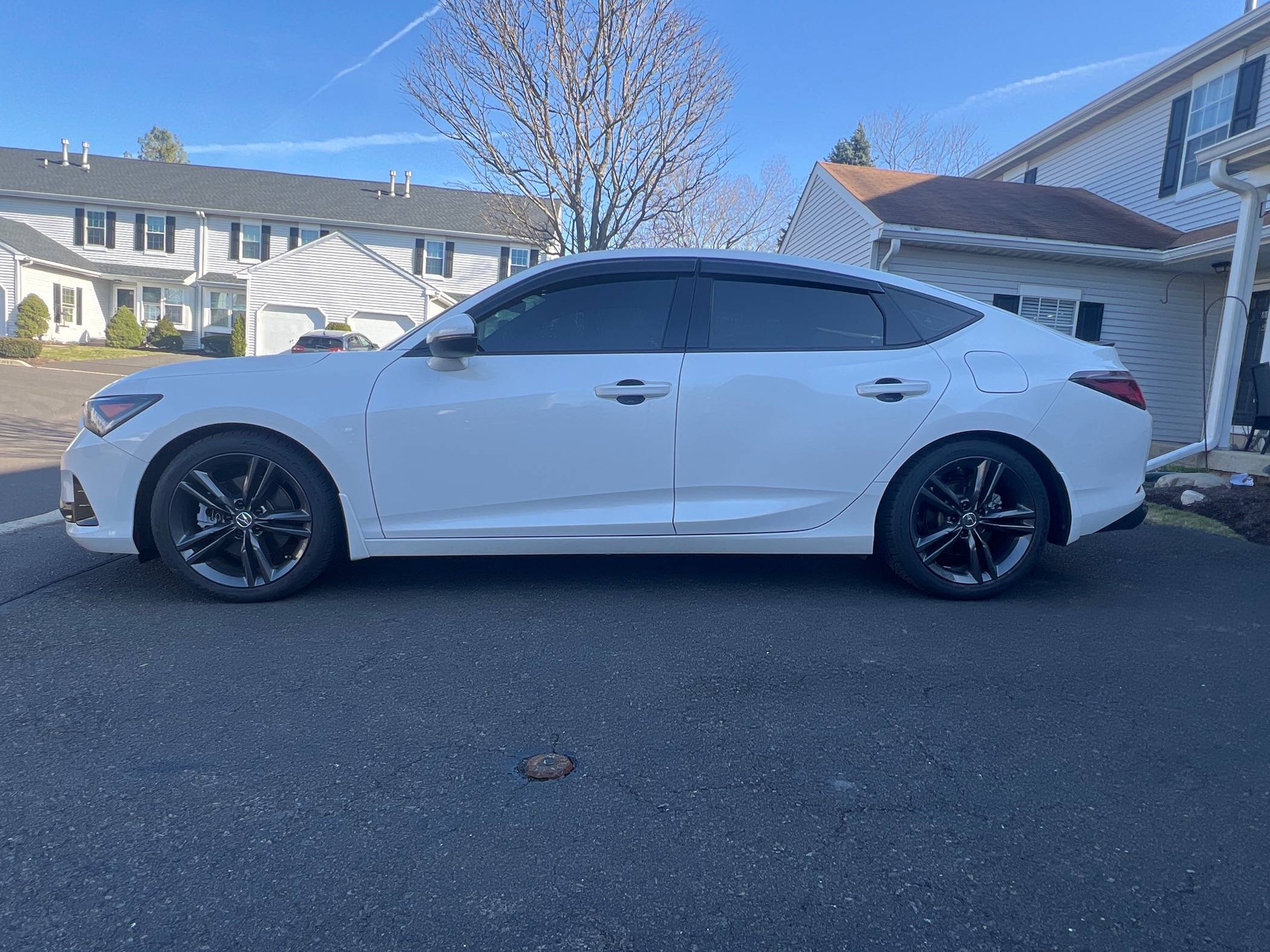

this is her with the 245/40s on. Little chunky but I like it like that. I think it’ll look even sweeter once the spacers are on.
The stock ASpec wheels have little pockets that, once a spacer is installed, the original studs that come through the spacer contact these pockets slightly (when going with 20mm; with 25mm, they don’t stick through. 15mm would be too deep and don’t work) in the search function of this forum, search “20mm spacers” and look at early posts in the ASpec integra section. @JC-RH was one of the first to do it back in summer of 22 and outlines all of the issues involved, etc. he actually ran 20mm in the front and 25mm in the rear while lowered and it looked sick (before he went full coilover and 3 piece wheels)

Sean is right. I ran a 20mm/25mm setup initially. If I could do it again, I’ll probably do 20/20 even with the wheel stud issues described in my posts. The 25mm in the rear tends to slightly rub if you have camber arms (to reduce negative camber) and go for an aggressive drop and/or tend to carry a lot of cargo. I guess it all comes down to preference and what matters to you. Just be aware of the pros and cons of either decision.
