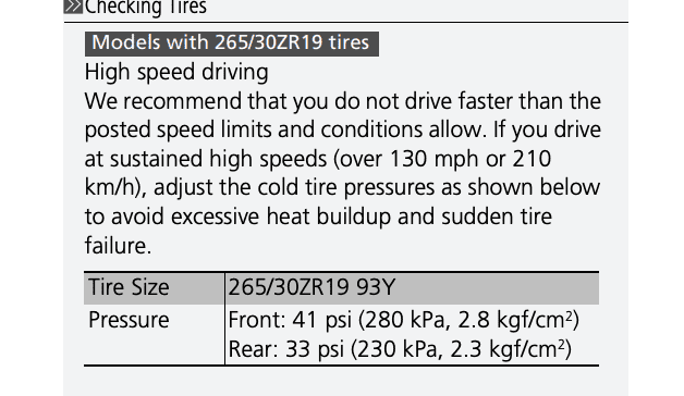

41psi/33psi, page 662 of the manual. The say it's for sustained speeds 130mph+
I thought I remembered some CTR track guys that came back with a slight increase in the rear & having a better experience with that but Iā€™d have to look to see if thatā€™s accurate. I do remember bumping up to 41 now that you mention it tho!

I think track use is another animal all together. You have to factor in road surface type and it's quality, the number of turns versus high speed zones and also your driving style.
I was just repeating verbatim the manual details. I'm familiar with it because maybe I don't quite drive 130mph regularly, but let's just say I consider the speed limit a "suggestion" when I have the highways mostly to myself on a nice day.

Iā€™m right there with ya. šŸ˜„ This year will be my first for tracking experience, but like yesterday for example - itā€™s 80-120mph nearly the whole 30 minutes there & back again with about a 30 minute break in between.
