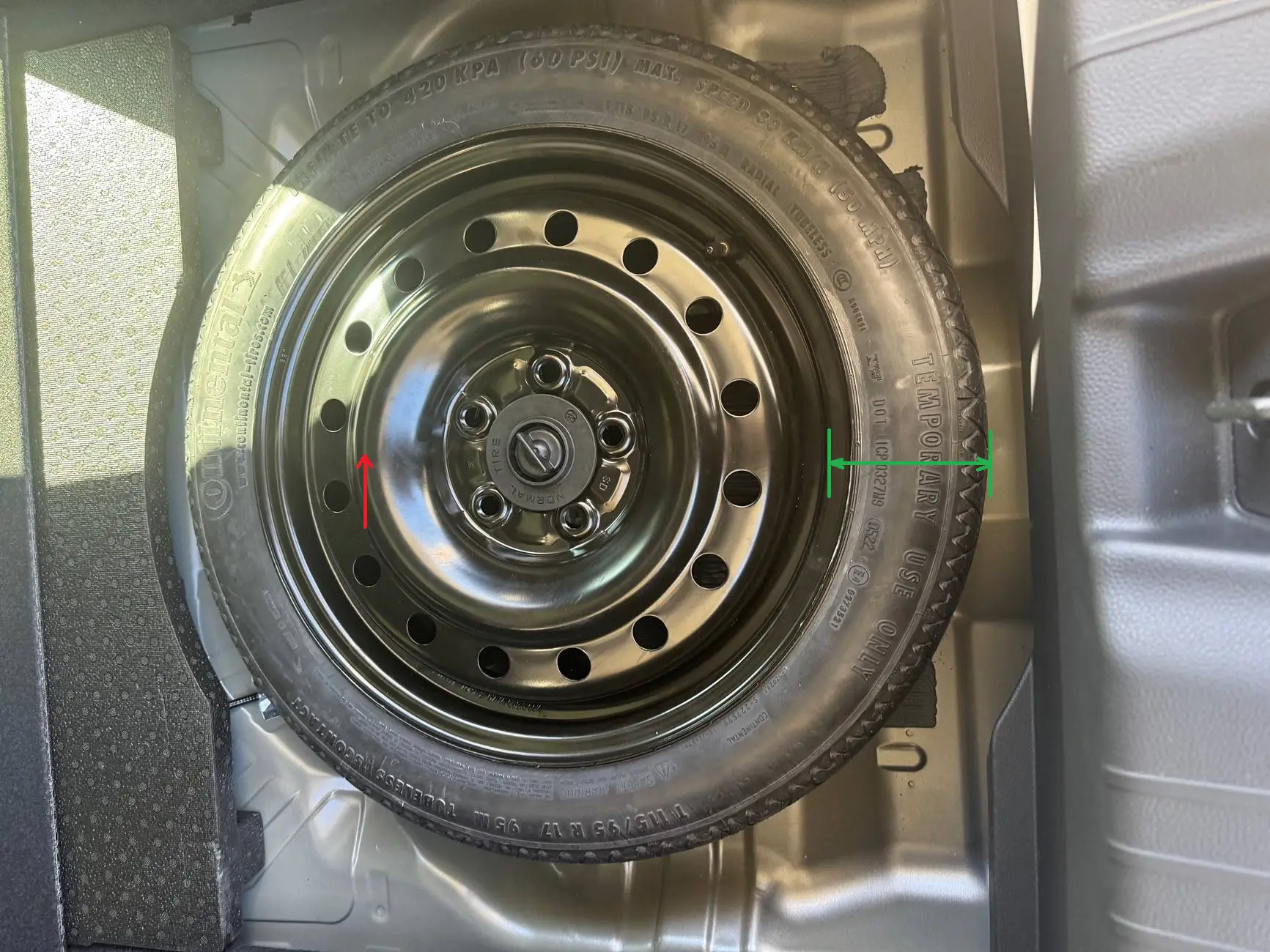

the design of the rim makes it protrude the inch
Are you saying it is not the tire causing it to go up by an inch, but the inner part of the rim, not the outer part of the rim? For example, where the red arrow is pointing and not in the green area?

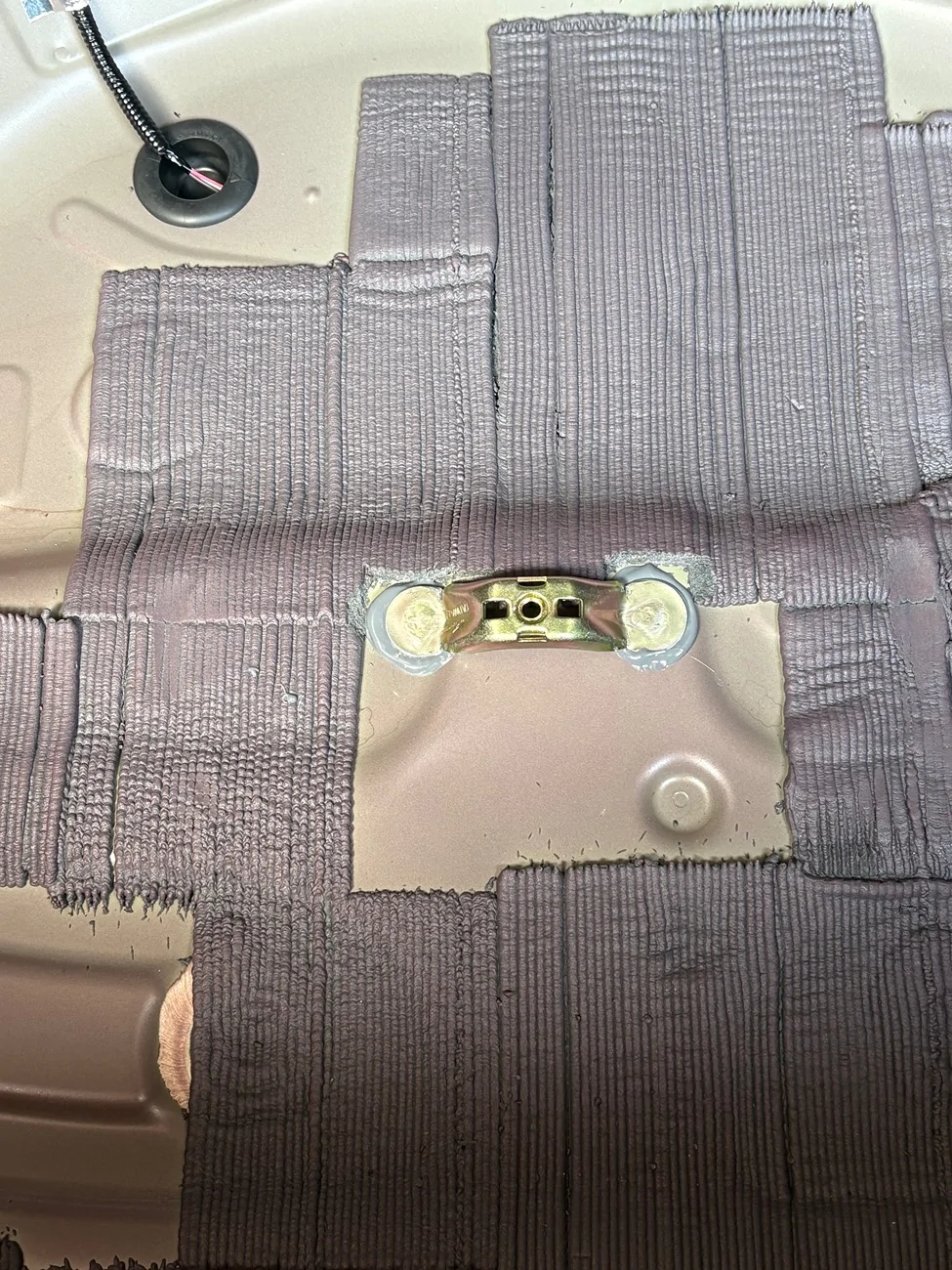

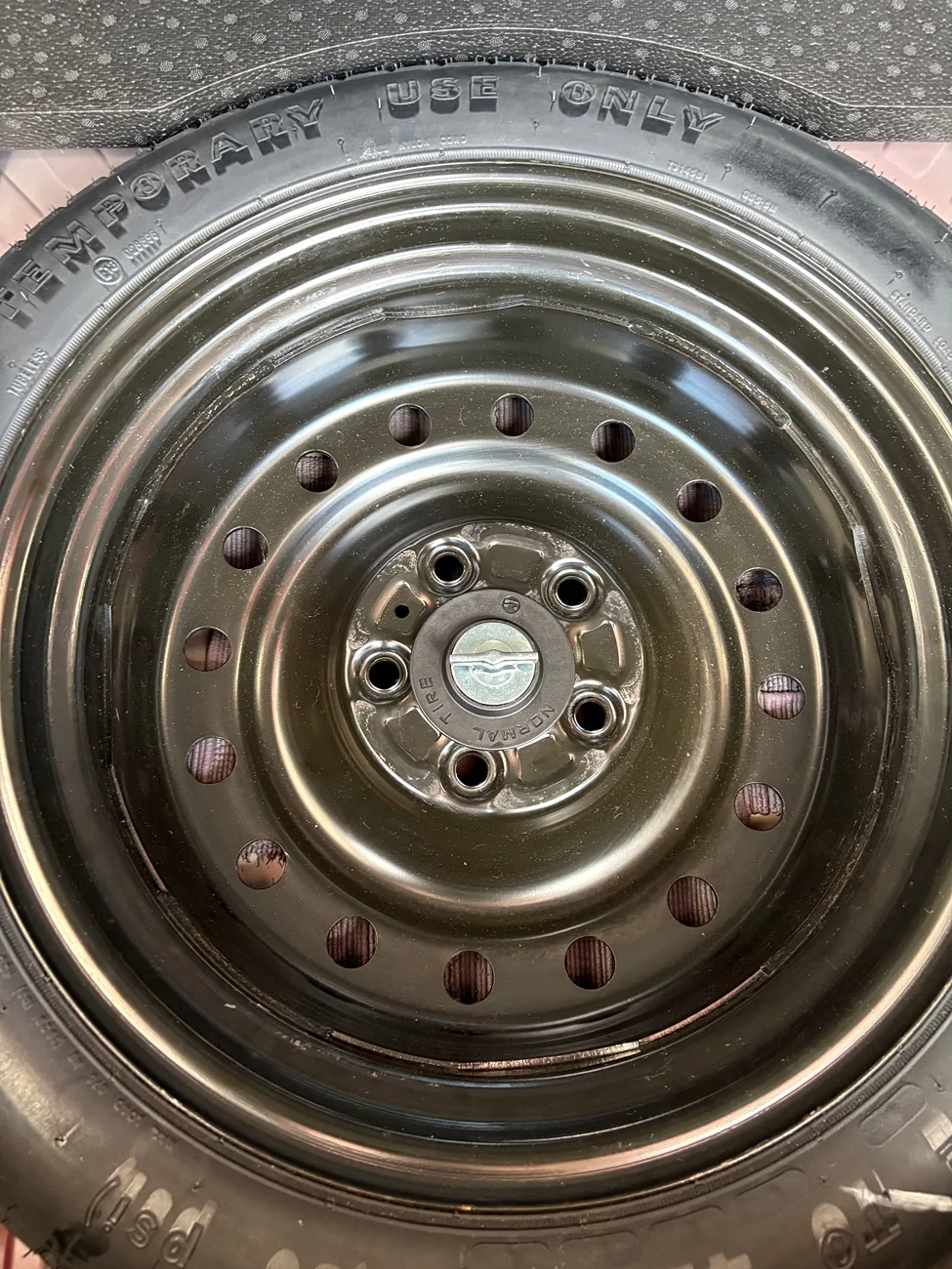

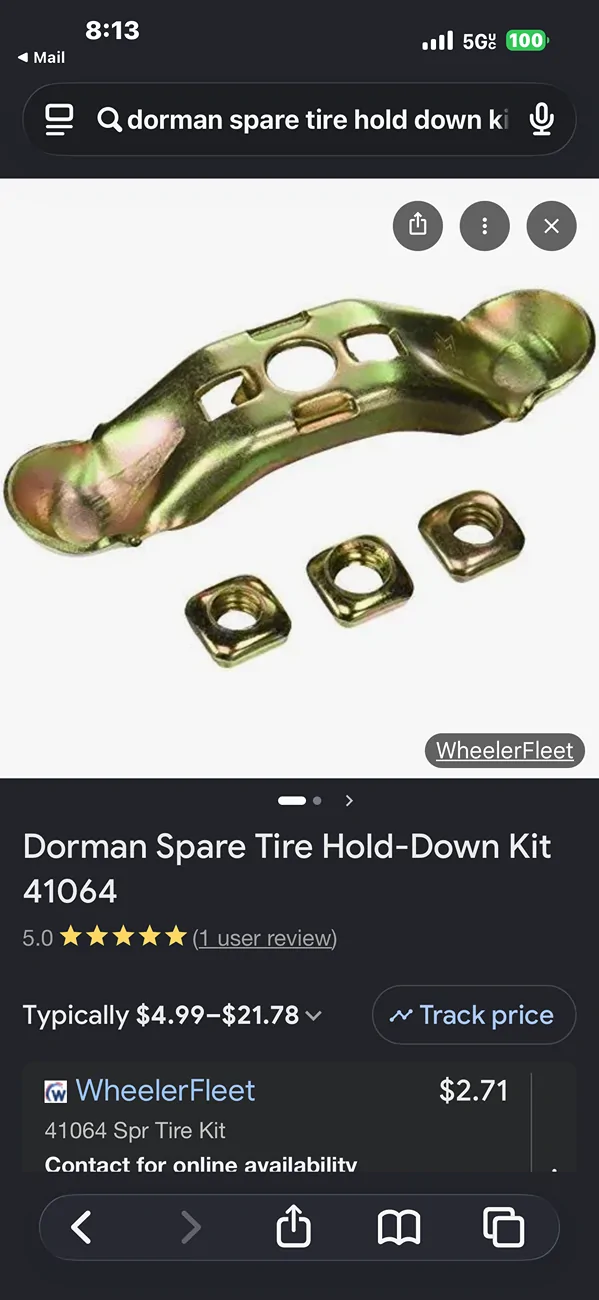

PhatFreshPrince
Mar 24, 2026
57
63
Georgia
2026 Acura Integra Type S
Nice!
So this sits flush, with the floor not protruding?
Can you share pics with the floor please?
Can you give use the part numbers to the bolts and screws you used? It looks like a clean set up.

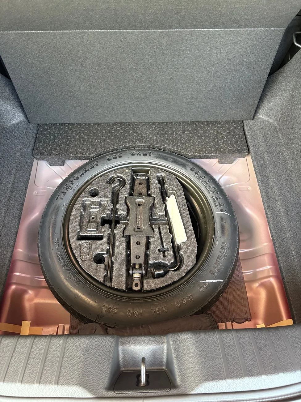

PhatFreshPrince
Mar 24, 2026
57
63
Georgia

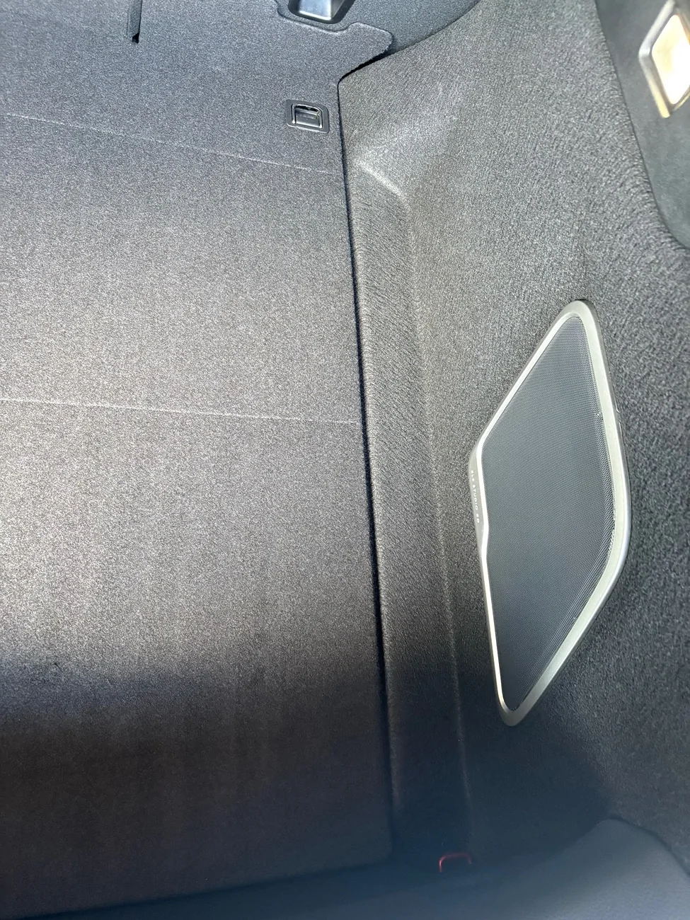

My underfoor set up
Very nice! It looks flush. Can you let us know your wheel part number and tire size? Also, do you know the part number for the foam insert for the jack and hardware?
