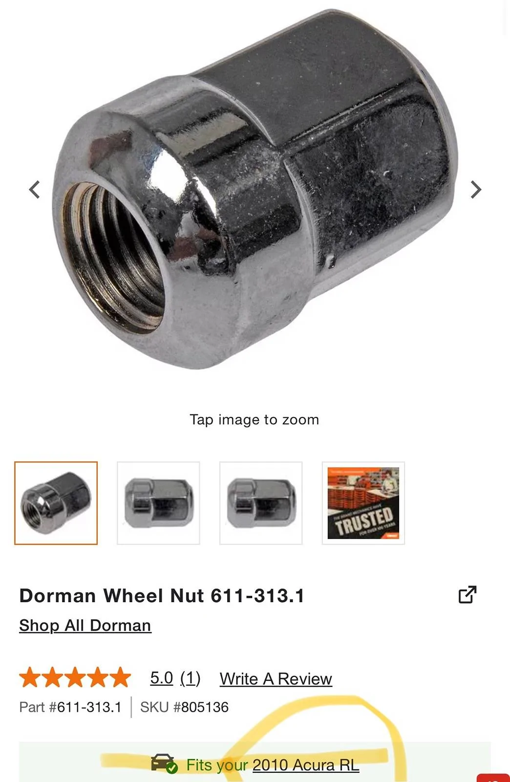

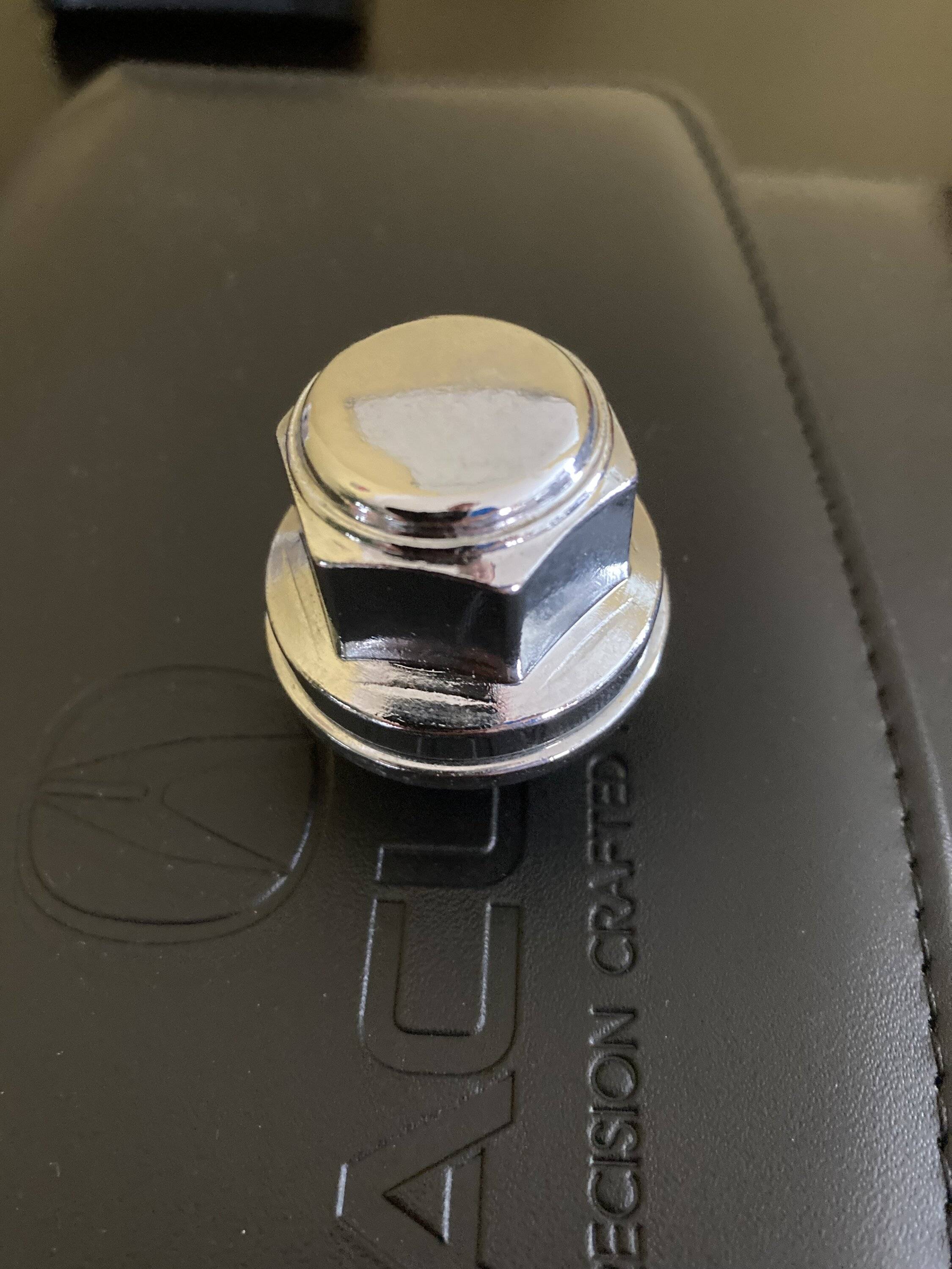

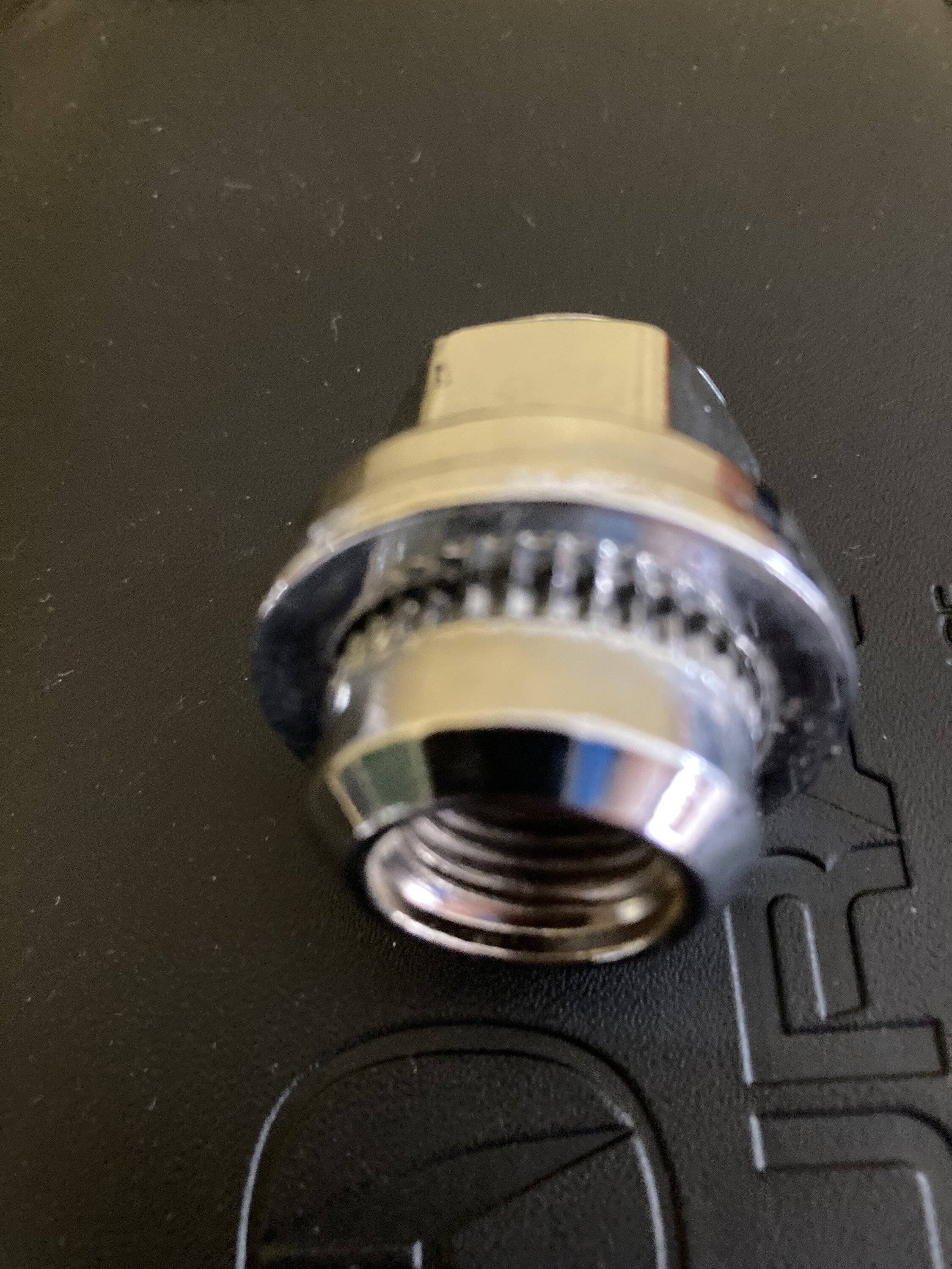

For anyone going the Acura RL spare tire route, you'll also have to buy 5 new lugs for the spare.
The Acura RL did not use ball seat lug nuts, but rather flat seat lugs with a washer. See pictures. OE ITS lug nuts won't hold the wheel correctly in place for driving!
I'll update my older posts with this info.

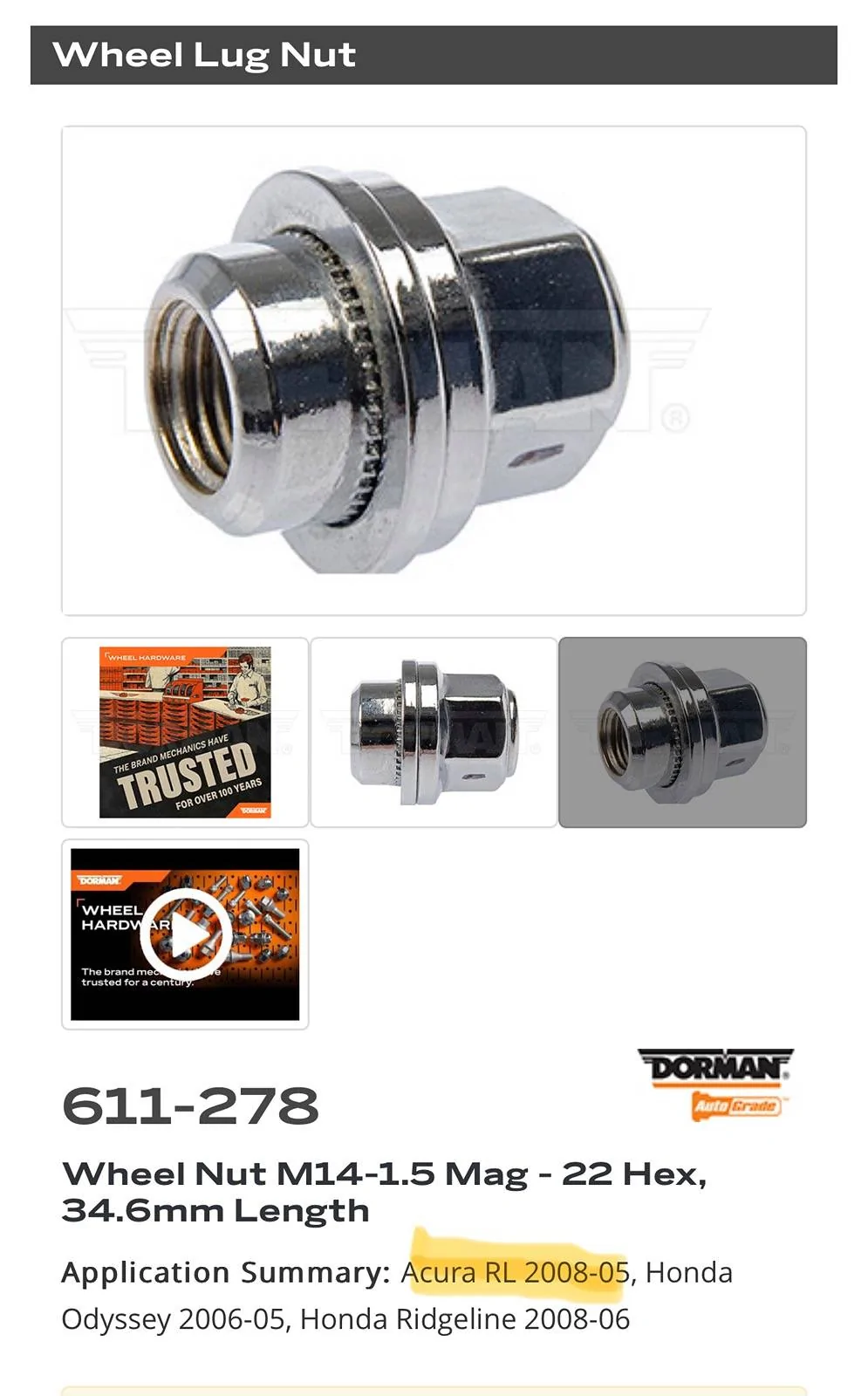

Does the year of the spare tire matter for the lug nuts? Auto Zone shows one version and another member here posted another model number for Dorman lug nuts which match this.
Acura Integra Spare Tire Kit IMG_7916
Acura Integra Spare Tire Kit IMG_7917
641
402
Thought they were all the same. I needed the second pic you posted. If you have the spare in hand, it is easy to know what you need!
